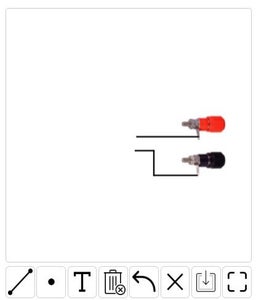

Step 2: Place the Input Terminals
Drag a 2-pole terminal block (labelled AC IN or Adapter) to the left side of the canvas.
Add a small text label: 12 VAC IN. This represents your adapter/transformer secondary or adapter jack.

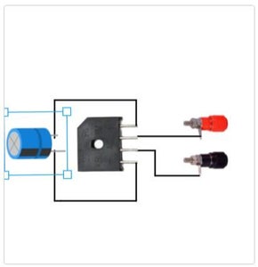

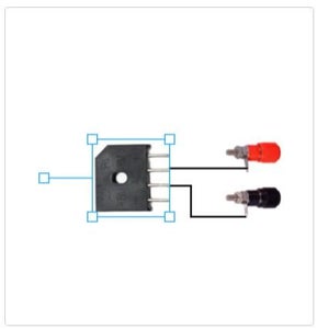

Step 3: Add a Bridge Rectifier
Drag a bridge rectifier component or four diodes arranged as a bridge. If the builder offers a packaged bridge symbol, use it.
Connect the two AC input terminals to the bridge AC pins (~ and ~).
Label the bridge DC outputs + and –.
Step 4: Add the Smoothing Capacitor
Place an electrolytic capacitor between + and – on the DC side.
Set the value to 2200 µF – 4700 µF, 25 V in the component properties. Ensure polarity is correct: the capacitor negative goes to –.

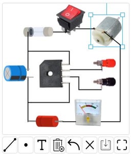

Step 7: Add the Motor and Return Path
Connect the motor positive terminal to the ammeter output; connect the motor negative to the – rail.
Optionally add a flyback diode across a DC motor (if you plan to drive via a transistor or H-bridge later). For a brushed DC motor powered by a rectified DC with smoothing capacitor, the capacitor and the motor form the normal load — a diode across the motor is still good practice for inductive spikes if the motor is switched rapidly.

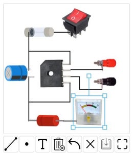

Step 8: Abel and Document Component Values
Use the builder’s text labels to record component types and values (e.g., Bridge: KBPC5010, C1: 4700µF / 25V, R1: 10Ω / 5W, Fuse: 3A).
Add a note about expected no-load and stall current for the motor. This helps choose the fuse and ammeter range.
Step 9: Export Diagram
Use the tool’s export function to save a PNG/SVG of the schematic. Save step images for your Instructables post.
