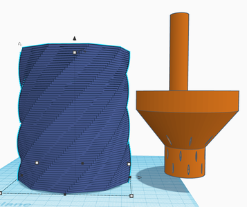

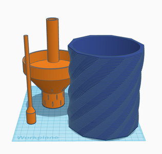

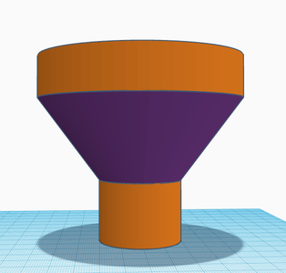

  • Start with a cylinder as shown at the top of the model in pic 1 - I made mine 20mm tall and the diameter 100mm wide as my planter has 101mm internal diameter. Making the insert 1mm smaller than the inside of your pot helps ensure it'll slot inside easily.
  • Next, add a cone. You know your printer and what it can handle so adjust the cone until the walls are at an angle you are able to print without supports as that will save you a lot of time and material. Mine used 50 base radius and 20 top radius then I flipped it over and popped it under the cylinder from the last step.
  • Then add the last cylinder and adjust to fit the cone. Mine has a diameter of 40mm and is 30mm tall.
  • At this point, have a good look at the model and make sure you're happy with the overall size of everything and make any final adjustments, my insert is 85mm tall in total which is around 2/3 of the height of my planter. Once happy, group all 3 shapes.

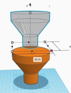

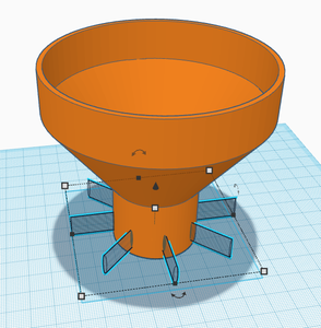

  • Make a duplicate of the insert and scale it down by holding shift and resizing the whole object, I gave my duplicate a 96mm diameter. Once happy, make it a hole. (pic 2)

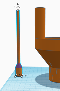

  • Use the align tool to centre the hole and bring it level with the top of your insert (pic 3 - the greyed dots are the ones you want to click)

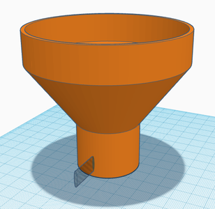

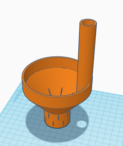

  • Group the hole and your insert - you should now have something that looks like a sealed off funnel (pic 4)

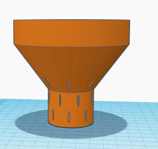

  • Add a cylindrical hole to the workplane. Resize it so it's the size of the hole you want. I made mine 2mm wide and 10mm tall and raised it 3mm above the workplane. Align it with the centre of your insert and stretch the cylinder until it's long enough to pass all the way through your insert (See first pic)
  • Duplicate the hole, then rotate it 45 degrees (Tinkercad will help by snapping to 45 for you). If you then press duplicate twice more, you should find that Tinkercad (clever as it is) automatically rotates the duplicates for you so you have something that looks like the 2nd picture!
  • Group all of the holes you just created then make a duplicate of the grouped holes
  • Raise this duplicate up to make a second layer of holes above the first and rotate it 22.5 degrees (again Tinkercad should help you by snapping to this rotation) Then repeat this step to make a 3rd layer of holes (3rd pic)
  • Group everything together (4th pic)

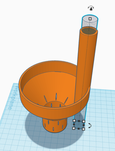

  • Add a cylinder (mine's 20mm in diameter) and raise it up until the top point is a little higher than the top of your pot. My pot is 130mm high so I made my cylinder top out at 145mm so it pokes out the top of the pot a little to make sure soil doesn't drop in there. Align the cylinder so it is centred and sits at the edge of your insert (pic 1)

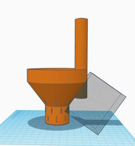

  • Next add a cube hole,align it to the centre of the cylinder and then rotate it until it lines up with the angle of your insert (pic 1) Now group that hole with your cylinder so it no longer sticks out of the bottom of your insert!
  • Add a cylindrical hole and resize it so it's a little smaller than the previous one, I made mine 16mm in diameter. Align it with your previous cylinder (pic 2)
  • Now group everything together and it should look something like pic 3.

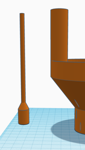

This is totally optional but a neat and easy to make little extra - it's essentially a stick with a hollow bottom which means it floats so, as the water level gets lower, it'll sink too helping you to identify when your plant's reservoir is in need of topping up!
  • Add a cylinder to your workplane. It should be the same height as the whole insert and narrow enough to easily fit inside the refill tube without blocking it (pic 1)
  • Next, add another cylinder and a cone and arrange them as shown - I made mine 14mm in diameter so I can remove it without having to take the whole insert out (pic 2)

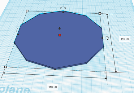

  • First add your shape - I used a 10 sided polygon (pic 1) but you can use pretty much anything so try a few out and see what you like best! Scale it up to the size you want your pot to be- mine is 110mm in diameter and 2mm tall.
  • Now duplicate your shape, raise it up 2mm and rotate it (pic 2) - I rotated by 2 degrees for this design but, again play around with it and experiment - this is the part of the whole make where you can really put a bit of imagination into it!
