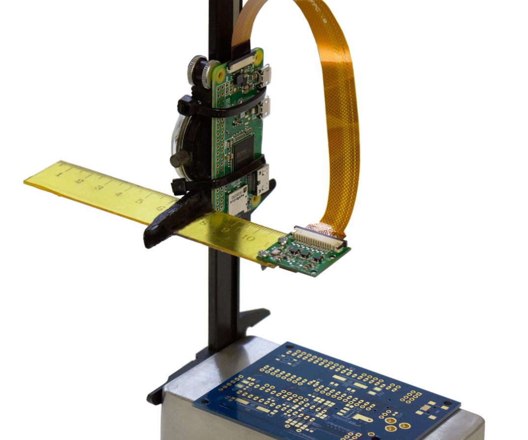

Step 4: Configuring the Camera
The biggest difference between a regular Raspberry Pi board and the Compute Module is that in the case of the later apart from just enabling the camera by using raspi-config, you also need a custom device tree file.
You can find more information regarding the configuration of the Compute Module for use with a camera in the documentation. But in general, the camera connector among the others also features 4 control pins, which need to be connected to 4 GPIO pins on the Compute Module, and it is up to you to decide which ones while designing your custom board.
In my case, while designing the board I choose CD1_SDA to go to GPIO28, CD1_SCL to GPIO29, CAM1_IO1 to GPIO30 and CAM1_IO0 to GPIO31. I choose these particular GPIO pins as I wanted to have a 40 pin GPIO header on my board, that also maintains compatibility with the GPIO connector of the regular Raspberry Pi boards. And for that reason I had to make sure that the GPIO pins I’m using for the camera don’t also appear in GPIO header.
So, unless you decide to make changes on the wiring of the camera connector, you need a /boot/dt-blob.bin that tells your Pi to configure GPIO28-31 as described above. And in order to generate a dt-blob.bin, which is a binary file, you need a dt-blob.dts to compile. To make things easy I’m going to provide my own dt-blob.dts for you to use which you can then adapt to your needs if you have to.
To compile the device tree file use the device tree compiler as follows,
dtc -I dts -O dtb -o dt-blob.bin dt-blob.dts
I'm not sure why but the above should result to quite a few warnings, but as long as the dt-blob.bin has been generated successfully everything should be fine. Now, move the dt-blob.bin you just generated to /boot by executing,
sudo mv dt-blob.bin /boot/dt-blob.bin
The above will probably give you the following warning,
mv: failed to preserve ownership for '/boot/dt-blob.bin': Operation not permitted
This is just mv complaining that it can’t preserve the file ownership as /boot is a FAT partition which is to be expected. You may have noticed that /boot/dt-blob.bin doesn’t exist by default, this is because the Pi uses a built in device tree instead. Adding your own inside /boot though overrides the built in one and allows you to configure the function of its pin the way you like. You can find more about the device tree in the documentation.
After that is done you need to enable the camera,
sudo raspi-config
Go to Interfacing Options, select Camera, choose YES, OK and Finish. In case you’re asked if you want to reboot decline. Now, shutdown your Pi and remove the power.
After the power has been removed from the IO board, using 4 female to female jumper wires connect the pins for GPIO28 to CD1_SDA, GPIO29 to CD1_SCL, GPIO30 to CAM1_IO1 and GPIO31 to CAM1_IO0. Finally, attach your camera module to the CAM1 connector using the camera adapter board or a camera cable designed for the Raspberry Pi Zero and apply power.
If everything worked as expected after the Pi boots you should be able to utilize the camera. To try to take a picture after connecting to your Pi via SSH run,
If the command finishes with no errors and a test.jpeg gets created it means that it worked. If you want to have a look at the picture you just took you can connect to your Pi via SFTP and trasfer it to your computer.
sftp pi@<ip-address-of-pi> sftp> get test.jpeg sftp> exit
