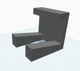

Step 4: Initial Prototype
We used the free, web based design program, TinkerCAD.com to create a simple prototype. The goal was to design something quickly that had the rough dimensions needed. Once printed we would be able to make adjustments and add finishing touches. Sticking to mostly cube shapes we were able to develop the initial prototype. This was 3D printed with minimal settings to reduce time and material cost. Only 1 wall with 3 top and bottom layers were used The infill was set to 10%. An orientation was chosen were not supports were needed. We will talk more about these decisions in a later step with the final prototype but for now these will do.
Step 5: Testing and Redesign
The first print finished with out issue. The fit behind the shelf was great. The space left to slide the T square into the holder was too tight. The slight angle given to the slope of the arms made less room than planned. Hanging the entire holder lower will be the major change to the design. There is a concern about getting too low and bumping into the pencils below. No prototype is properly tested until it is broken so a strength test was done. Pulling down on the arms until failure was completely necessary. The next 3D printed version will have stronger settings but we did find out where the weak point was and how a downward force impacts the design. This gained knowledge guided design choices and decisions in the next steps.
