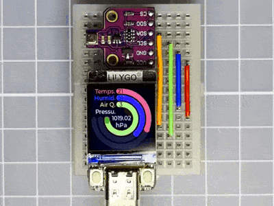

This project use a BME680 sensor readings as an example. BME680 can sense temperature, humidity, air pressure and air quality. So the main screen shows 4 realtime sensor values and corresponding arc value bars. Temperature, humidity and air quality vary over time, so 3 more screens show individual chart to present values over time.
