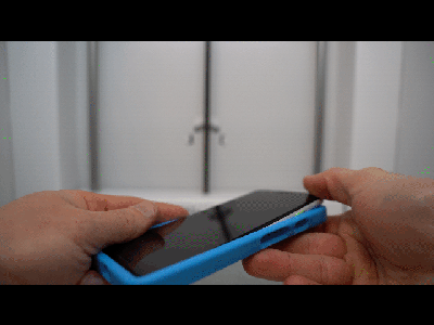

Create your own custom 3D Printable Phone Case in Autodesk Fusion 360. Follow along with my step-by-step tutorial on YouTube, or follow the detailed guidance in the Instructable below.
Phone Cases are often injection molded with TPU. The good news is that TPU is both an affordable and capable material to 3D print on hobbyist-level FFF (FDM) 3D Printers.
TPU can be a bit tricky to print if you're used to printing in PLA. PLA and ABS will not work well for 3D printing a phone case, unless your simply printing it for fun. If you’d like a functional phone case, you’ll want to purchase flexible TPU filament. I recommend Polymaker TPU-95A. Out of all the flexible filaments I’ve used over the years, Polymaker has proven to print with the best results and the least amount of fuss.
