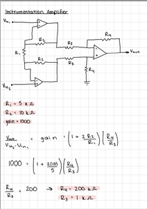

Instrumentation Amplifier
An instrumentation amplifier, or IA, helps provide a large amount of gain for low-level signals. It helps increase the size of the signal so it's more visible and the waveform can be analyzed.
For calculations, we chose two random resistor values for R1 and R2, which are 5 kΩ and 10 kΩ, respectively. We also want the gain to be 1000 so the signal will be easier to analyze. The ratio for R3 and R4 are then solved for by the following equation:
Vout / (Vin1 - Vin2) = [1 + (2*R2/R1)] * (R4/R3) --> R4/R3 = 1000 / [1 + 2*(10) / (5)] --> R4/R3 = 200
We then used that ratio to decide what each resistor value will be. The values are as follows:
R3 = 1 kΩ
R4 = 200 kΩ

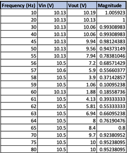

Step 4: Build the Notch Filter
Next, we built the notch filter on the breadboard based on the schematic made on LTSpice. It was built next to the IA circuit. We then recorded input and output voltage values at various frequencies to determine the magnitude. Then, we graphed magnitude vs. frequency on the plot to compare it to the LTSpice simulation. The only thing we changed was the values of C3 and R2 which are 0.22 uF and 430 kΩ, respectively. Again, the frequency it is removing is 60 Hz.

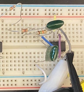

Step 5: Build the Lowpass Filter
We then built the low pass filter on the breadboard based on the schematic on LTSpice next to the notch filter. We then recorded the input and output voltages at various frequencies to determine the magnitude. Then, we plotted the magnitude and frequency to compare it to the LTSpice simulation. The only value we changed for this filter was C2 which is 0.15 uF. The cutoff frequency we were verifying is 150 Hz.
