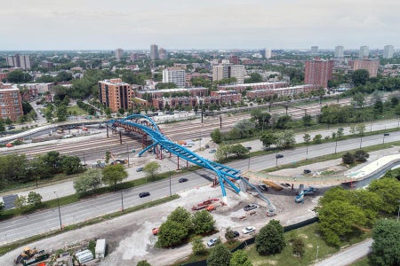

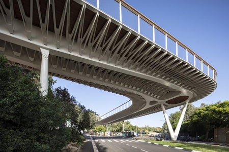

Google around and look at some interesting designs of pedestrian bridges. Think about how your bridge can stand out and be exciting but still fit into the surrounding area and blend with its surroundings. Consider the ways your bridge will be functional, incorporate nature, and successfully connect people. Make a list of all the design elements you want your bridge to incorporate.
I found these images of pedestrian bridge designs that resonated with me. Looking at these images allowed me to better visualize how my bridge would be laid out. I then made the following list of ideas I would incorporate into my design:
