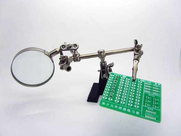

Step 1: Measure and Soldering
First you have to put the break away pins header into your arduino, and then put the prototype board on top of it. Get correct position, make sure all the pins are connected.
After that, you can soldering and fixed the prototype board with the pin headers below

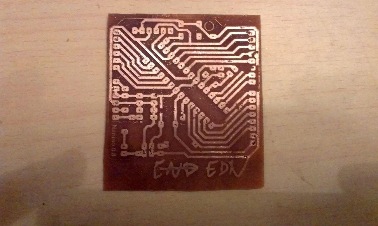

Step 2: Connector on Prototype Board
Soldering the other connector for the bluetooth module anywhere you want, just make sure it convenient.
You also have to think about how to design the wiring go through well, see the reference pictures. You can also use the metal wires connect the two ends and make the soldering line. I am here using the "flying" wiring, for this simple case.
