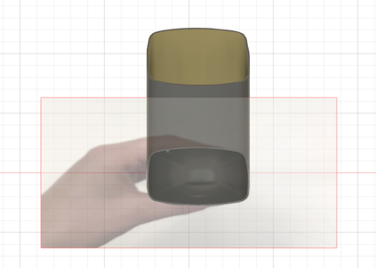

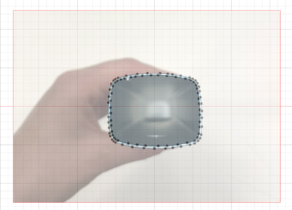

Step 4: Picture
Take a picture of the non universal part from above. Try to make sure to be in line with the part as possible to avoid parallax (perspective shift) of the side profile. An alternate method for flat profiles that can work depending on the size of the part is to directly place the part on a document scanner.
Step 5: Import
Import the picture in Fusion 360 by clicking on Insert > Canvas > Insert from my computer and then select the picture made in Step 4.
Step 6: Tracing

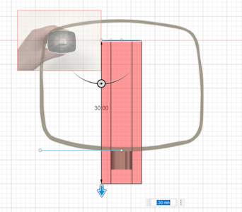

Create a sketch and trace the inside and outside shape of the non-standard part.

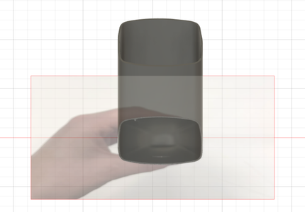

Step 7: Extrude
Extrude the lines to make it a 3D shape.

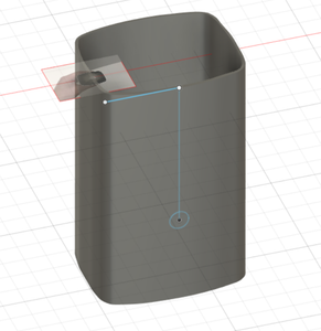

Step 8: Loft
Make a loft between the two extrusions at the bottom and the top.

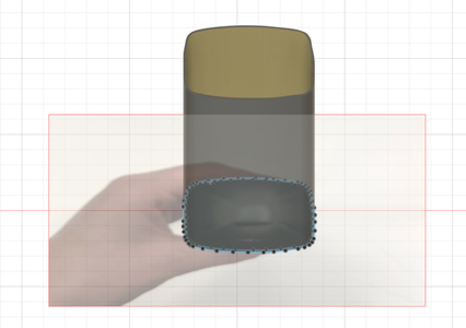

Step 9: Stitch
Stitch the 4 bodies together. This will make it a closed body instead of an open one.
Step 10: Scale
Scale the shape to the correct dimensions, which was measured in Step 3.

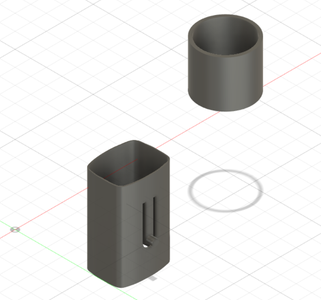

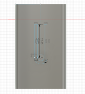

Step 11: Snap Fit
Draw the dimensions measured in Step 3 in the sketch with the line and circle tool under Solid > Create tab > Line or Circle.
Step 12: Cylinder
Create the cylinder in the right dimensions with the cylinder tool under Solid > Create > Cylinder.
Step 13: Draw Extrusion
Draw the sketch of the slot.
Step 14: Extrude Lines
Extrude the lines of the slot under solid > extrude to make the hole.
Step 15: Import
Import the right shape in the file downloaded in Step 2. You can import the shape through Insert > Insert derive, then click on the library document and double click on the right shape. The shape will now be imported to your document.

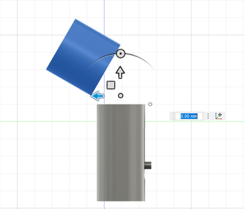

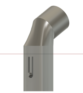

Step 16: Measure Angle
Measure the angle in the original product.
Step 17: Right Angle
Place the universal and non universal part in the right angle. Select the body > Move/copy > select Rotate > insert 120 degrees > move object to the right place.

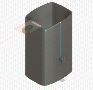

Step 18: Attaching Two Parts
Attach the two parts to each other Using the loft tool found in Surface > Loft. Loft the inside shapes and the outside shapes separately from each other.

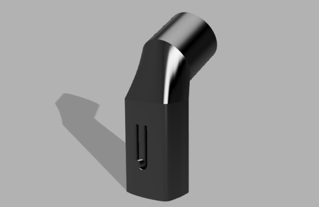

Step 19: Complete
Done! Now you can print your part and use it to repair your broken electronics.
