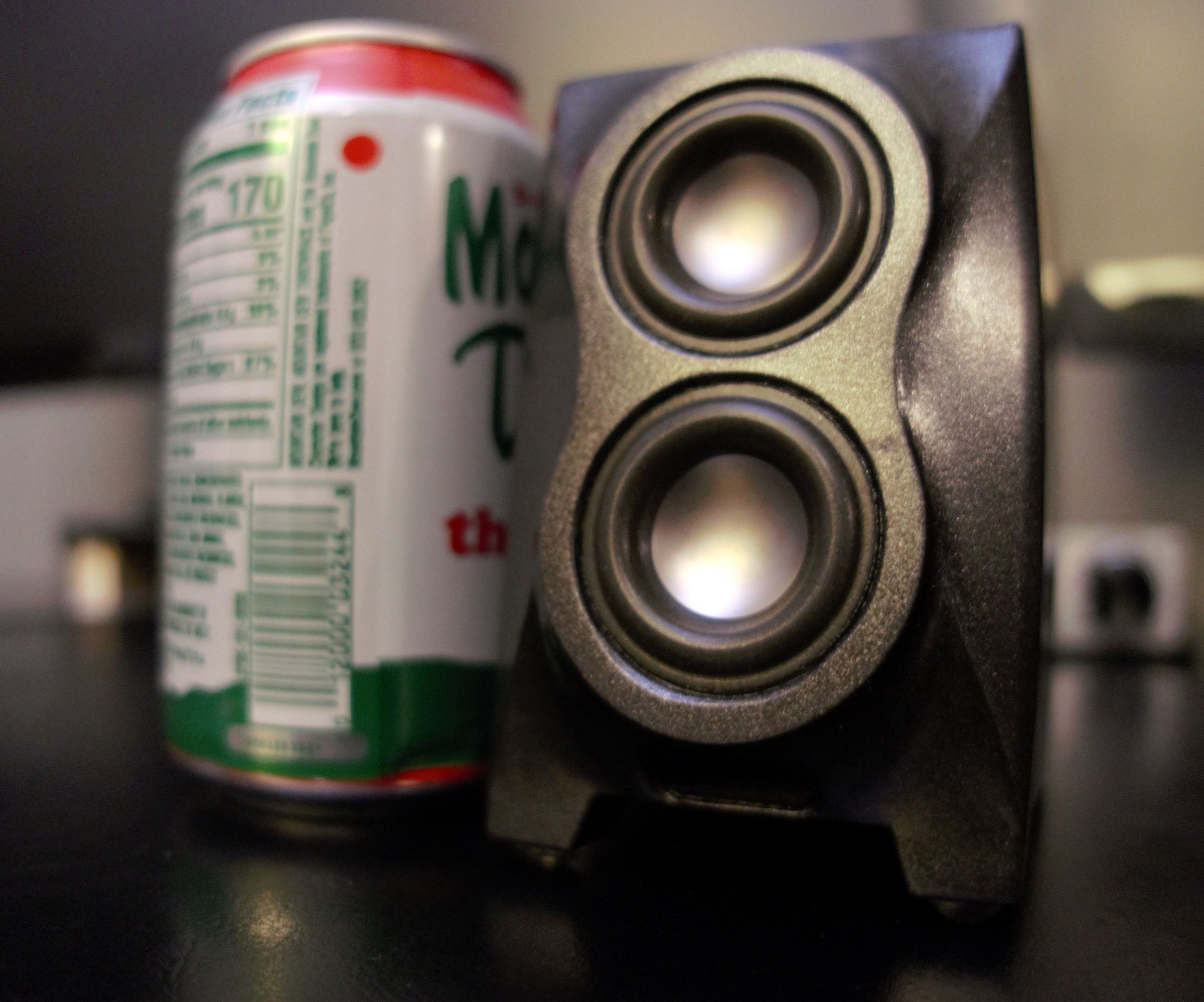

Like many audiophiles/music-lovers I am on a quest for better and better sounding music. Lately, with how much time I have been spending at my home office desk, this has led to the desire to upgrade from the pathetic speakers built into my computer monitors to a set approaching truly "Hi-Fi" whilst staying within the confines of my desk and my budget.
These desktop speakers measure approx 4.25 in (11 cm) tall, 6 in (15 cm) wide, and 5 in (13 cm) deep and lean heavily on 3D printing, which is turning out to be an incredible tool for custom speaker building. Not only did I make small parts like the vent tube and terminal cup with a 3D printer, but both the front and rear baffles are 3D-printed as well, using 20% wood-filled filament. Even the concrete enclosure walls were made in one piece using a 3D-printed mold!
In this Instructable I'll show you how to use some fundamental loudspeaker design principles (and some more advanced ones) to create compact and incredible-sounding Hi-Fi speakers that will fit on almost any computer desk. Let's get started!
