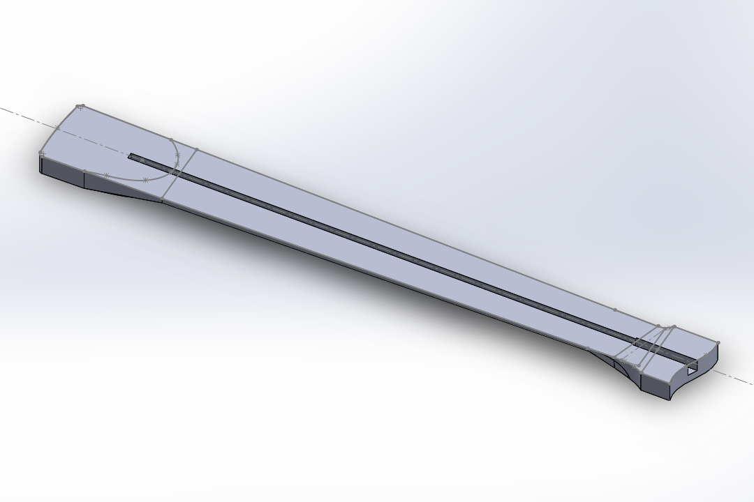

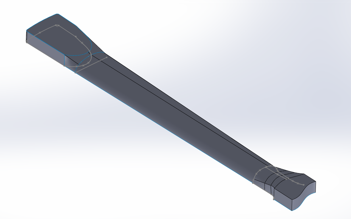

Step 4: Modelling the Neck
While CAD is absolutely necessary in a CNC build, it can also be helpful for more traditional router-and-template builds for creating detailed and accurate plans.
Beginning by establishing a centerline, a series of drawings are made, with the imported DXF from FretFind, the body shape, and the headstock shape (or whatever is left of it). Splines are used for the body. The neck shape also determines the neck pocket shape. Note the radii on the corners of the heel, which are required for a router bit to create the neck pocket. In order to create more contact surface between the neck and the pocket, I extended the shape of the neck. This also resulted in space for 2 extra frets! Woo!
The two blue lines show the 2 locations that neck profiles will be drawn to create the shape of the neck.
The blue line here reflects the profile at the first fret, the orange one is the one at the 17th. Note the asymmetrical profile at the first fret, which will, along the length of the neck, transition into a symmetrical profile. This makes the neck feel thicker and more comfortable at the top, yet thinner and faster near the bottom.
Fretboards tend to be 6.35mm (0.25in) thick. To achieve my target 23.5mm thickness, the profiles should be 17.15mm at the maximum. The headstock and region where the neck meets the body should be 25.4mm (1in) thick, meaning all of these surfaces should be a thickness of 19.05mm (0.75in).

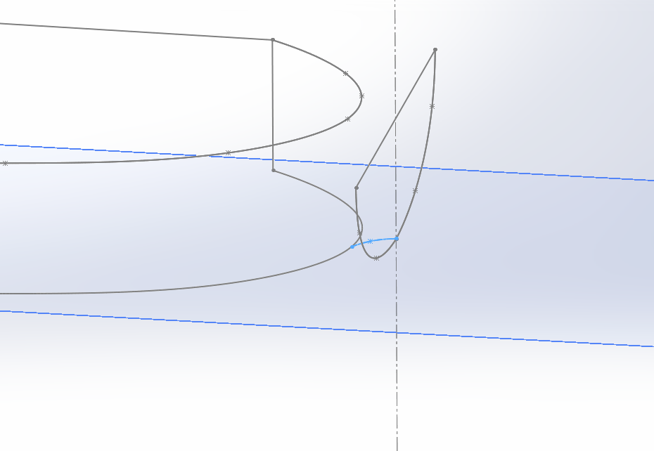

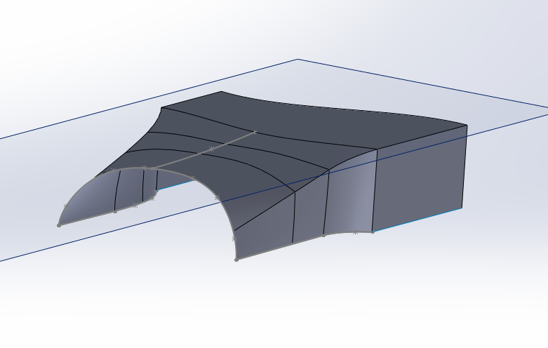

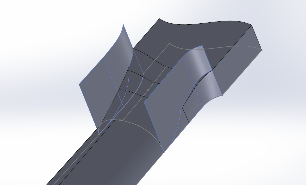

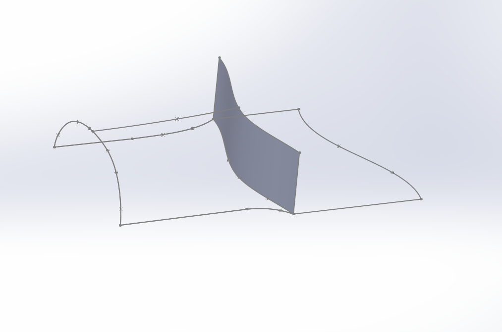

The difficult about modelling a guitar neck is the organic surfaces that make up the back. The part that the neck meets the headstock is quite annoying to model. However, it can be broken down into a lofted surface between the first fret profile and the profile outlined by the grey surface. The neck outline and the third line near the top serve as boundary/guide curves for the loft.
After the loft is created, there may be sections of surface that extends OUTSIDE of the boundary set by the neck shape. However, this extra surface will cause issues in the CNC when it will try to carve a surface that is vertically concave - it will not like that. Therefore, the extra surface is intersected with the two extruded parts of the neck shape to create a surface that is no more than 90 degrees.
The carved surface at the heel of the neck is created using the same process, but with these curves shown.
The back surface of the neck is created using a loft between the two profiles, and the neck outline as a guide. These surfaces are joined and a solid created by filling in all the other surfaces required for the neck

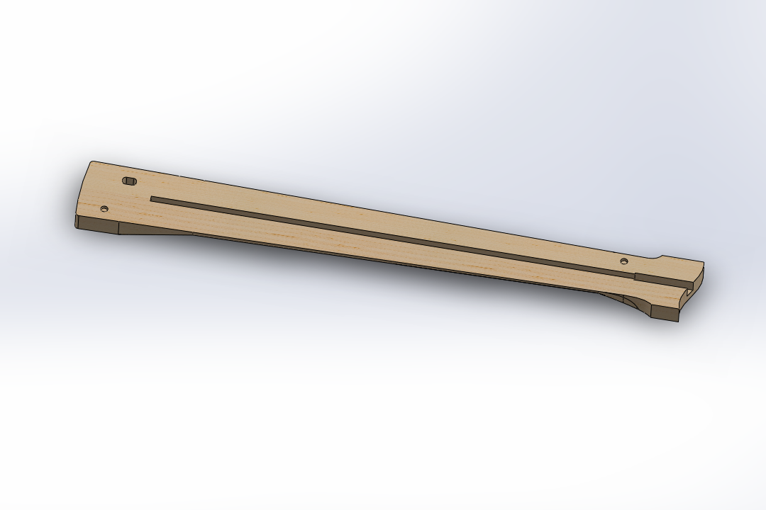

The front surface of the neck receives an extruded cut for the truss rod. Dimensions will vary with different truss rods. Here I am using the dimensions from a StewMac Hot Rod. Note the slightly wider slot near the headstock to account for the adjusting nut being wider than the truss rod body.
For now the neck is finished, and we will add finishing touches to it later.

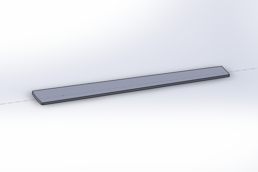

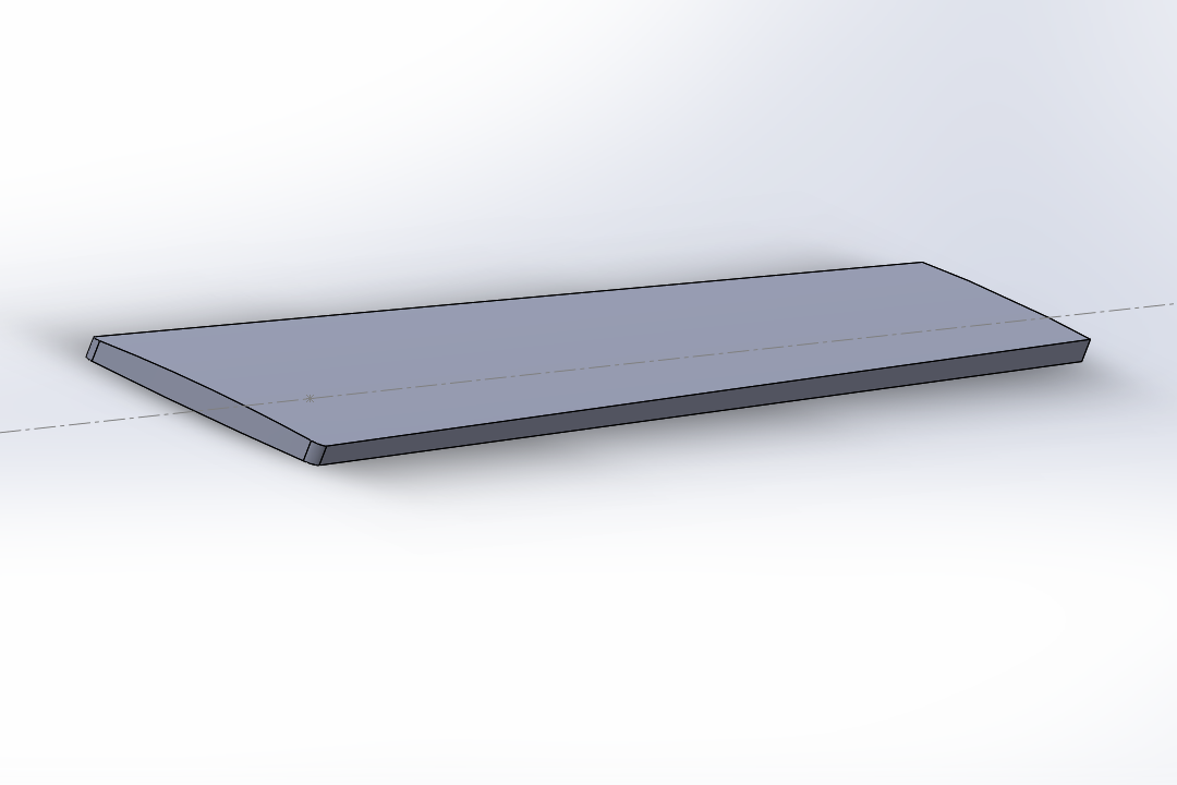

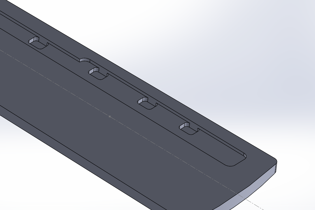

Step 5: Modelling the Fretboard
The fretboard is slightly easier to model, especially since we now have the drawings from the beginning. Using these drawings, the outline of the fretboard, leaving a bit of an overhang for the zeroth fret, is extruded into a 6.35mm (0.25in) solid.

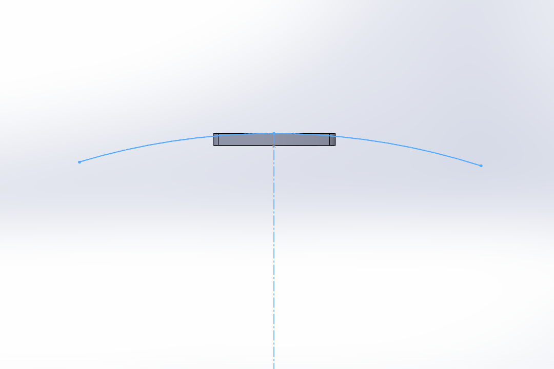

Fretboards have a certain radius on the surface, and values from 7-20 inches are commonly seen. This is easily created using a CNC. The center of that arc is located one radius away the top of the fretboard. This arc, when used to slice the solid, creates our radiused fretboard.
I am going to be embedding optic fibers inside my fretboard to make glowing side fret markers. These extruded cuts allow for these fibers to be routed. A slightly deeper cut for the part where the fibers exit ensures that less material is cut away to possibly preserve tone.

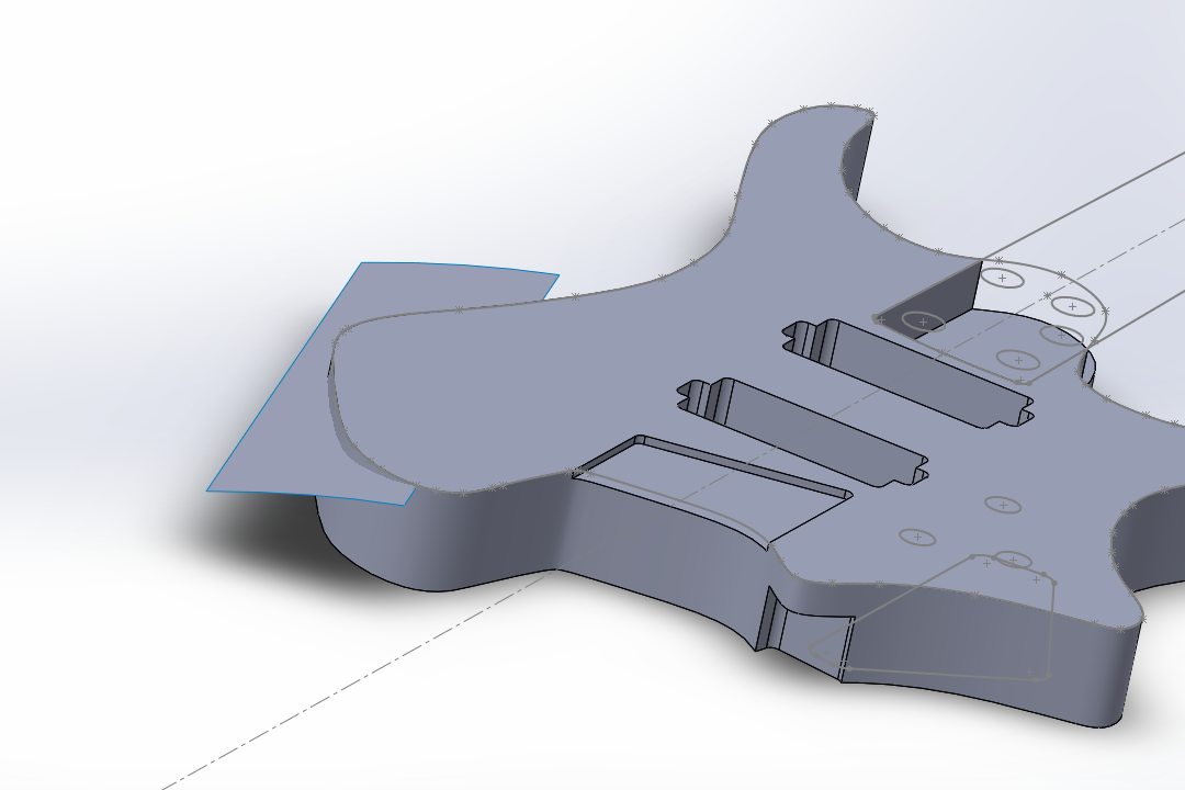

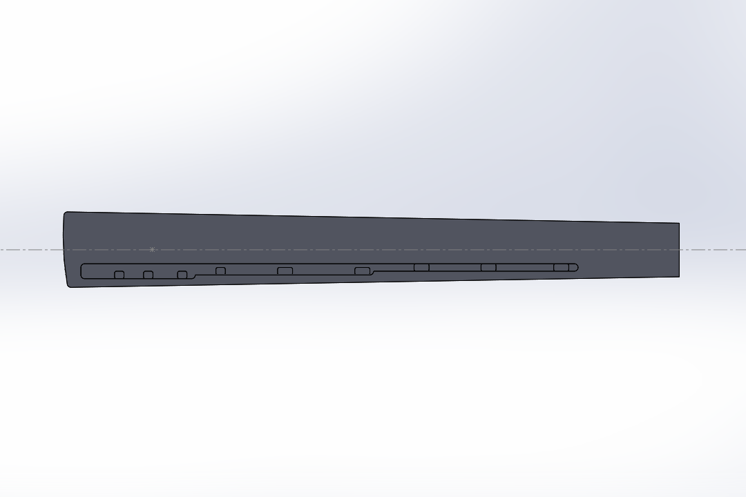

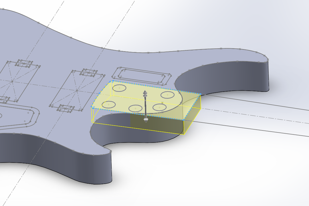

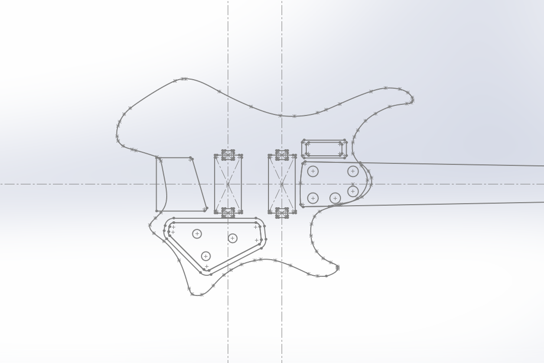

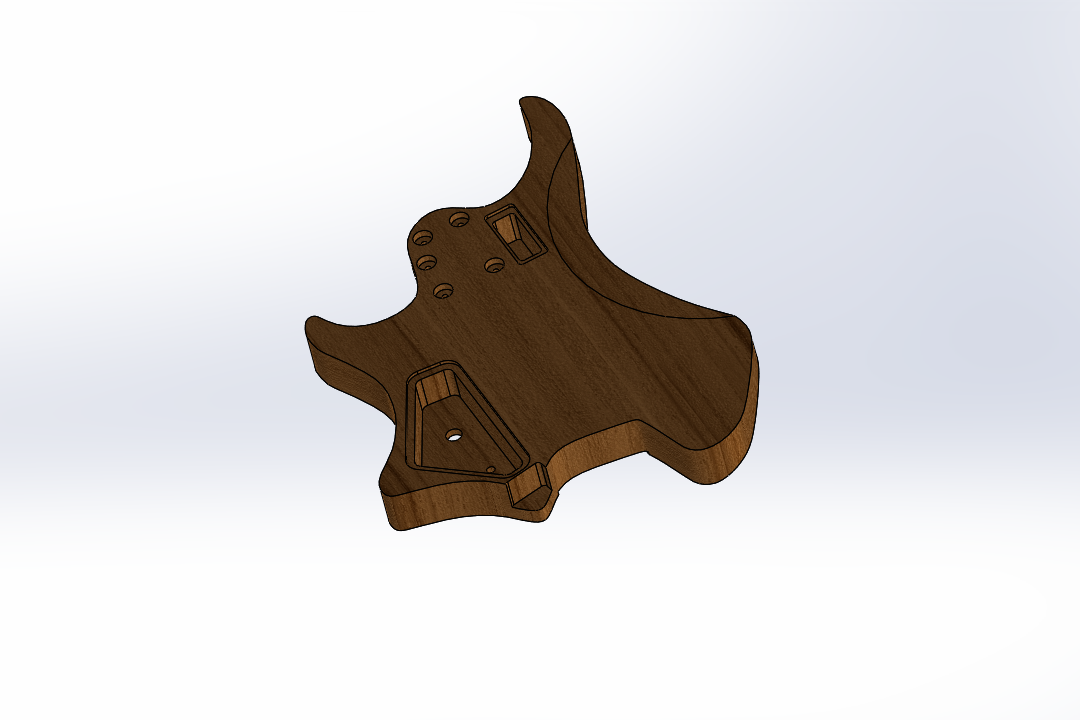

Step 6: Modelling the Body

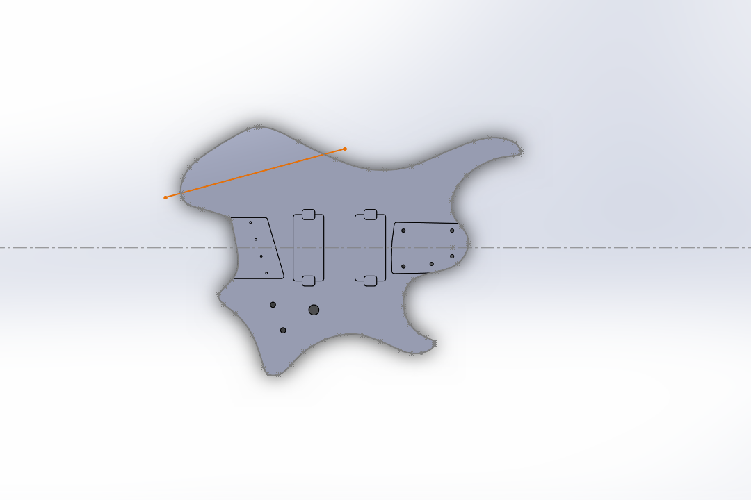

The body of the guitar is mostly a series of straight extruded cuts. This makes it really easy to model once the shapes are all created. More drawings are made on the body for all the cavities.
The small rectangular cutout near the neck is used for the LED for the side lights. The cutout for the bridge is also created at the far left. I created a custom bridge mounting plate (again, models included), but Mera Guitars does offer pre-made bridge plates. However, they will not fit in this route and you will need to change the cutout. I will attach a model with only the control cavity cut out for those who are interested in using different pickups/bridge/no LED.
Mounting holes for the neck and pots/switch are also created.

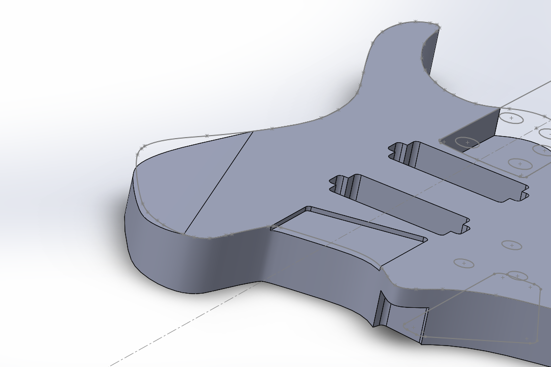

The extruded cut of the neck pocket is shown here. The depth that the neck sits in the body is 19.05mm (0.75in). This is a fairly standard depth based off of Fender dimensions.

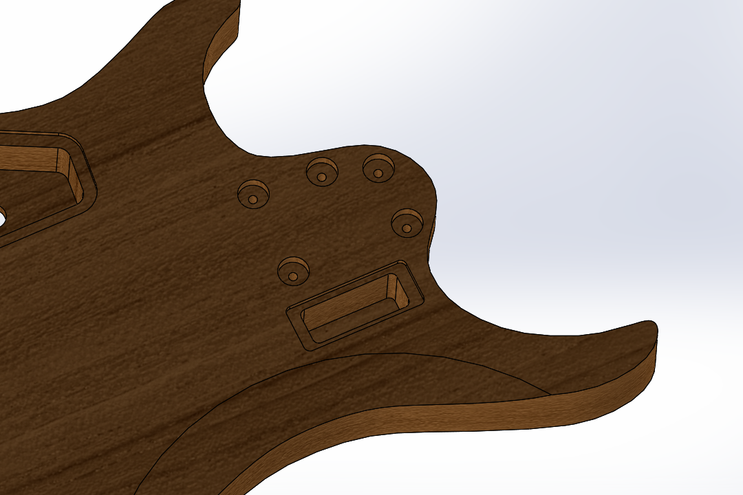

Pickup cavities should accommodate most of the thickness of a pickup, leaving no more than 2-3mm above the top of the body when bottomed out. Mine are a good standard of 19.05mm. The cutouts for the pickup legs (short legs) are a full 25.4mm (1in). The cavities should leave about 1-2mm around the pickup.
The control cavity and LED cavity are, of course, extruded from the bottom. The offset shapes around the cavities create ridges for mounting the covers.
While designing cavities on the guitar body, make sure to think about how they will be executed. Walls that are too thin may break on a CNC. Corners of cavities will have a radius because an end mill/router bit is round. Some cavities are deep and can only be cut using a larger, longer bit. These factors should be considered when designing.

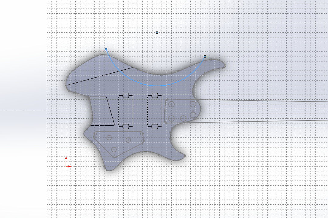

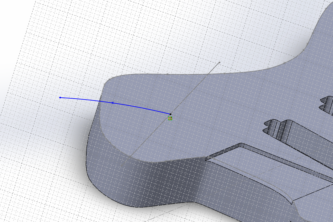

Arm and belly carves can be created using surfaces extruded along a line. Here I show the process of creating the arm carve. A line representing the end of the arm carve is extruded along a curve, and the resulting surface is intersected with the rest of the body (or used to slice the body).
The belly carve is also created this way, with an arc instead.

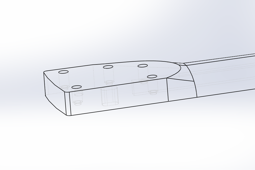

For neck bolt locations, make sure the wall is plenty thick enough so the wood does not break or flex when the string is pulling. Here I have more than 6mm of material between any hole and the edge.
A small cutout, created with reference to the slot on the back of the fretboard, is used for routing the optic fibers out of the neck. Two shallow 1/4 inch drill points are marked (and mirrored on the fretboard) so that dowel pins can be used to invisibly align the neck and fretboard when gluing.
The corresponding clearance holes on the body are created. Cavities for neck mounting ferrules are created.
The cutout for the jack mounting cutout (triangle looking thing near the bottom left corner) is created for mounting a long threaded jack. Again keep in mind that walls should be fairly thick (5-6mm) to prevent the wood from cracking when routed.

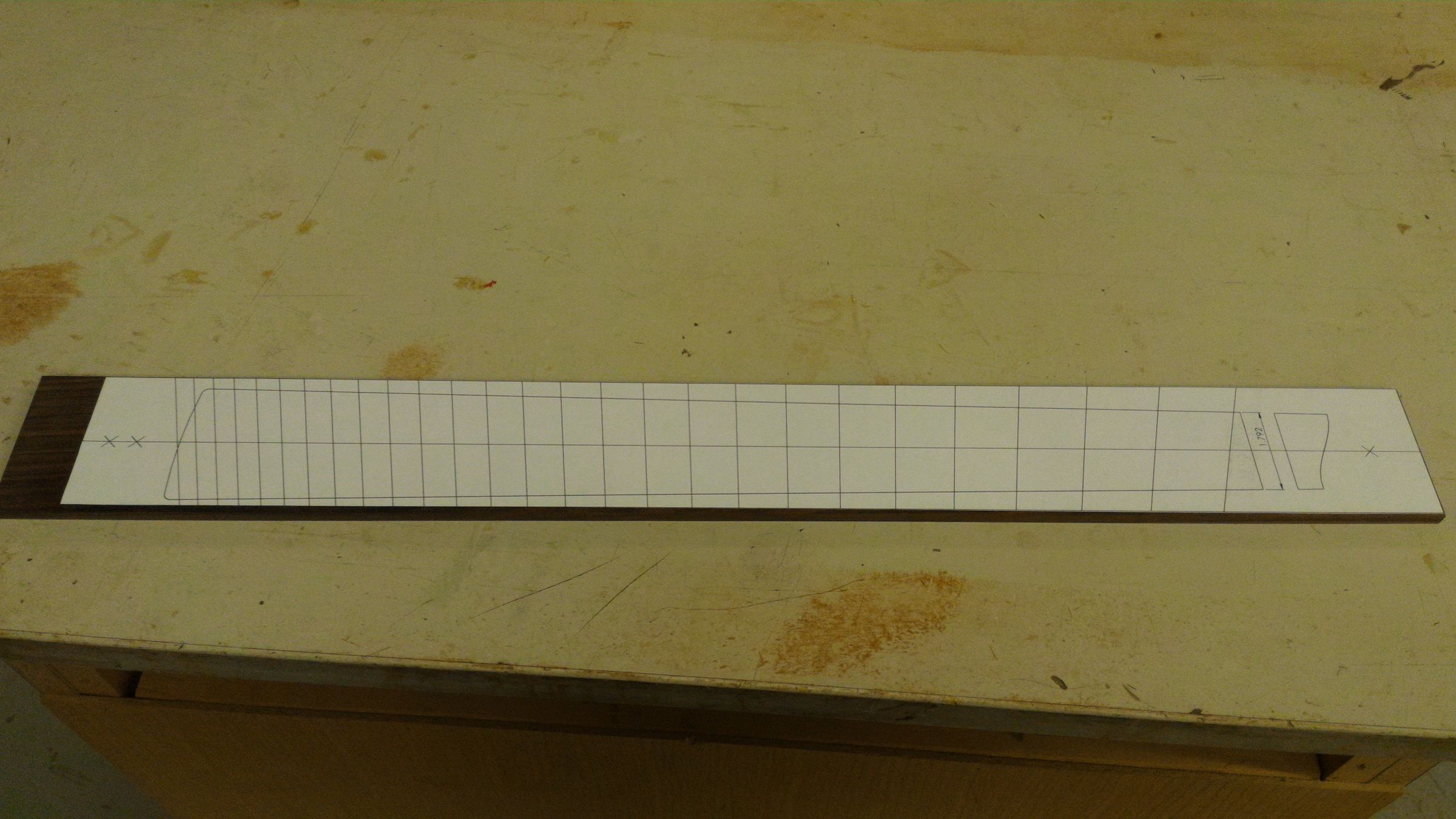

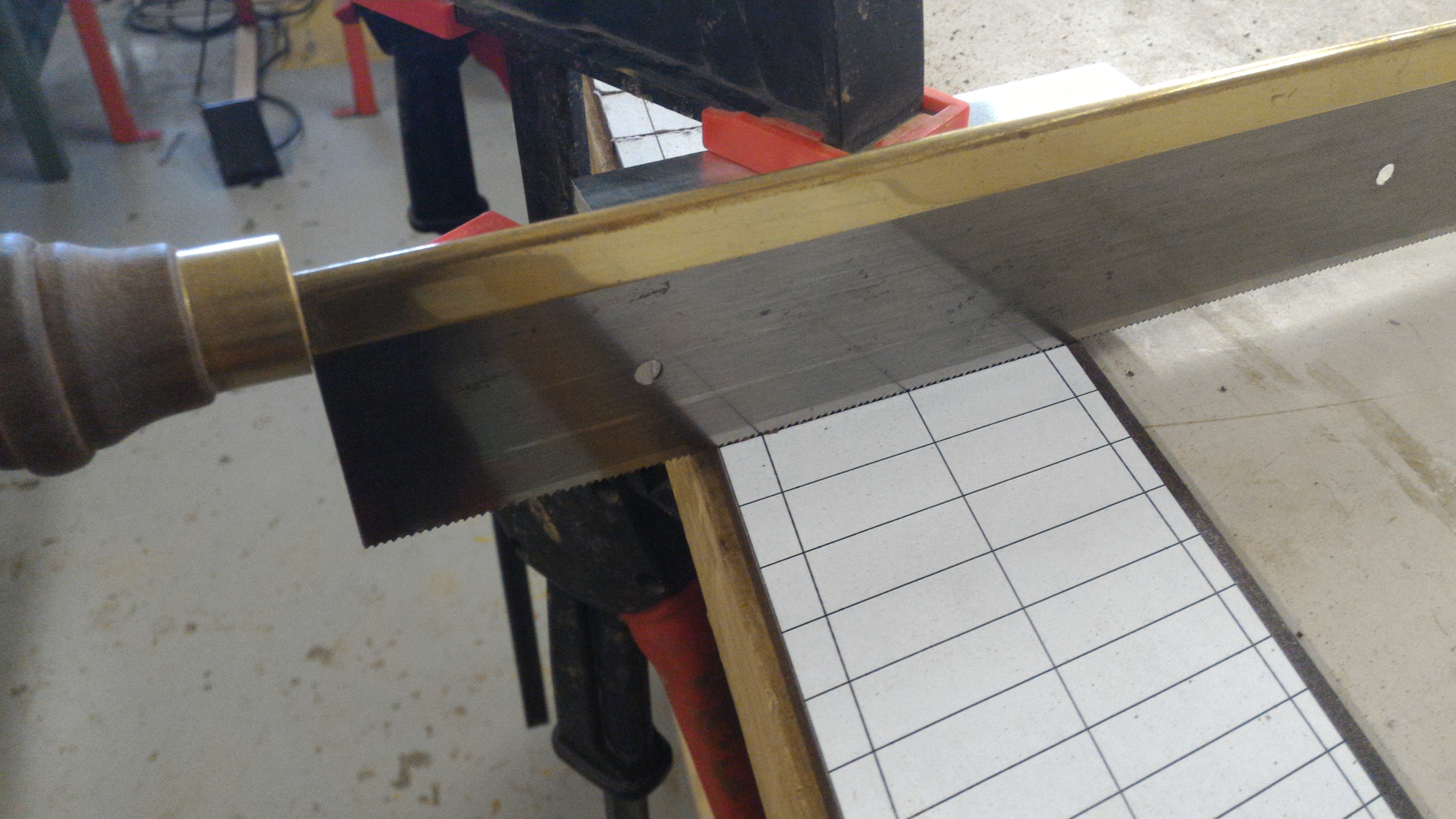

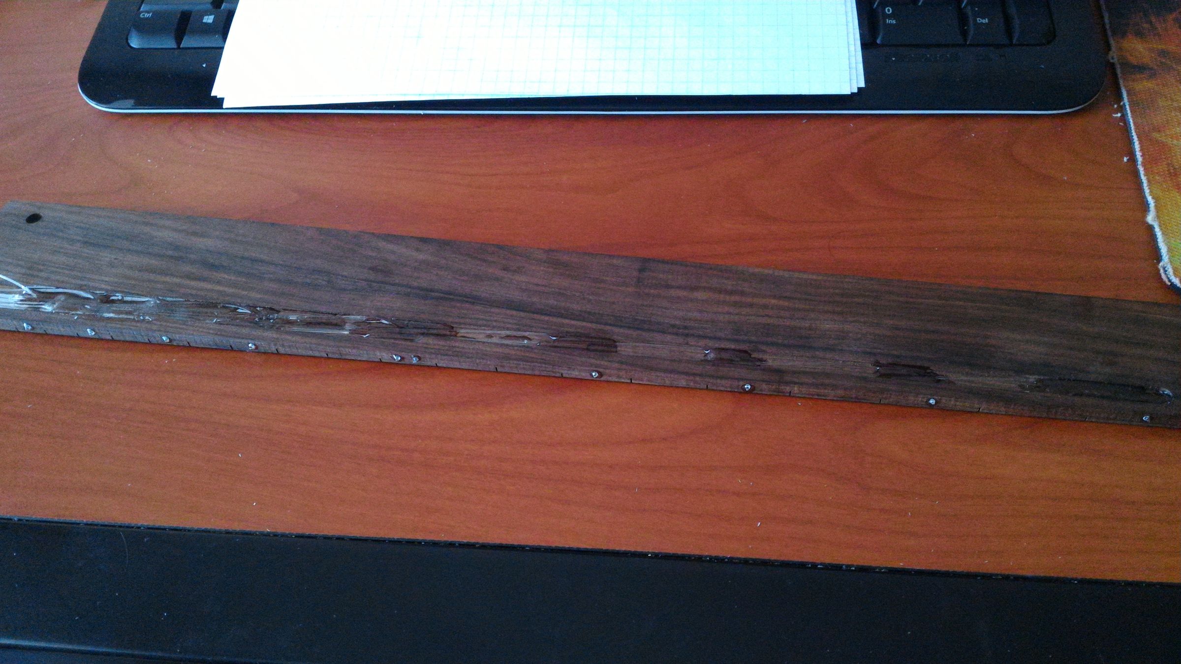

Step 9: Cutting Fret Slots

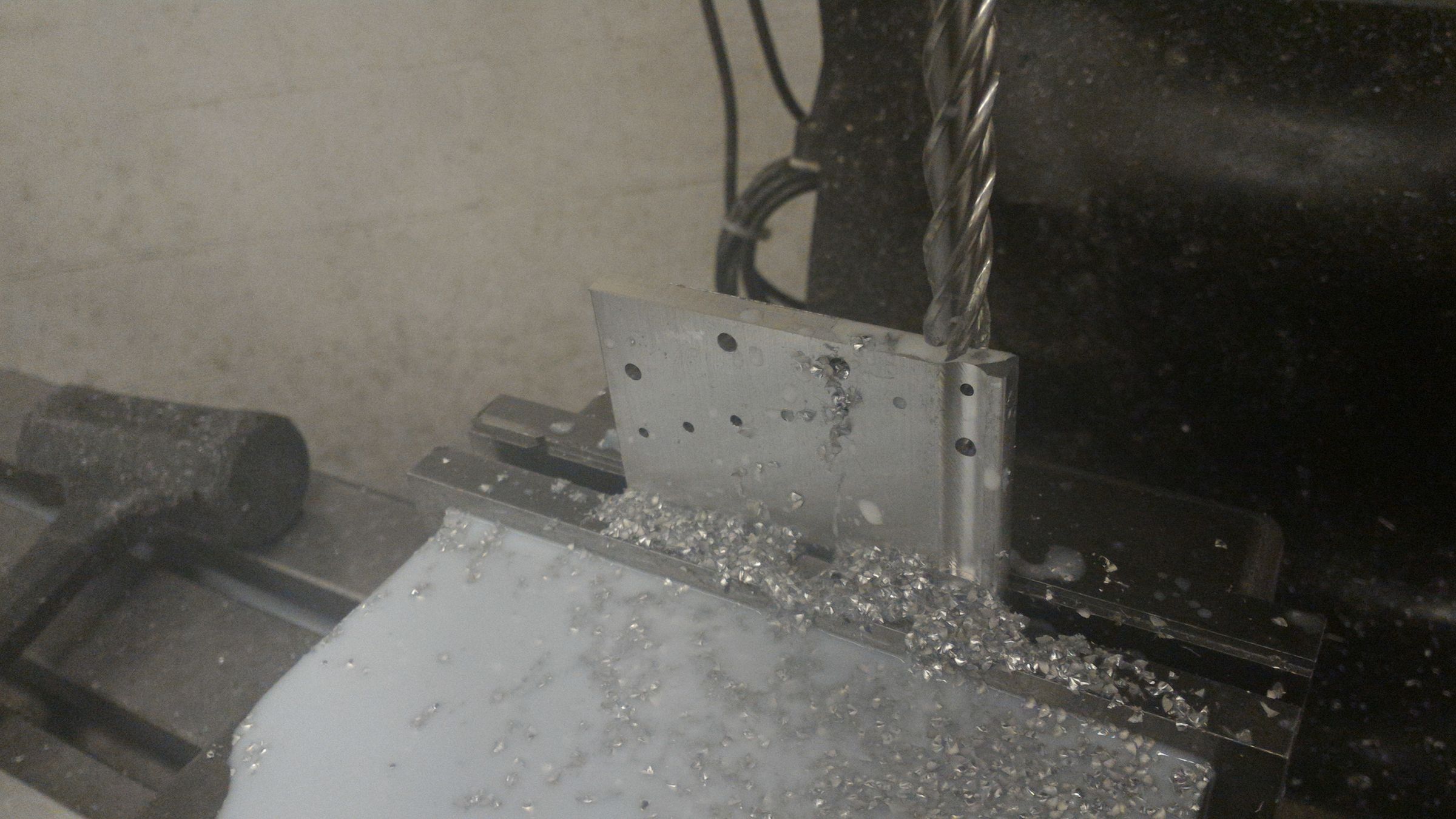

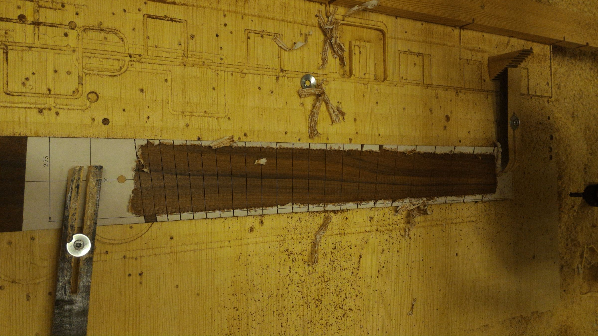

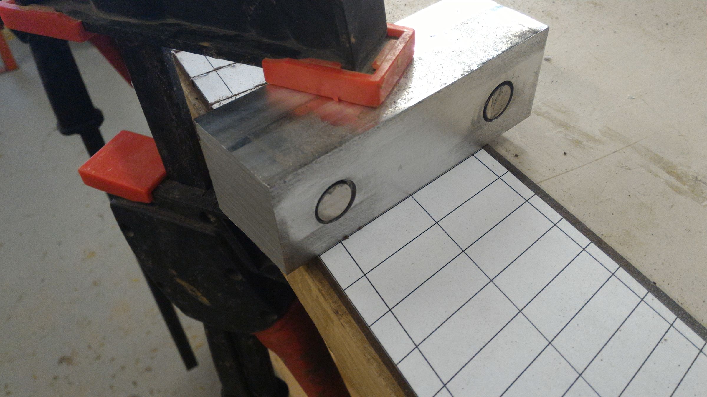

Before the CNC work begins, I slot the frets manually. While fret slots CAN be done on a CNC. the degree of accuracy is unnecessary and sometimes impossible as an extremely small bit is required.
A to-scale (or as close as possible) printout of my fretboard is glued to the fretboard blank. The centerline should be parallel with the squared edge of the fretboard from the previous step. This is very important for aligning this fretboard to the axis of the CNC. The X's mark known locations (origin, 1 inch, 20 inch?) along the axis for positioning and dowel holes for flipping the part.
I used a square milled aluminum block (wood would do as well, as long as its edges are square) with embedded neodymium magnets as a jig for slotting fret slots. The fretboard is clamped against the table, and the block is then clamped on top of the fretboard against the table. The magnets pull the saw against the block, forming a stable, adjustable, yet simple saw guide. The top of my block also acts as a depth gauge.
The slot should be slightly deeper than the fret tang at the edge of the fretboard (remember the radius?). I used a depth of about 3.5-4mm.

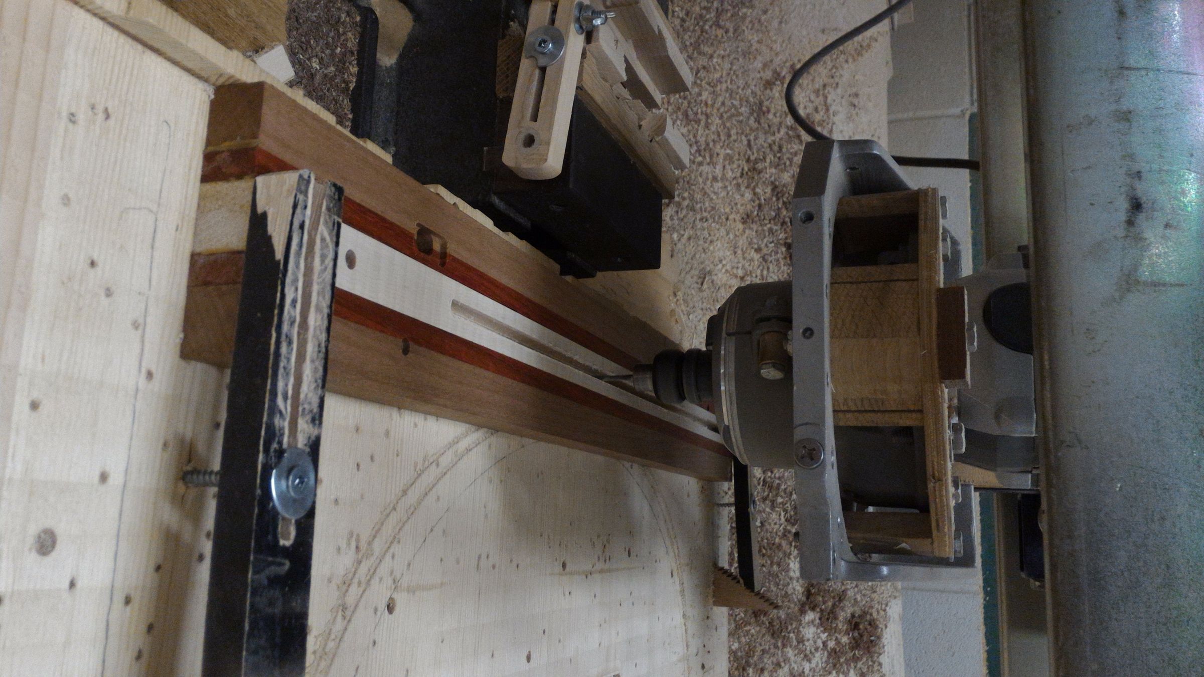

Step 10: CNC - Fretboard
The dowel positioning pins are drilled, through the fretboard and into the spoil board underneath. Then the back of the fretboard is routed. The fretboard is flipped and put back on the dowel pins - this is analogous to a mirror across the X axis, so make sure this change is reflected in the CAD/CAM. Then the radius is routed. Half of the contour is done at a time (on either side of the centerline) with the clamps positioned on the half that is not being cut.

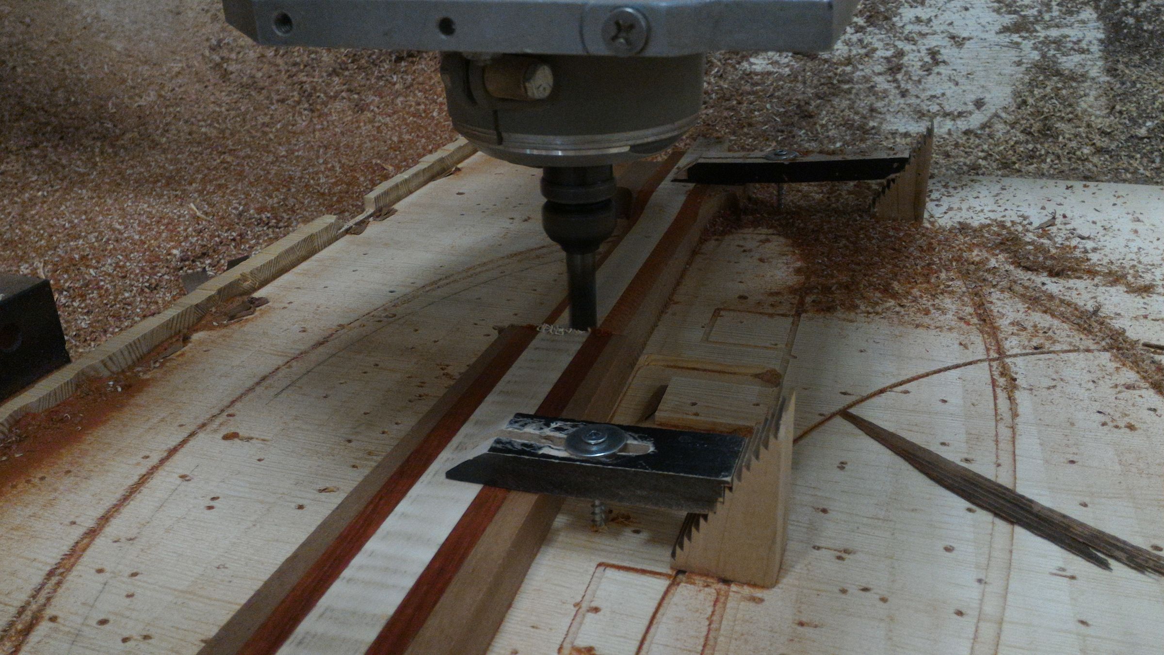

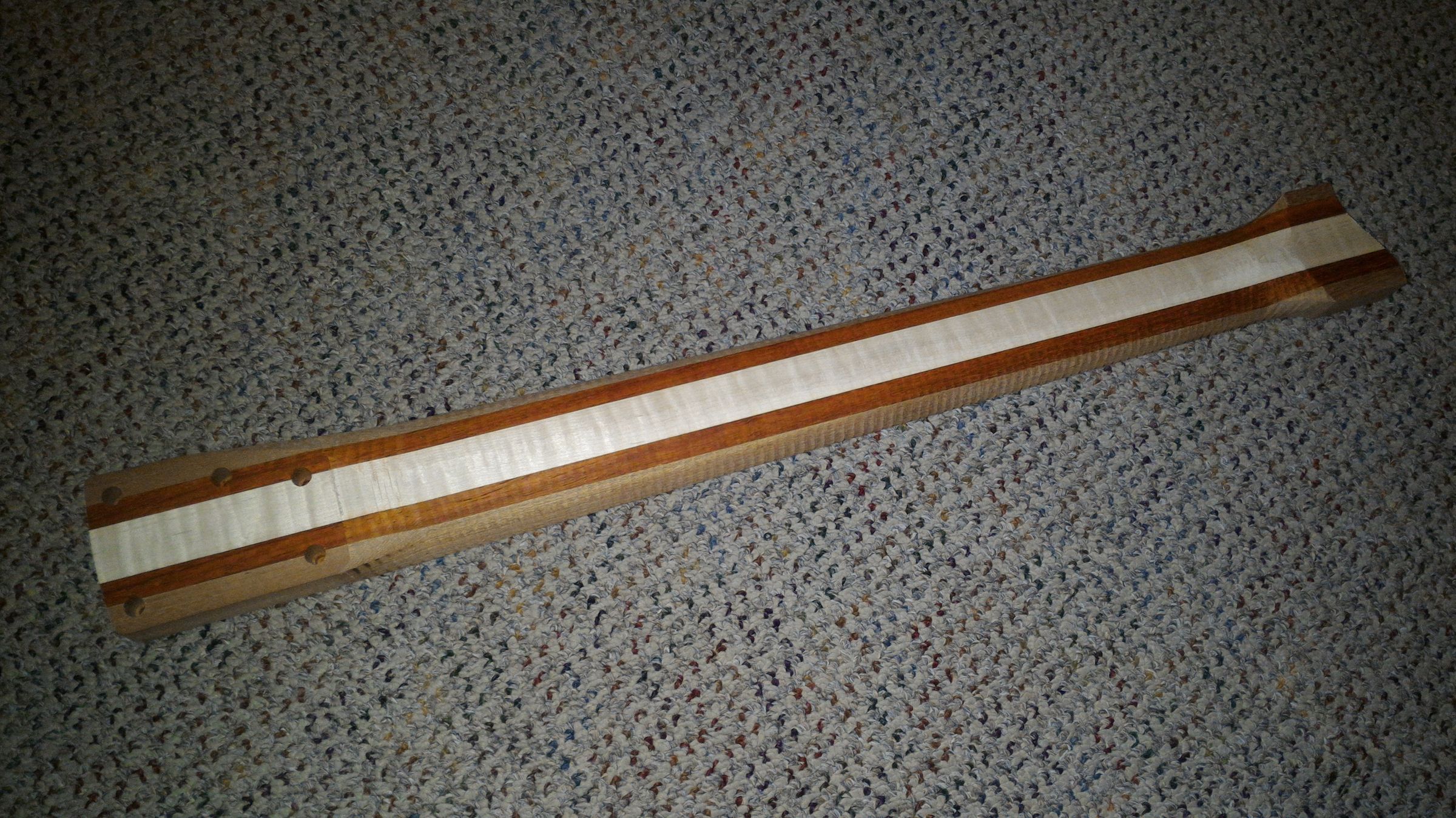

Step 11: CNC - Neck

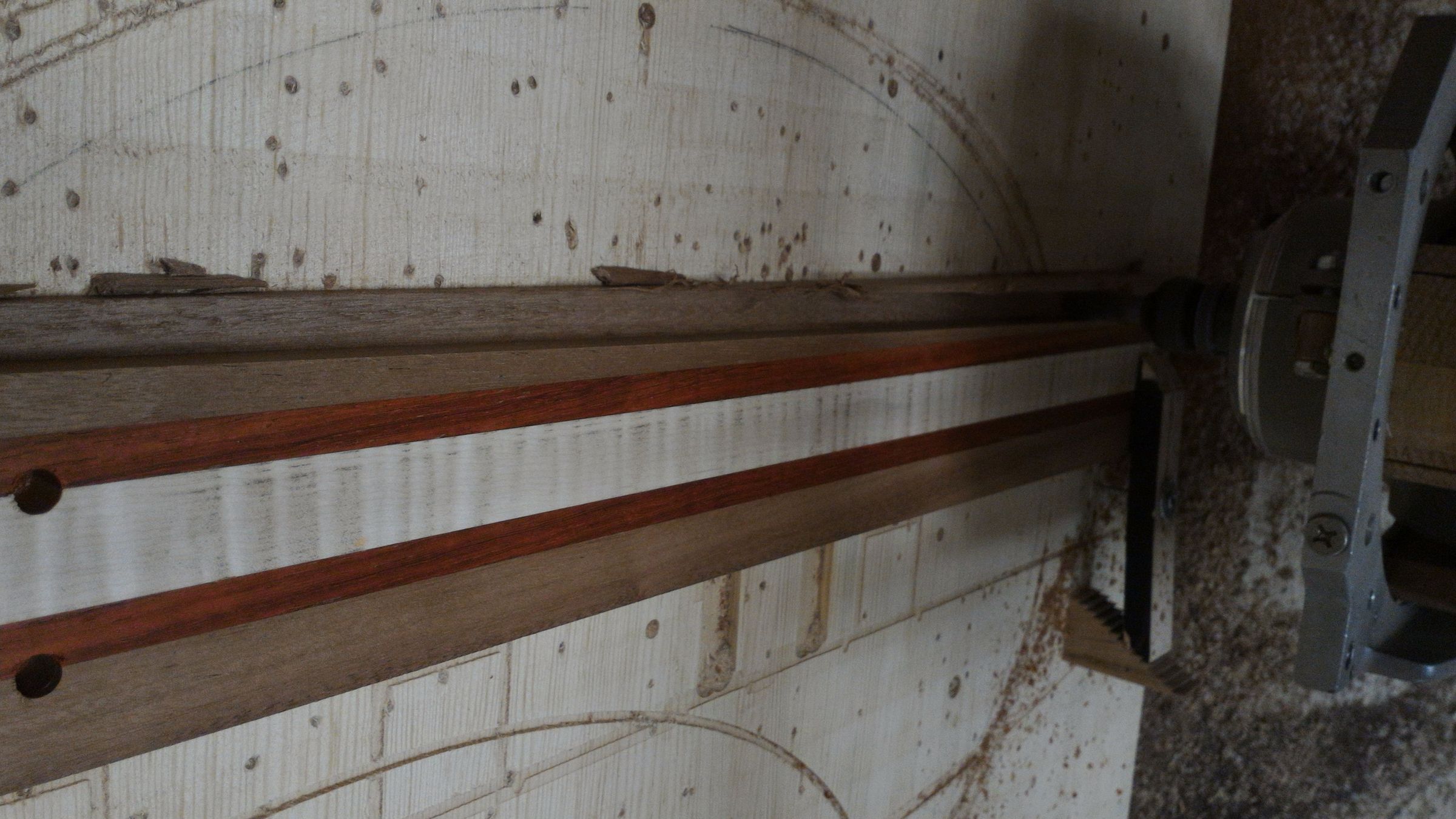

The neck starts much like the fretboard, with the flat surface first. Dowel location holes are drilled and the truss rod channel is routed.
I like to remove some material with a larger bit so that the router doesn't have to do too much work when carving the neck profile. Two routes are made, offset by about 3mm from the outline of the neck, for the profile section of the neck.
The "headstock" outline is routed, followed by the profile, and then the mounting holes, and the heel outline.

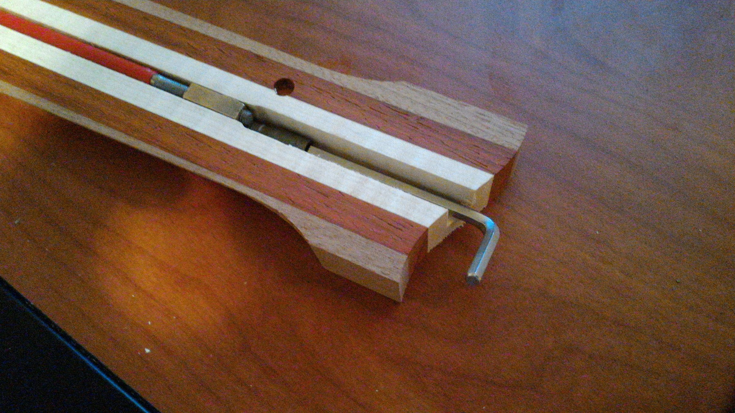

Result of the back
The truss rod and allen key fits!!

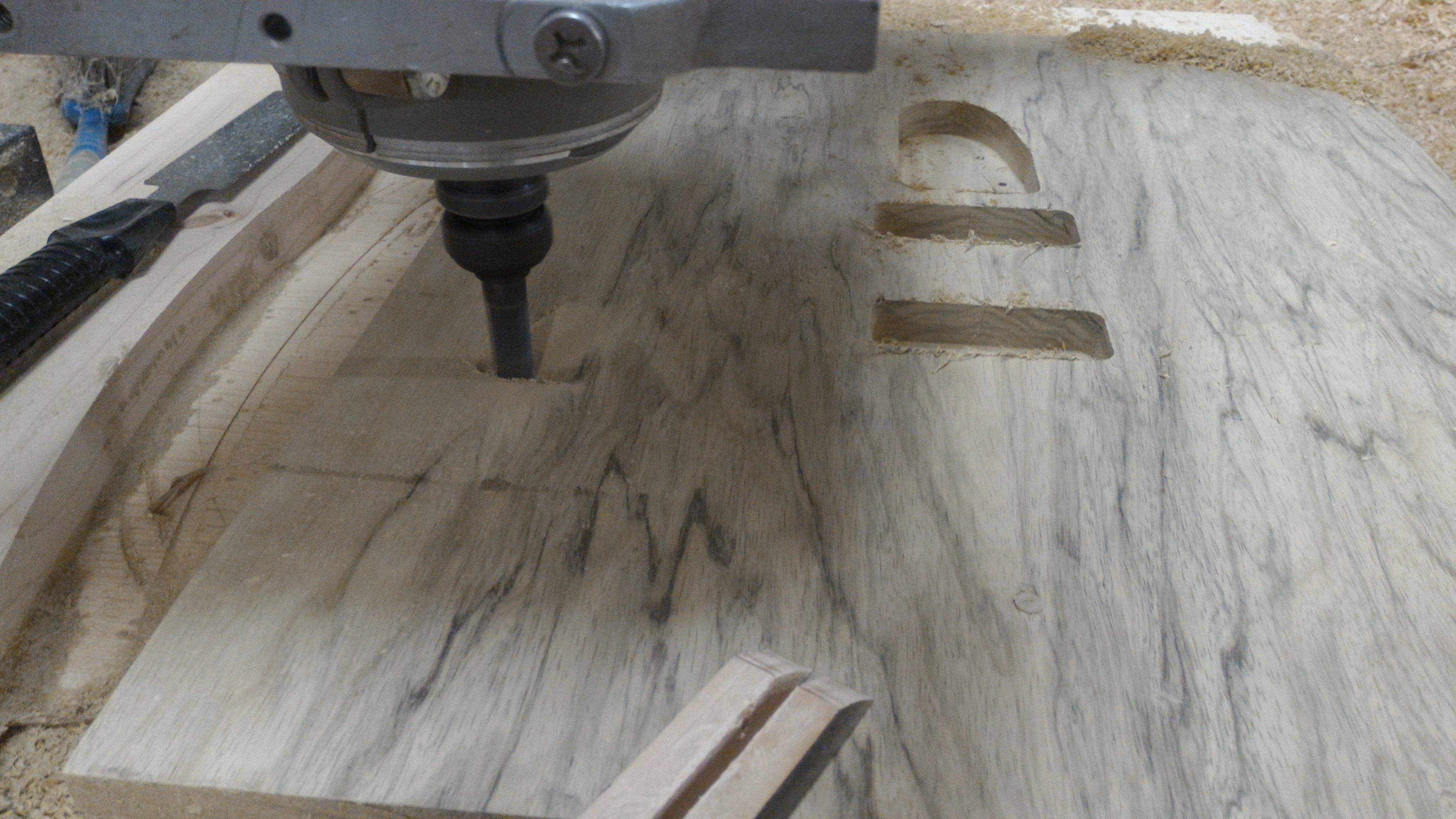

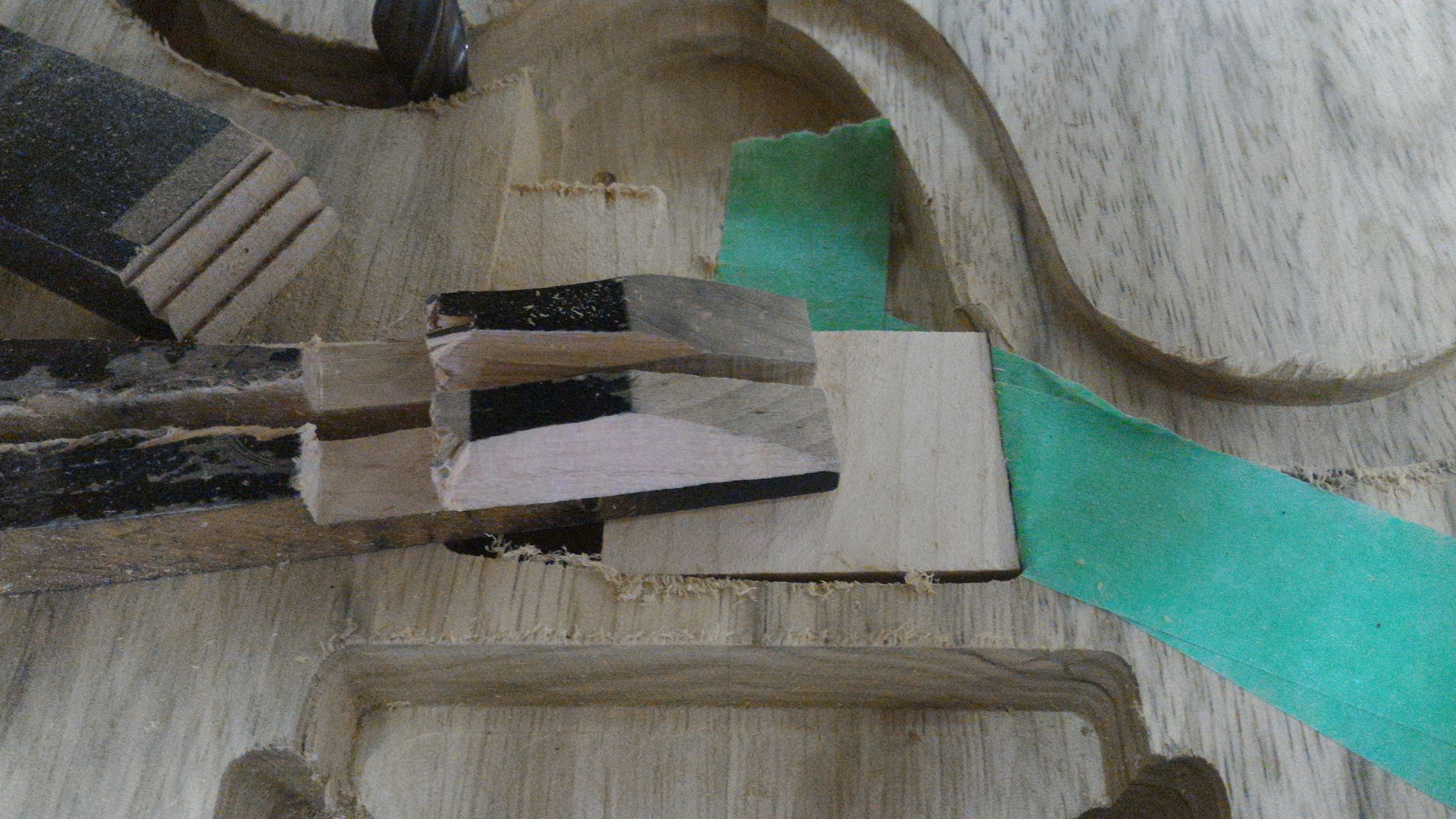

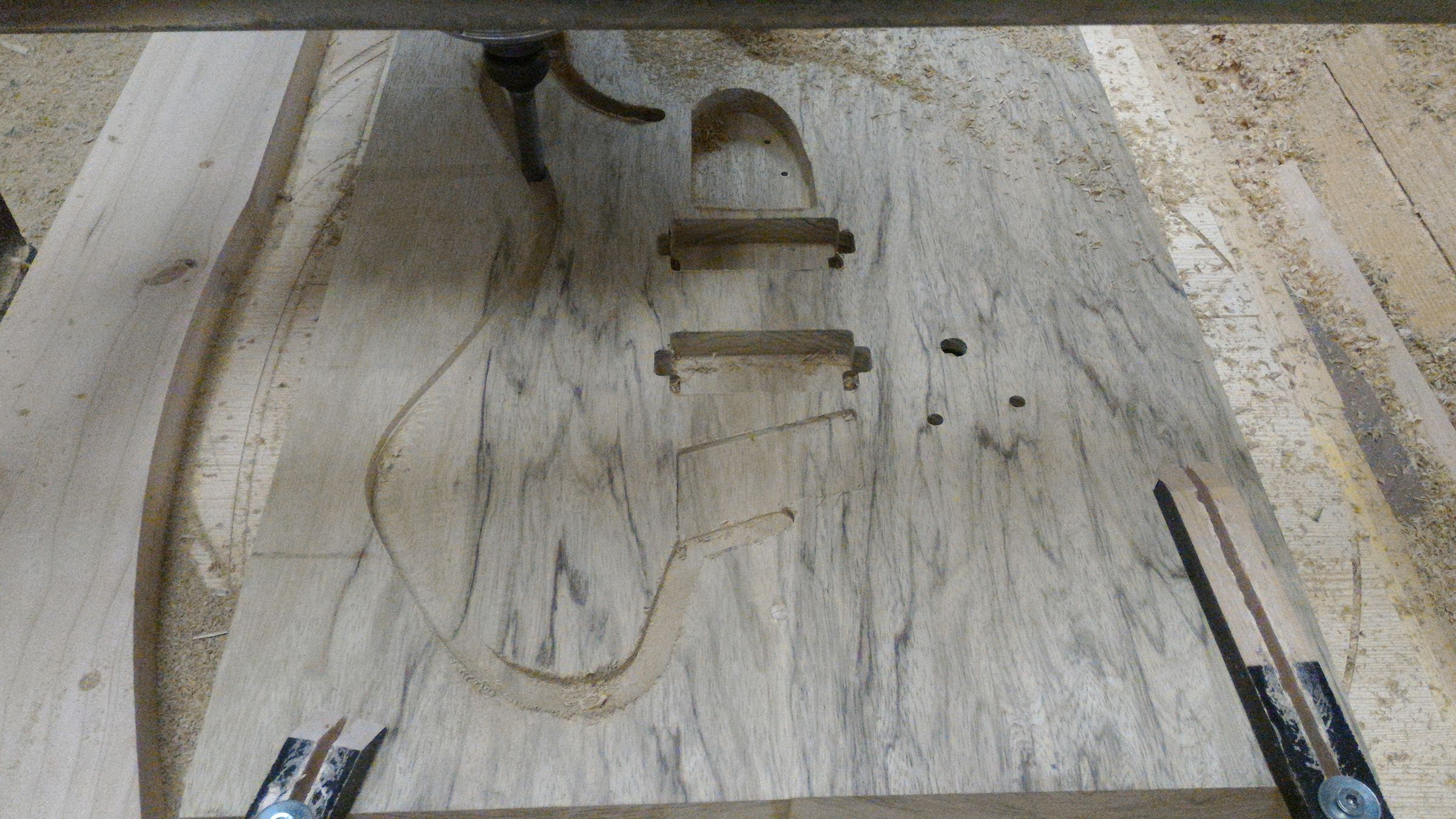

Step 12: CNC - Body
The body, again, begins with the dowel positioning holes, and the pocket operations on the bottom, which I seem to not have photos of. The body is then flipped, and the pockets on the front are routed. Here the router is surfacing the arm carve. The best routing direction is outwards from the middle of the body to make sanding easier at the end.
The outline of the body is routed.
The thin wall of the neck pocket here will likely want to crack when routing out the body shape. The solution is to clamp a block of wood in the pocket against the wall to prevent that piece from flexing. Excuse the demolished clamp.

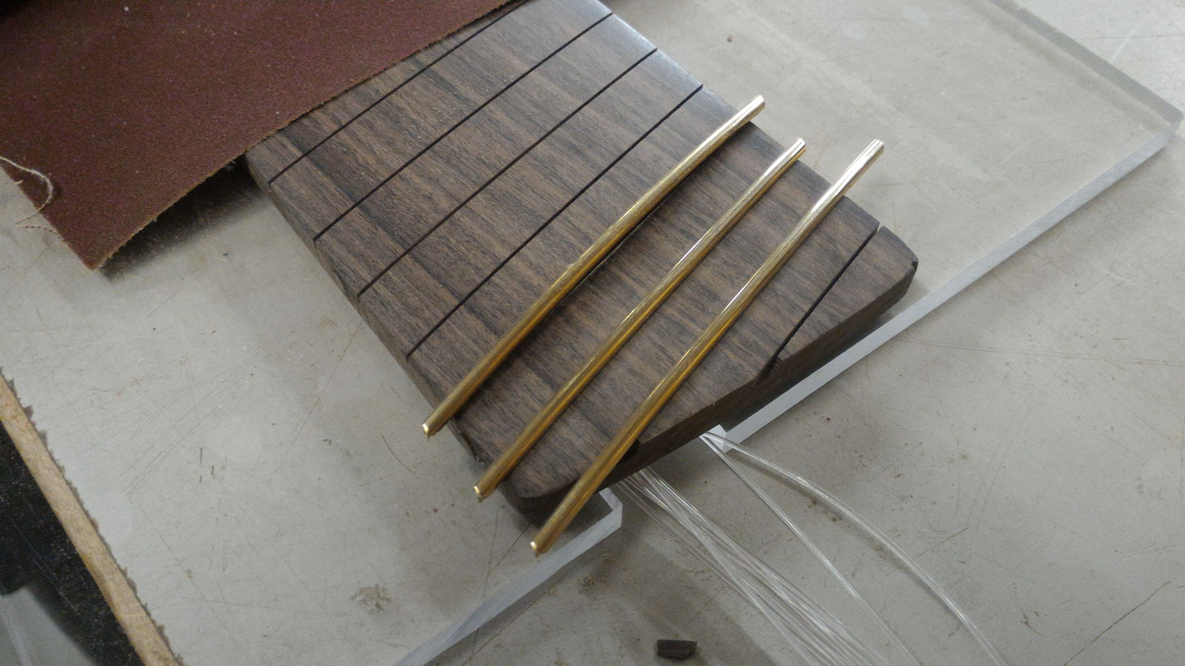

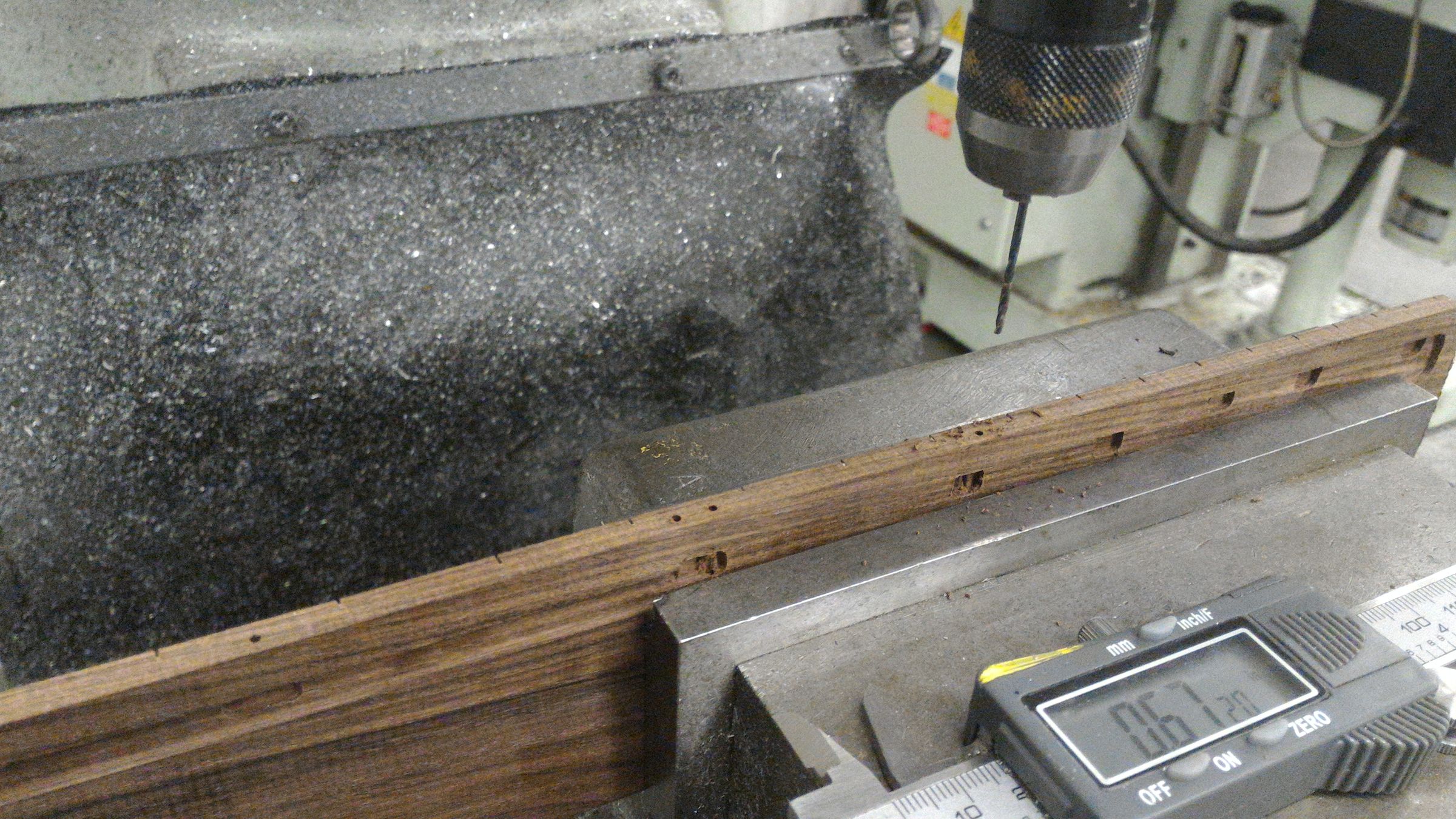

Step 13: Fiber Optic Side Dots

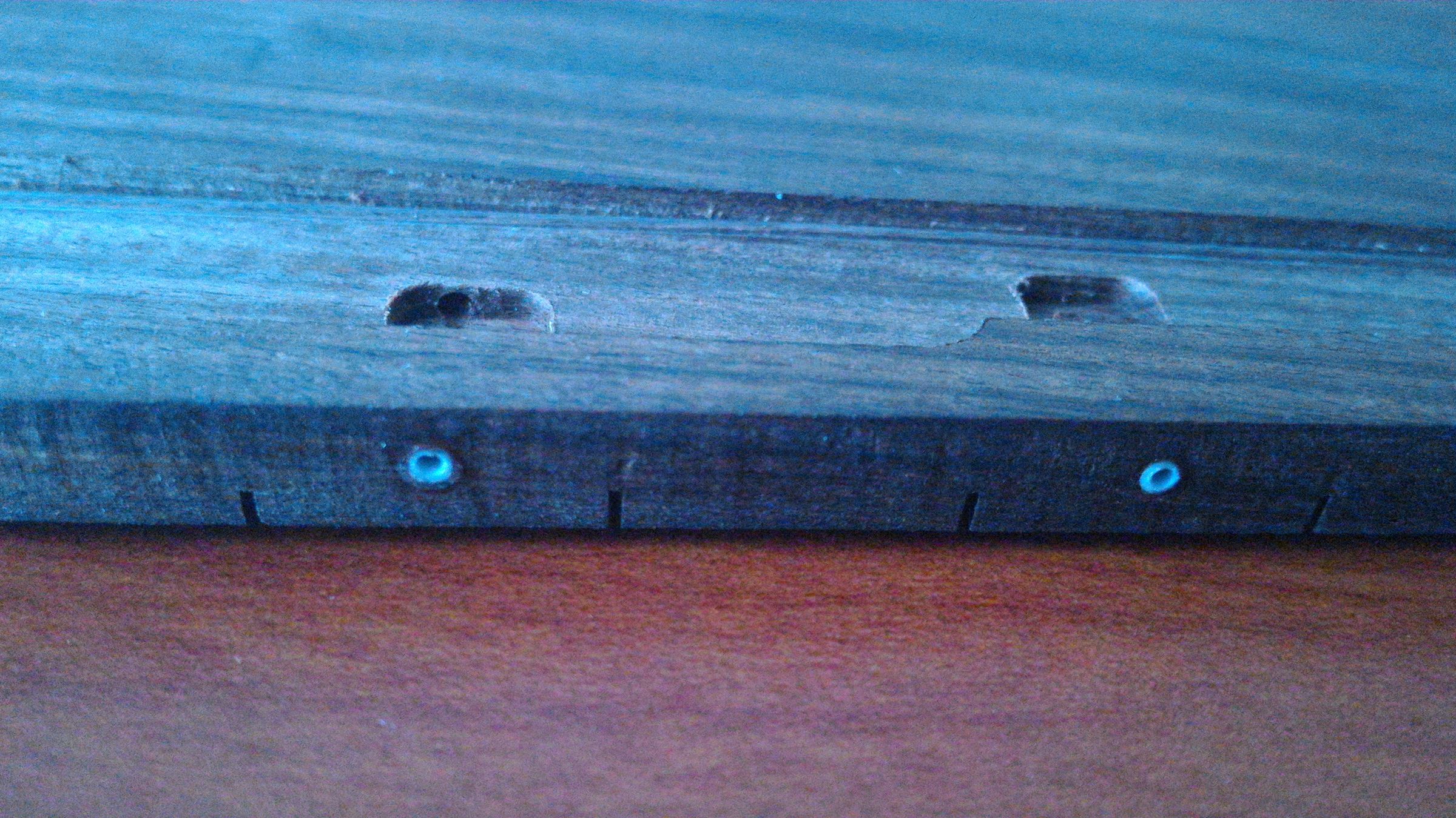

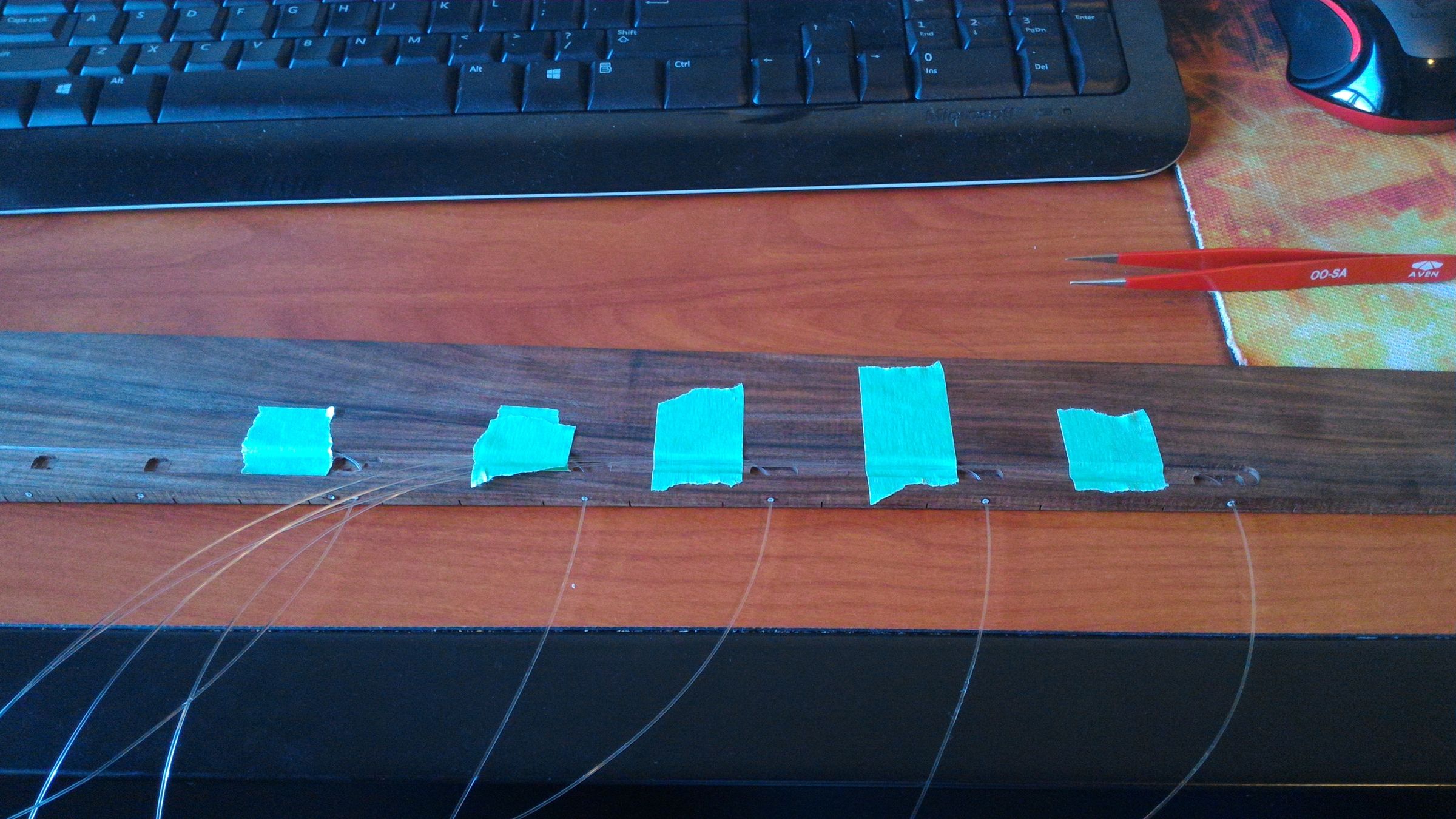

After CNC operations, the fretboard side dot holes are drilled, and side dot material glued in.
For fiber optic side dots, a second hole is drilled in the middle of the side dot material.
The optic fibers are threaded through the holes and epoxied to their respective cutouts. Note that superglue (cyanoacrylate) should NOT be used as it may damage optic fibers. Tape is used to hold the fibers in place temporarily.
After all the optic fibers are trimmed, fill this entire slot with epoxy (this is only partially filled).

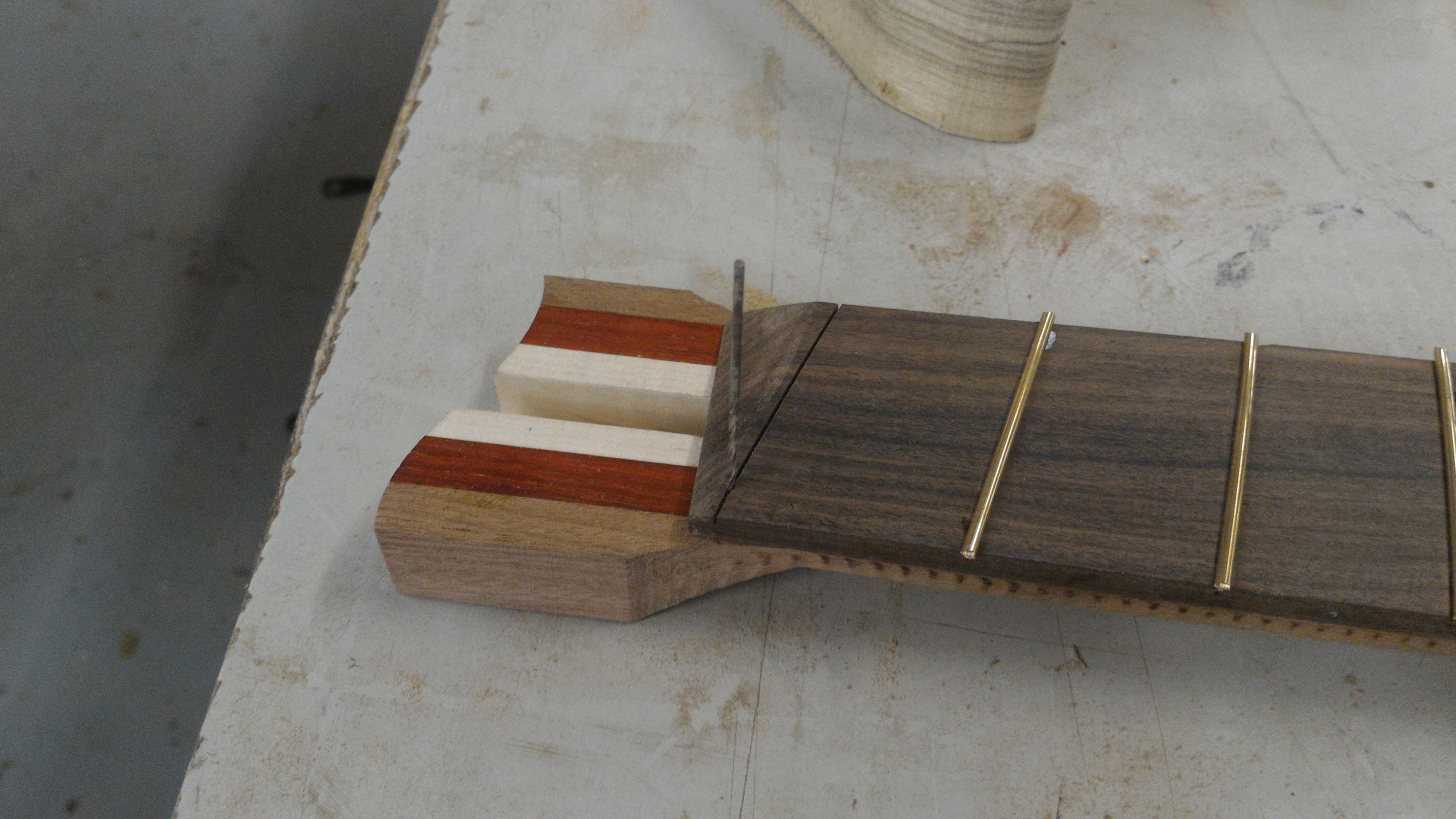

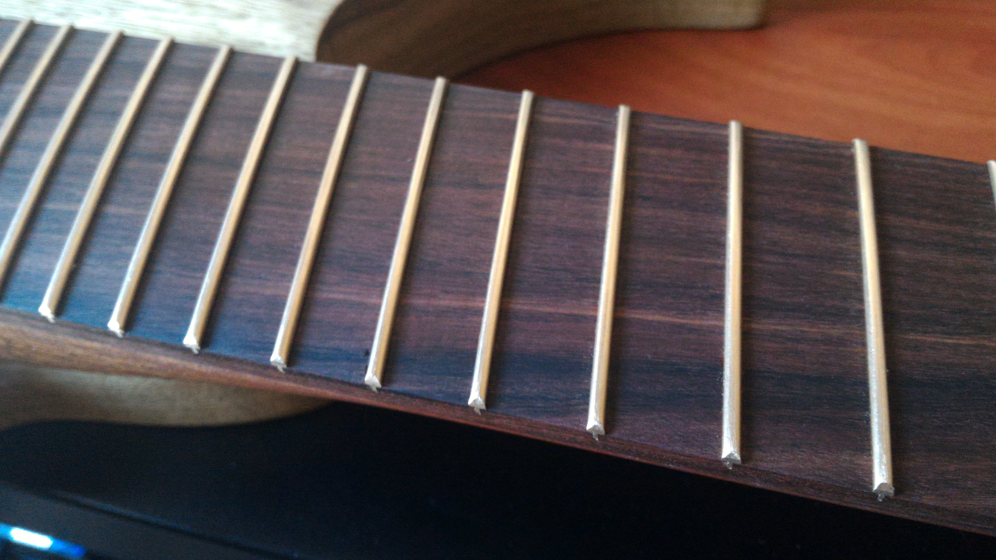

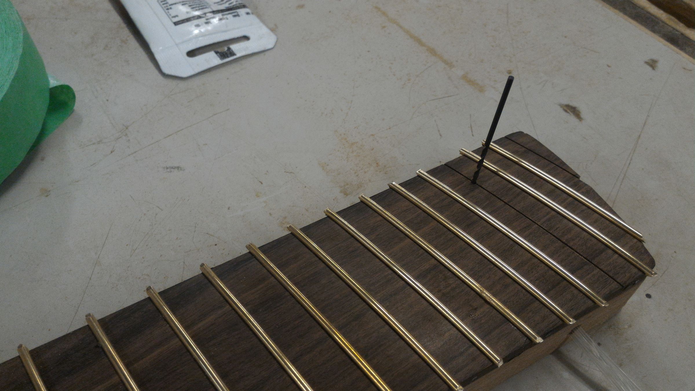

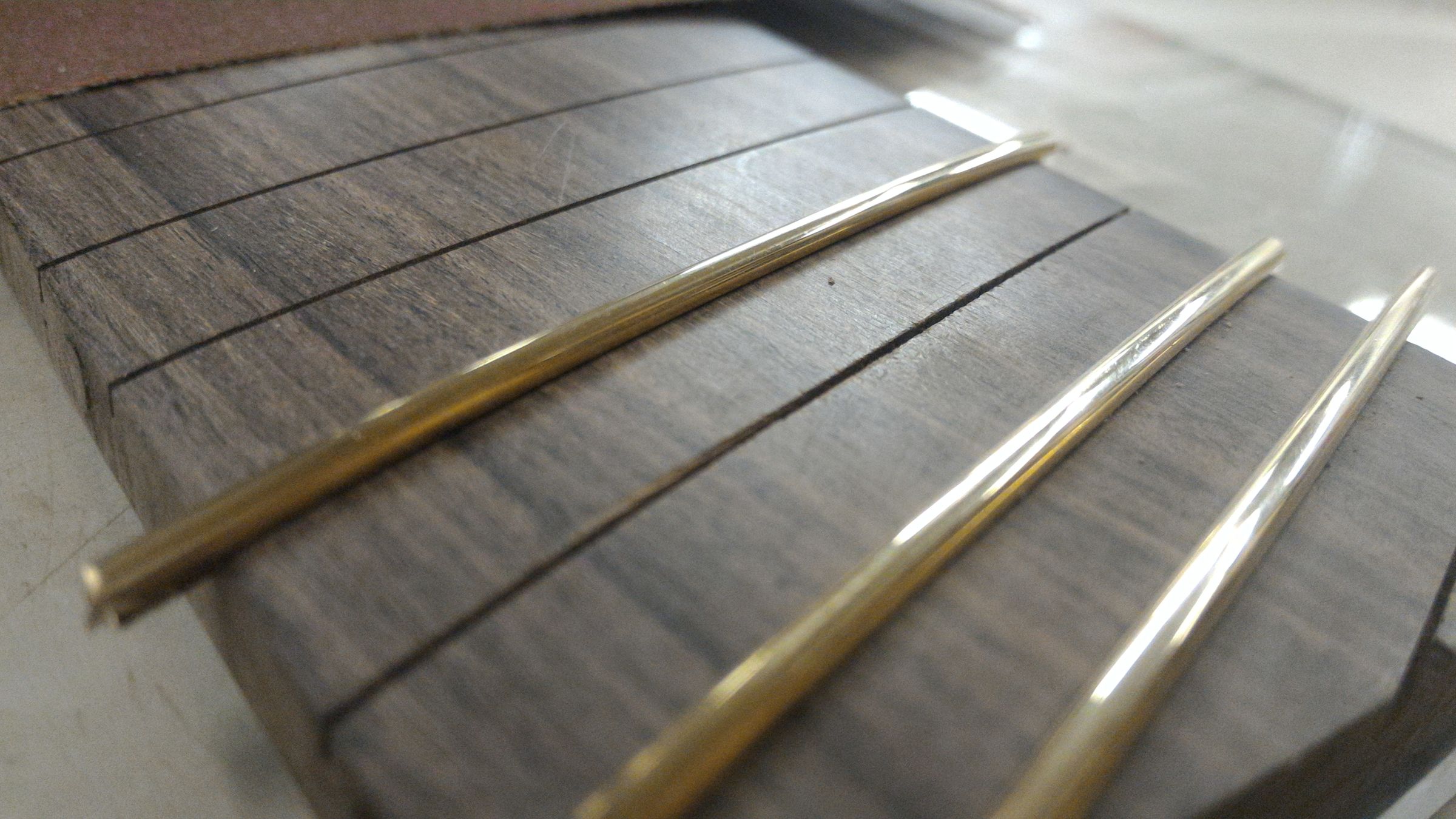

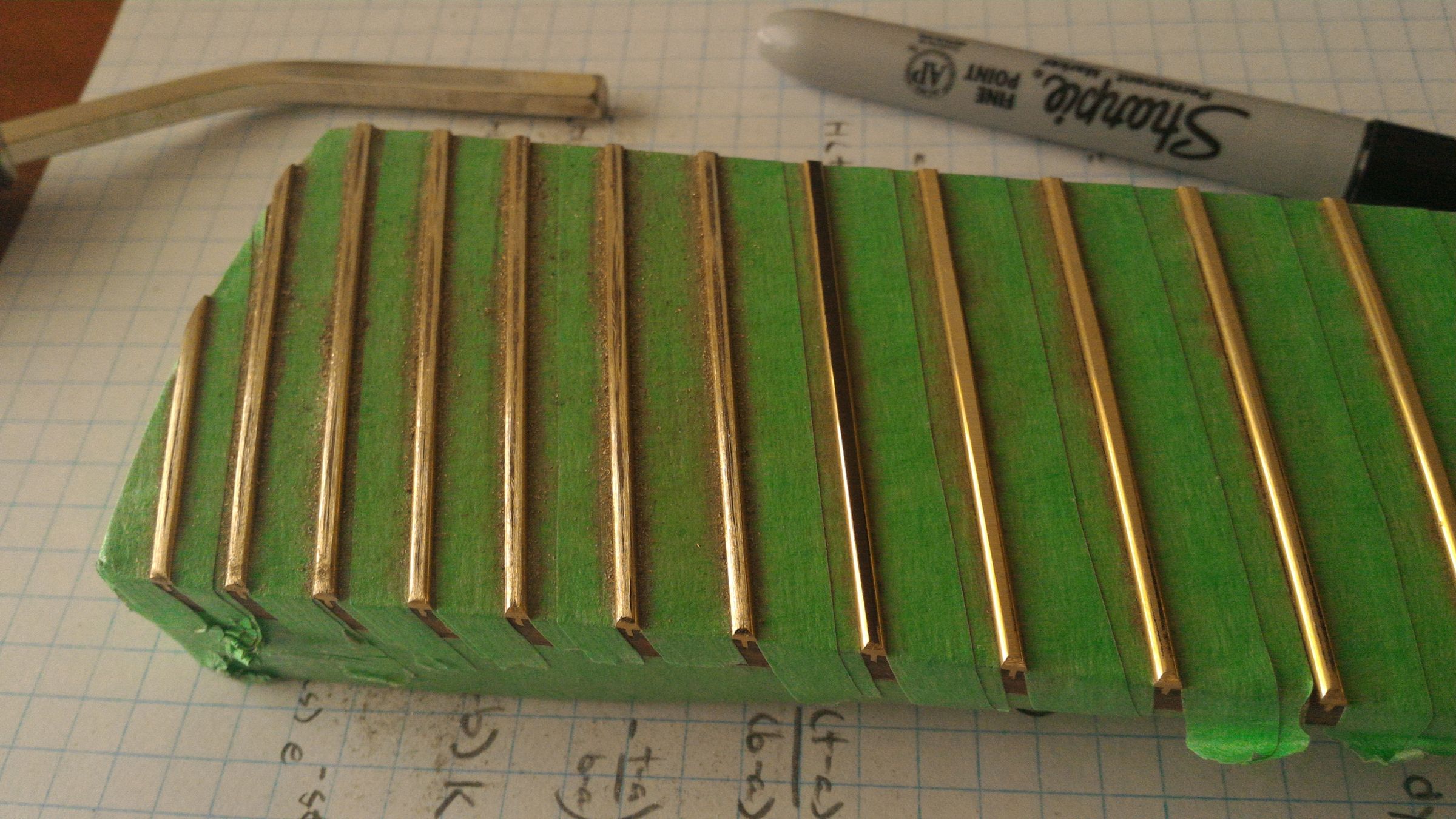

Step 14: Fretting
There are many guides about fretting on the Internet, so I'll keep mine short. I used to press my frets with a vise, but this time I tried the old fashioned hammer.
The fret wire from LMII is pre-radiused. This makes it easier to hammer/press into the slot. Hammer down each end, holding the fret perpendicular to the board. Then, work from the each end of the fret with the hammer to the middle, symmetrically, to prevent the not-hammered end from popping out.
A seated fret.
My zero fret is a taller stainless steel fret to raise the strings slightly higher than the other frets, and also to resist wear. I left the 24th and 0th frets until after I glued on the fretboard to hammer, because my CNC flip was inaccurate and the locating dowels on the back of the fretboard caused much too large of an offset :(

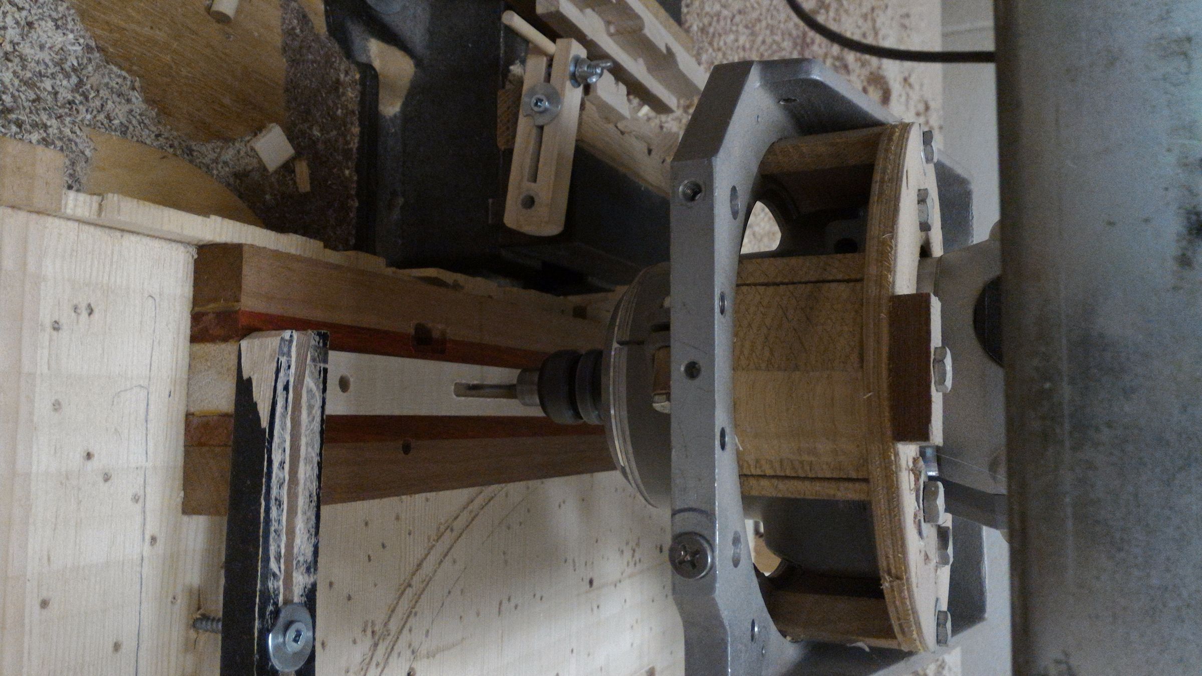

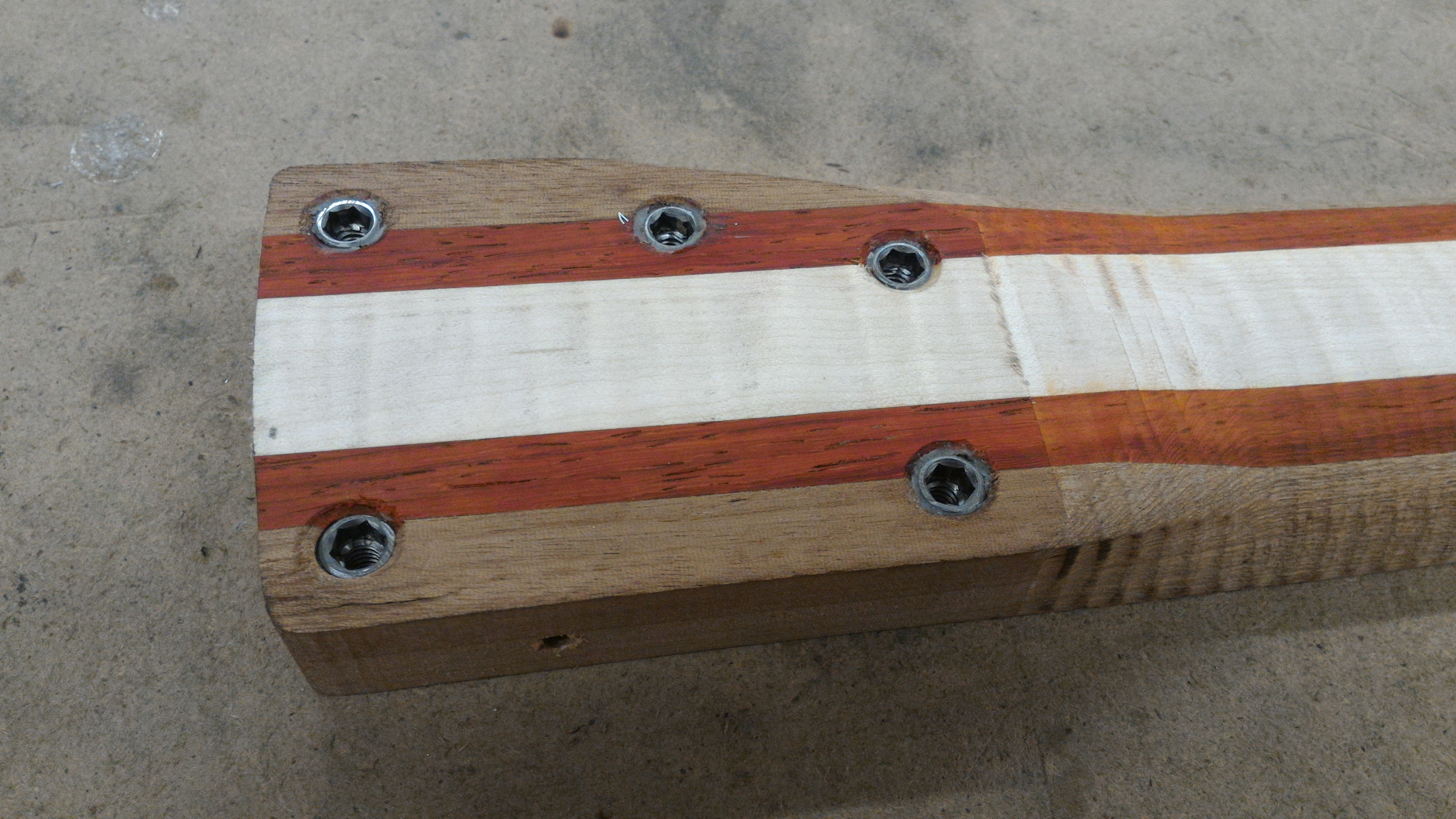

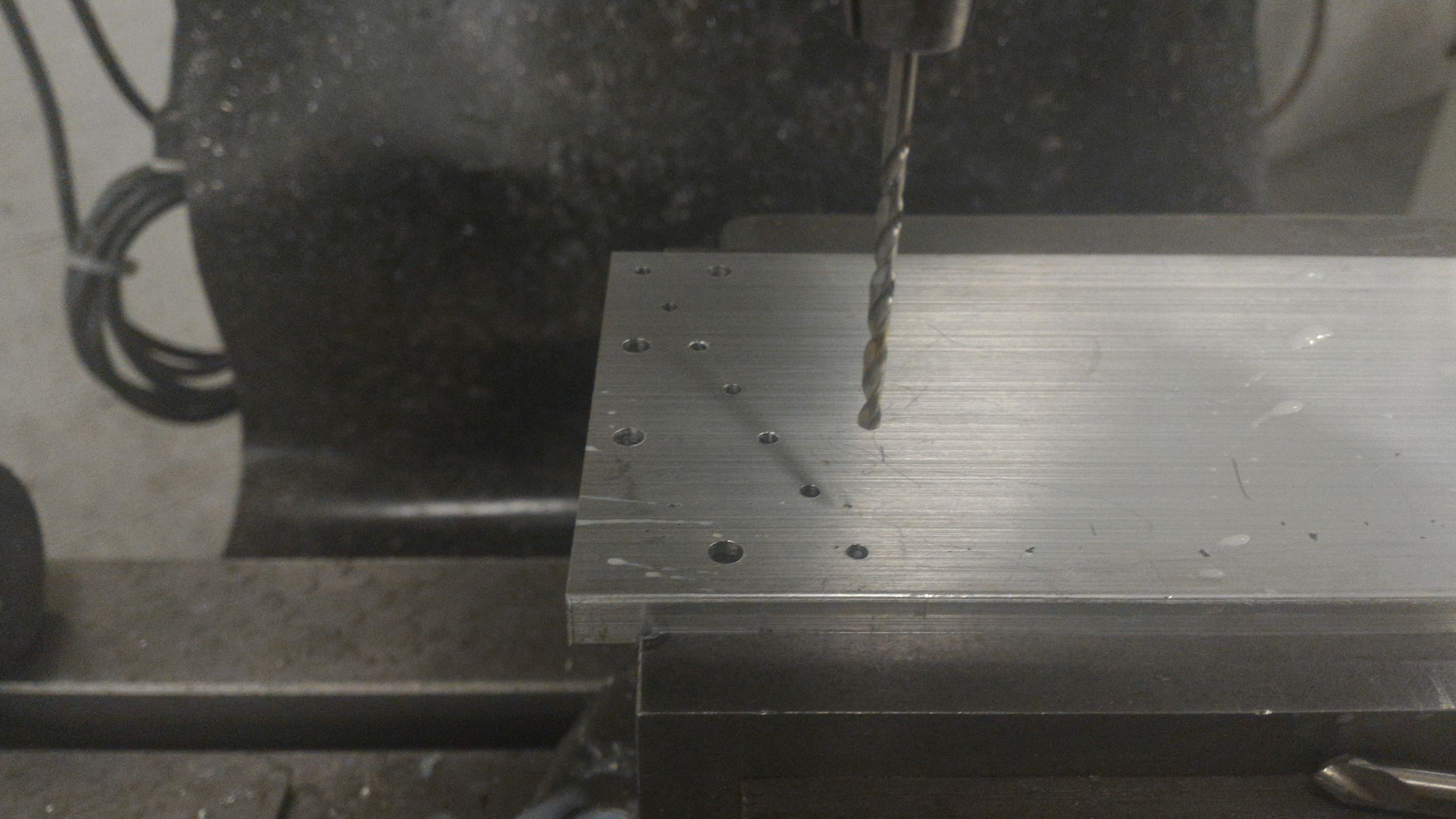

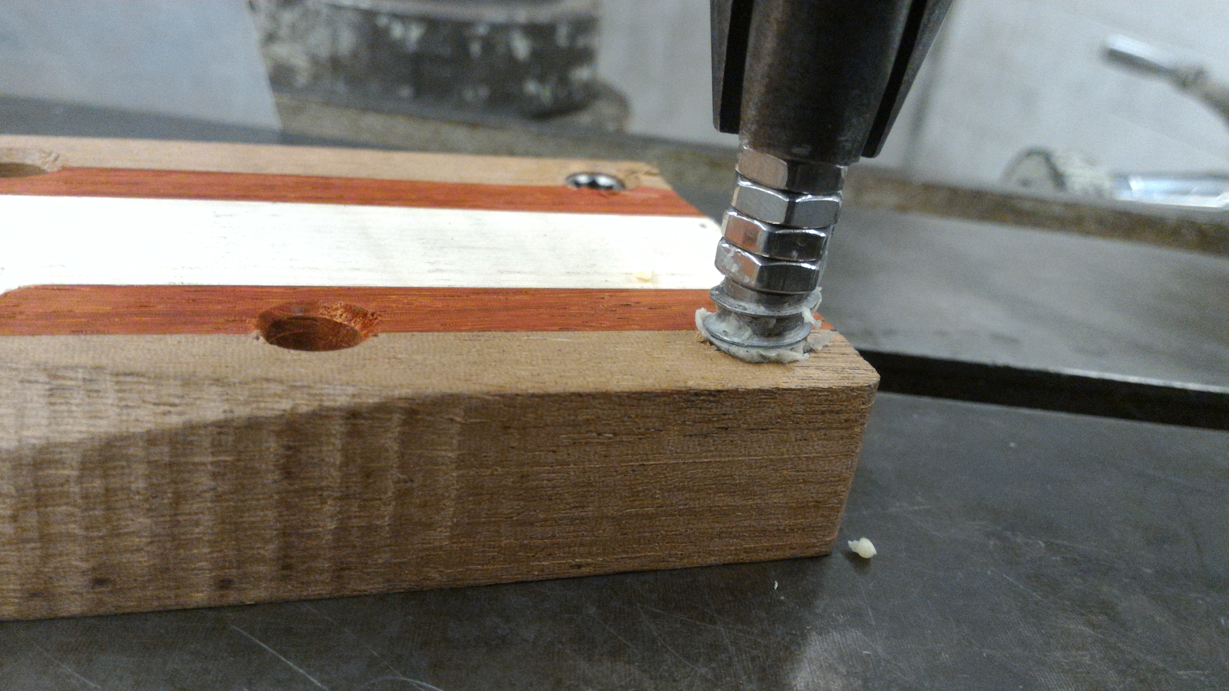

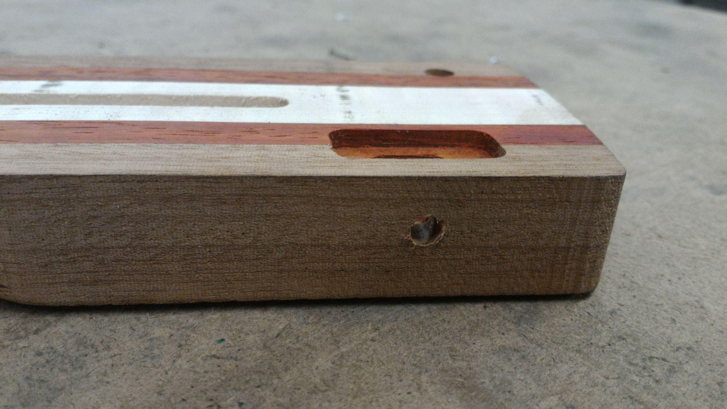

After slightly bevelling the pilot holes for the threaded inserts, I tried to drive in a threaded insert using a screwdriver. Crack! D:

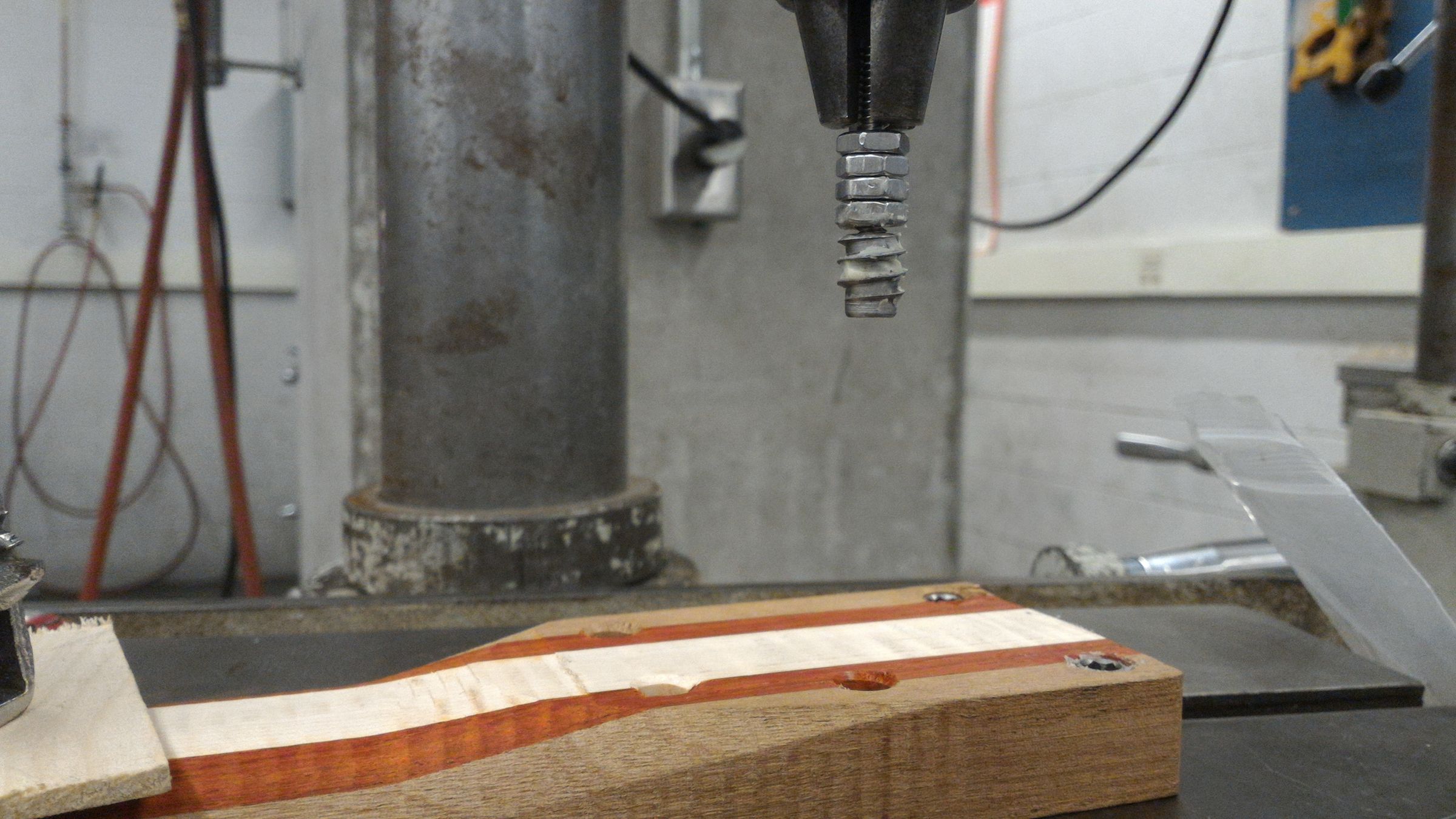

After gluing up the crack, I looked up a method for driving the threaded inserts. It turns out a drill press is quite helpful here.
I cut off the head of a 10-24 machine screw, and threaded on 4 nuts and the insert. The screw is loosely clamped in the drill press so it can still turn, but does not fall out.
The neck is bolted to the table. The drill chuck will hold the insert much more perpendicular than a screw driver. While gently pushing down with the drill press, a hex wrench is used to turn the top two nuts, which will turn the threaded insert, so that it drives into the wood. I used a bit of wax to help it cut.
While on the drill press you can drill the mounting holes for the locking nut (I did this later), with a piece of carpet tape to hold it in place while marking the hole locations. I also drill the exit hole (shown) for the optic fibers.

After gluing, the frets are sanded down flush against the side of the fretboard. Machining marks are removed from the neck using progressively finer sandpaper grits, up to 600.
I used 4 coats of satin Wipe On Polyurethane from Minwax to finish the neck. The fretboard was masked off during this process.
My technique for leveling and crowning frets came from here.
I used a long piece of rectangular aluminum pipe as my leveling bar. In the picture you can see a Sharpie'd fret, some flat frets, and some frets that I have crowned, leaving a faint line of Sharpie in the middle. I then went over and gently filed the top of the fret until the Sharpie was cleaned off.
I used the dual-grit diamond fret file from StewMac. Although it is expensive, for any amount of fretwork it is a worthy investment. The "wide" one is REALLY wide, so a "medium" is more suitable for even jumbo guitar frets.
The edges of the frets are then bevelled and smoothed. The tangs are sanded down until they are smooth.
At the end, I went over the ends of the frets using my crowning file to round them off so they don't feel sharp. Here is a solid guide for finishing fret ends.

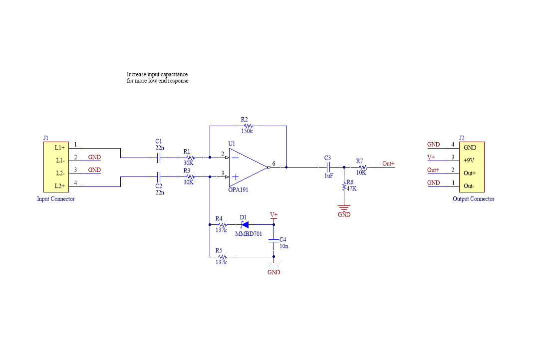

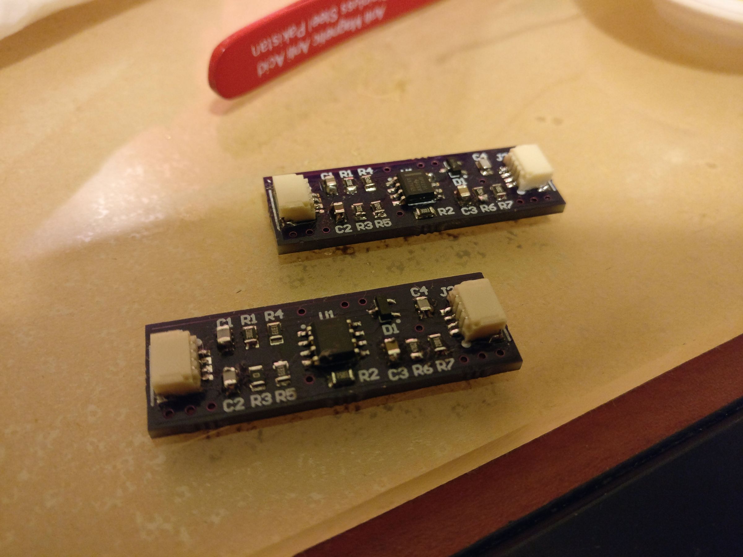

For this project I wound my own pickups and made some active preamp PCBs. I will not go into this in too much detail, but I've attached a few photos of the process.
I used 42AWG wire, 4000 turns on each bobbin. I didn't really have much of a technique, except just keeping the wire as close to perpendicular to the rotating axis of the bobbin, and trying to keep the coil symmetrical. Each end of the magnet wire is then soldered to a standard 4-wire shielded humbucker cable.
Pickup winding is an art and a science and I have way too much to learn before I can really instruct! Feel free to simply use any 7 string pickup here!
The active preamps are based off of the Electrosmash analysis of the EMG81 pickup. The circuit shown above is the neck pickup circuit I am using. I tuned it by replacing the components with the pickup attached (not powered while replacing, of course). This setup gave me the best tone for the neck pickup. The bridge pickup had R2 replaced with 200K and R4/R5 replaced with 400K. This balanced, higher impedance amplifier gave the bridge a brighter and more aggressive tone.
Awesome purple PCBs from OSH Park!
I also milled my own baseplate for the Mera Guitars tuners (cause I'm cheap). All the holes and rounded slots were done on a manual mill.

Then the wiring of the cavity is done based on a typical guitar circuit. I started with a 1-volume 1-tone circuit, before later adding an active tone filter I designed (can do Instructable for this if anyone wants). The diagram will vary depending on the pickup/pot configuration you use. These are commonly available on the Internet.
For active pickups, a stereo jack can be used as a switch for connecting the battery.

The neck can now be bolted in and the guitar strung up. The tuners are locking, so the strings will need to be snipped and screwed down. Pull the strings tight when locking at the nut since the tuners do not have much adjustment range.
After playing for a while and marveling at your work, some adjustments will be needed. The standard setup procedure of truss rod, string height, and intonation are needed. Luckily, we don't have to worry about the nut since the zero fret keeps the strings at a perfect height. The saddles have a spring underneath them, and can be adjusted in height by loosening the set screw. The intonation can be adjusted by moving the tuner forwards/backwards.
