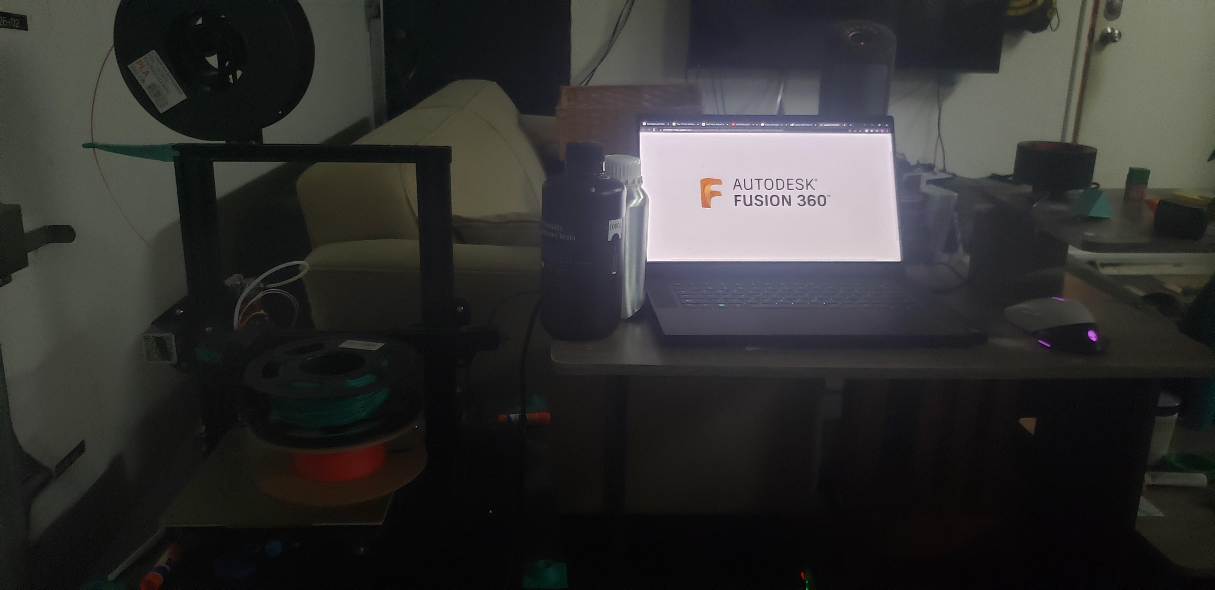

fusion 360. it is free for students or hobbyists, so you should be ok.
Step 1: Fusion
Ok, so this is gonna be a long one, mainly because this will be focusing on how to make your own mechanical models for engineering instead of the more artsy side of 3d printing. personally, this is more the side I fall twoards, so I will be able to give more insight here, but I do highly suggest looking into blender and tutorials if you are trying to get into making your own models
