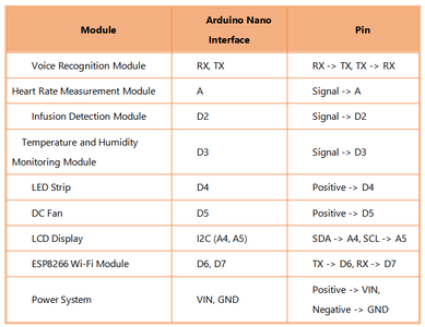

Hardware setup is the foundation for implementing various functions of the smart hospital bed. In this section, we will describe in detail the connection relationships between the main components and draw a wiring diagram to ensure that all modules can work together seamlessly.
  1. Voice Recognition Module: Connected to the Arduino Nano main control board via UART (TX, RX) interface, used to receive and parse voice commands from patients or caregivers.
  2. Heart Rate Measurement Module: Connected to the Arduino Nano main control board via an analog input interface, used for real-time monitoring of the patient's heart rate changes.
  3. Temperature and Humidity Monitoring Module: Connected to the Arduino Nano main control board via a digital input interface, used for real-time monitoring of the room's temperature and humidity.
  4. Environmental Control Module: Includes light and fan control, connected to the Arduino Nano main control board via a digital output interface, used to turn on, off, and adjust lights and fans.
  5. Screen Display Module: Connected to the Arduino Nano main control board via I2C interface, used to display real-time information such as heart rate, infusion status, temperature, and humidity.

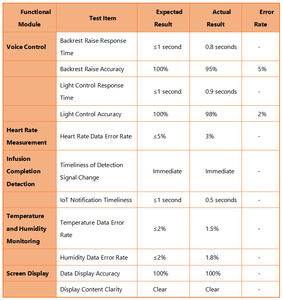

Step 4: Experimental Testing

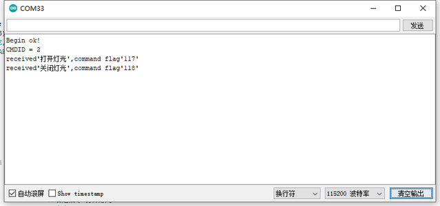

We verified the effectiveness and reliability of each functional module of the smart hospital bed, including voice control, heart rate measurement, infusion completion detection, environmental adjustment, temperature and humidity monitoring, and screen display functions. As seen in the test records, most functional modules worked normally. Voice control, heart rate measurement, infusion completion detection, temperature and humidity monitoring, screen display, and communication systems met the expected outcomes. However, the accuracy of voice control and the data error rate of some sensors still need further optimization.
