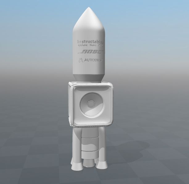

Step 1: Creating Your First Sketch
Let's begin by creating the first sketch. Go to the 'Sketch' dropdown and click 'Create Sketch'. Fusion 360 will now ask you to select a plane or face, select the ground plane. This will change the display to a birds eye view of the sketch. Draw a rectangle using the 'Center Rectangle' tool within the sketch dropdown. The rectangle should have a width of 45mm and a height of 35mm. Hopefully your sketch will look just like mine. Assuming it does, click 'Stop Sketch'.
Step 2: Lofting Your First Sketch
Next we want to loft the sketch to create the first part of our Instructable robot. To do this we need to create one more sketch. Do not worry if this doesn't make a lot of sense at this stage, it will become clearer as we continue.
Go to the 'Construct' dropdown menu and select 'Offset Plane'. Next, click on the rectangle sketch that we just created and set an offset value of 10mm. I have atttached a screenshot of what this should look like. Assuming your screen looks just like mine you can click 'OK'.
We now have a new orange construction plane that we can use to draw a new sketch. Go to the sketch menu and select 'Create Sketch'. Once again we will be asked to select the plane or face that we want to draw the sketch onto. Select the orange construction plane that we just created.
Now, draw a rectangle using the 'Center Rectangle' tool just like we did before. This time give it a width of 50mm and a height of 40mm. Click 'Stop Sketch'.
Fusion 360 will now revert back to the default view and you should see both the sketches that we created positioned 10mm apart.
We can now create a loft between the two sketches.Go to the 'Create' dropdown menu and select 'Loft'. We will now be asked to select our loft inputs. Click on the bottom sketch, then click on the top sketch. This will loft the two sketches together to create the first 3D element of our robot. Click 'OK' and we are ready to move onto the next step.
Step 3: Using the Extrude Tool
Next we need to use the extrude tool to create what essentially will be the belly of our robot.
Go to 'Create' then 'Extrude' and select the top face of our object. Extrude the face by 20mm then click 'OK'. Double check your progress so far with mine and assuming all looks good we can move onto the next step.
Step 4: Completing the Main Body
Now we are going to create another loft to produce the robots upper body. To do this start by creating a new offset plane. Select the top face and offset the plane by 30mm. Click 'OK'.
Next go to 'Sketch' then 'Create Sketch' and use the 'Center Rectangle' tool once more to create a sketch from the very center of our workspace. This time give it a width of 50mm and a height of 25mm. To finish, click 'Stop Sketch'.
Now we can use the loft tool one last time to complete the main body of the robot. Go to 'Create' then 'Loft'. Select the top face first and then select the new sketch that we just created and click 'OK'. Check your results so far against mine before moving onto the next step.
