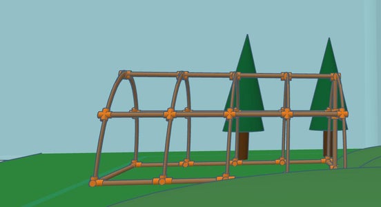

Step 2: Developing the Structure and Frame
The framework is split into smaller parts for easier transport, which is ideal as it's compact and allows cargo trucks and planes to easily transport it.
It can be assembled easily and quickly, with minimal equipment needed, which is essential in a war zone. It is still strong and durable, and has a sturdy frame and good insulation.
Light weight steel frames
Horizontal poles for stability, these poles are in sets of 2 for easier transport.

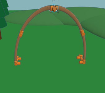

Every arch is in 4 different sections so it is easier to transport 4m Poles slot into clamps and are fixed and screwed in place with to sets of screws for added stability and to make sure they are tightly held in place.
Every sleeve has a hook attached
facing the inside, this connects to an insulated and waterproof tarp.
Arch sections are bolted in a clamp but the horizontal pole slides through but is screwed in tighter
Diagonal bracing made of steel to add extra support and better stability to the frame, slots into a smaller sleeve and held in place by a screw

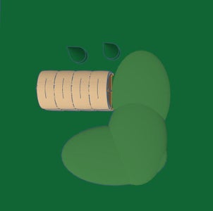

I was inspired by bamboo blinds to use a rolling up bamboo mechanism for the front and back. I wanted to continue to use bamboo as the main material, and I wasn't sure how I could encorperate it to the front and back walls, as it is an awkward shape and I wanted to keep my structure small and compact, and easy to transport. This bamboo mechanism is perfect as it can be cut into the shape of the arch, and can be rolled up so it is still compact. For the front a section would be cut out so that it is separate from the rest of the bamboo rods, so that it can roll up and act as an entryway, however when Let down it is the same as the rest of the bamboo wall.

To create a visualisation, I built a model in Tinkercad. I chose Tinkercad as it is really easy to use. Although it is aimed at simple 3d model making it can be used effectively to produce an architectural visualisation.
The 'background' was created using a large flattened box coloured green. This was grouped with some flattened and stretched half spheres. The tree was created with a cylinder and 2 cones. The sky is a wide and tall box coloured light blue.
I constructed the shelter as shown in the drawings above. A doughnut shape was formatted and cut in half (by grouping with a 'void') to make the arches. The other supports are made from cylinders and groups of cylinders. Finally I modelled the roofing panels using the tube tool. I duplicated the elements to generate the finished structure
