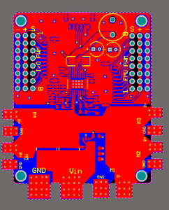

Step 3: Design of the PCB With Altium Designer
In this step the routing of the pcb will be done.

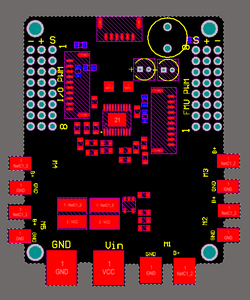

First what has to be done is placing the components and defining the board shape. In this case two different areas will be made, the DCDC and connectors, and the power zone.

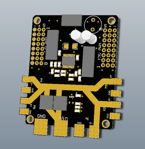

In the power zone the pads are out of the board so that some heat-shrink tube can be used after soldering and the connection remains well protected.

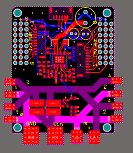

Once that is done, next is the routing of the components, to do that the two layers are used efficiently and bigger traces are used in the power connections. And remember, no right angles in the traces!

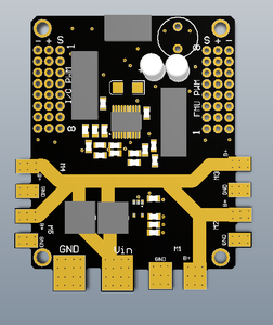

Once the routing is done and not before, the polygons are applied, here there will be a GND polygon on the bottom layer and another one on the top layer but just covering the DCDC and connectors zone. The power zone of the top layer will be used for the voltage input as shown in the third image.

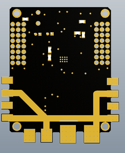

Finally, this board couldn't handle the 200A it's designed for, so some zones of the polygon will be exposed without silkscreen, as seen in the last two images, so that some uncovered wire is soldered there and then the amount of current that can go through the board is more than enough to fulfill our requirements.
