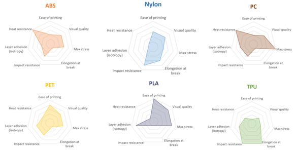

Most parts can be replaced or repaired using regular PLA but other materials could be considered if:
- Your design could include snap-fits, in which case ABS may be beneficial, since it has lower stiffness.
- If the part you are designing should be flexible, you could also consider using TPU.
Please note that both ABS and TPU require specific conditions for good printing results. Lastly, if you want to use multiple materials in one print/part, keep in mind that different types of filament sometimes cannot be combined in the same print, since some materials will not adhere to each other.
Check whether the materials you want to use can be printed on top of each other here.
Depending on what the product comes into contact with, different factors need to be considered. If the part comes into great contact with heat and corrosive liquids, 3D printing is likely to not be suitable.

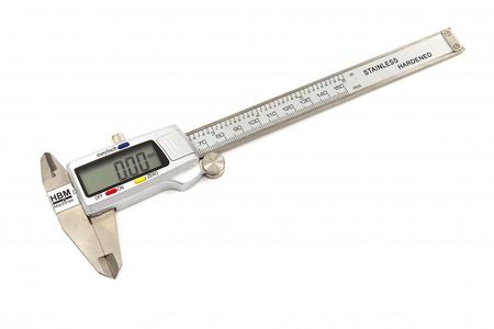

Depending on the shape of your part you may require a variety of measuring tools. We recommend a set of (digital) callipers for accuracy, however other measuring tools like rulers or protractors may be helpful as well.
Sometimes parts can be hard to measure with standard measuring tools, but not all hope is lost, since 3D printing allows you to create your own measuring tools, see step 2-4 of this guide.
At last there is also the option to use 3D scanning, but we advise to only do that if you have no other choice because it is less accurate and requires additional software and processing. (This instructable goes into detail of the 3D scanning process.)
