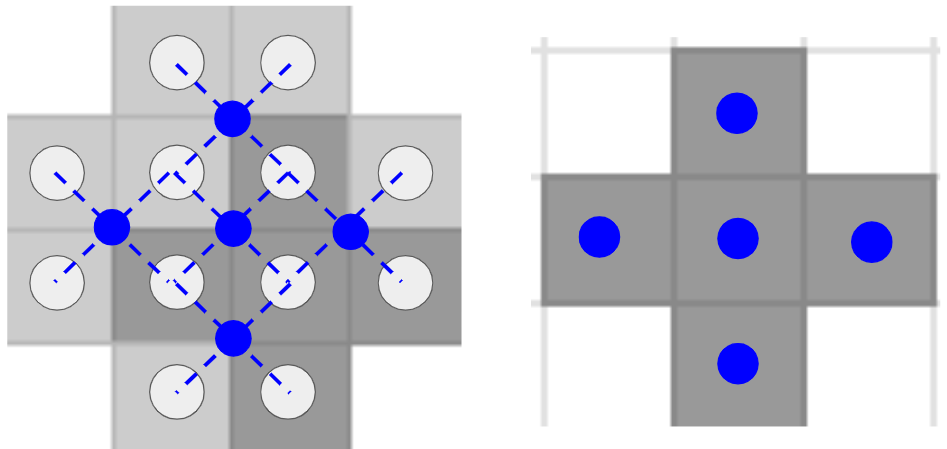

Once you're finished with your base design, we will need to edit it to make it stitchable. This spreadsheet will be used in order to output a table of XY coordinates for where holes need to be made in the canvas in order to be able to stitch the design. Notice the discrepancy though: each cell in the design represents a stitch, but what we need are XY coordinates for holes. We can't just put a hole where the cell is shaded (like picture below) and be able to stitch it.
Needle goes in and then... no color?
Instead, we need at least four holes to make a single stitch. You make the cross in cross stitch and that cross becomes your dot of color.
If you follow that logic, it means that to make a single dot of color, you will need four holes total. You can think of it as making sure you have 3 extra holes (north, west, and north west light grey holes next to the dark grey original hole). Here's an example: let's say you want to make a cross shape like shown below.
Starting with the top dot of color, we need to make sure we have 3 extra holes to make it. Shown below, to make the dark red cell, we need to add holes in the light red spots. The black outline box shows which four holes would make that dark red cell.
For the next dot of color, again we need to make sure we have 3 extra holes to make it. Shown below, to make the dark orange cell, we need to add holes in the light orange spots. Notice that there is overlap of one light red cell previously and one of the light orange spots.
To make the dark yellow cell, we need to add a new hole in the light yellow cell. Notice that there is overlap of the "four holes rule" with a dark orange and a dark gray cell - those are already accounted for - but there is a new light yellow cell added.
To make the dark green cell, we need holes in the spots enclosed by the black outlined box again. All of those cells already are shaded though so the holes are accounted for.
For the final dark blue cell, we need to add a hole in the spot shown in light blue. Two holes, the dark red and dark green, have already been accounted for.
To recap, in order to stitch the dark grey cross pattern, we need to add holes shown in the light grey cells below.
To spell this out, this is what the stitching would look like. Holes in the light grey and dark grey cells would be stitched together as shown with the dotted blue lines, to make dots of colors corresponding to the desired cross shape. Generally, the rule of thumb is to add a cell above every top-most cell in your pattern and add a cell to the left of every left-most cell. Make sure that each cell in your pattern has a total of 4 holes to make the corresponding cross stitch.

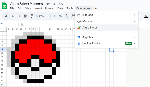

Step 2: Script for Outputting XY Coordinates of Pattern
ChatGPT was extremely helpful for generating a script to output XY coordinates based on the Google Sheet patterns, and the final script is pasted below. What it does is:
  1. Scans the last active Google sheet your account accessed
  2. Collects row # and column # for cells that are shaded. Only looks at background color and ignores whether a cell has content
  3. Outputs scaled row # *2 and column # *2 in a text file
  4. The 2 is the spacing between holes for a roughly 14ct canvas (2mm). I say roughly because this is a little bigger than 14ct canvas; I couldn't go smaller or else my canvases were too delicate and broke easily.
Here are notes on parts to edit in the script:
  1. There are constants "rowScaled" and "colScaled" where the row # and column # are multiplied by 2, meaning 2mm. You can change that constant based on what spacing you'd like for the holes though, so if you want to use more thicker thread you'd want to increase the spacing.
  2. The line that starts with DriveApp.createFile has a location for the name of the txt file. Update this based on what the design and spacing are, so you don't get multiple text files with the same name.
Final script:

Step 3: Using Apps Script
To use the script, go to your pattern spreadsheet and go to Extensions > Apps Script. You'll open the project editor page where you can click the + sign to make a Script and then you can paste the script from the previous step. Some security access popups will come up which you can breeze through before you press Run. The .txt file will then output to your Google Drive! Don't forget to change the file name line so that you don't end up with same named txt files.
I ran into this error message "Exception: Cannot call SpreadsheetApp.getUi() from this context." occasionally so if you do to, just reload the google sheet and go to Extension > Apps Script to reopen your code from that sheet. See details here.

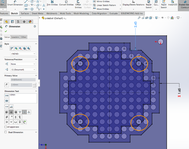

Step 4: Designing the Canvas: Table Driven Pattern
The steps in the pictures above walk you through how I did the table driven pattern in SolidWorks. There should be similar functions in pretty much any other CAD program you use. The notes in each picture are copied below for reference.
  1. I started by making a large 70x70mm square and adding a Ø1.5mm circle. The 1.5mm hole is driven by global variables "holeSize" and distance - see left.
  2. I made two variables: distance and holeSize. This way I could scale my hole sizes and outline accordingly if I were to change my thread thickness. HoleSize is exacty that; the diameter of the holes. Distance is 1.1*holeSize (hence 1.65) and is the distance from the outer edge of the canvas to the closest hole (will make sense later). I dimensioned the hole 1.65mm from the top and left edges.
  3. The pattern in question is just a circular hole. I made the holes circular instead of square thinking that it would help the printer do smoother motions instead of choppy lines, plus I figured the squares might break more easily due to stress concentration at the corners.
  4. Using that sketch, I extruded the square (1mm thickness) and cut out the circle. Note that I did the circle cut as a dedicated cut feature; that way I could select cutting out the circle as a patterned feature.

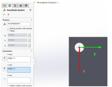

  5. Go to Reference Geometry > Coordinate System and create a coordinate system. I made it from the center of the circle but it doesn't really matter; that's a legacy decision from something I was trying. Using the top left corner of the square is fine too.
  6. Now to generate a table driven pattern. Use the coordinate system from the previous step and the circle extruded cut as the feature to pattern. Browse to the .txt file generated from the Google Sheet and import that as your XY coordinates. Now you have the pattern of holes to stitch through!
  7. Now that you've cut out all the holes, you need to cut the outline. I made the outer edges 1.65mm from the closest hole (global variable "distance" shown in step 1). To do this quickly, I drew the outline and then drew perpendicular construction lines from each line segment to the closest hole. Then I selected all the construction lines, made them equal length to each other, and dimensioned one of them (and thus all) "distance" in length. See next step for the 2.43mm offset inner lines and orange circled parts - that's for the backing so you don't need to do that now.
  8. Fillet all corners and now you're done with the cross stitch canvas model!

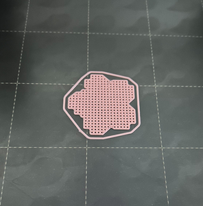

Step 10: Printing Tips
At this point I had the files and finally sent them to my printer thinking that was the end of it. Of course I jinxed myself and all I got was an mess of extrusions dragging with my nozzle. Printing the tiny holes was unsurprisingly difficult for the printer to do since they were so small and thus printed so fast.
Main tips to get the best fidelity of the printed canvases:
  1. Slow down your speeds
  2. 100% infill
  3. Enable ironing for the canvas that you'll stitch on (not necessary for backing)
  4. Dry your filament
  5. Tune retraction settings
I had to turn down my printing speeds in order to print the holes properly, dropping them down from standard 60-80mm/s to 15mm/s. This is only for extrusion/print moves - I didn't change travel speeds. See below for what it looked like in PrusaSlicer.
Because the canvas is riddle with holes, there's no point in decreasing infill so keep it at 100% to make it as solid and strong as possible. To better fuse the extrusions together, turn on ironing too.
Stringing comes up inevitably due to the tiny holes. Drying filament helps with minimizing stringing so highly recommend that. Tuning retraction settings also helps, but what I'll say is that I still had slight stringing despite having recently re-tuned retraction. As long as you can push a needle through your holes, a little bit of stringing isn't a concern.
