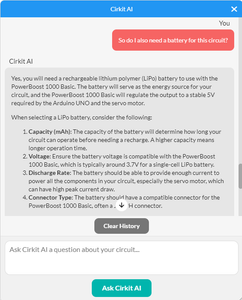

I’m not familiar with the PowerBoost 1000, so I asked the AI to clarify why it chose that part. Cirkit AI explains that the PowerBoost will draw power from a battery and output a stable 5V for the circuit.
From that explanation, it is clear that I also need a battery in my circuit, so I ask Cirkit AI to find me a battery.

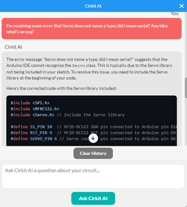

I add this code to the IDE inside Cirkit Designer, and attempt to compile, but I receive a nasty warning:
Step 11: Compilation Error
Yet again, Cirkit AI is here to help.
It tells me that I’m missing an include for the Servo library. After I add this include, the code is compiling!
