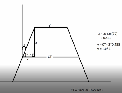

Illusion, we are still at the second step, I just split it because I thought it was already too big. Okay, now we already have our three circles so now let's make the tooth geometry. From the figure, you may see that the gear tooth has two different thicknesses. One at the very top and another at the pitch circle, so the thickness at the pitch circle can be obtained using the formula 1.5708*module. In our case, it would be 1.9635 mm.
We need to do some trigonometry for the top thickness, but believe me, it is not that hard. Okay, so as shown in the diagram (where a is the length of addendum), the upper thickness can be deduced easily if we just have to subtract 2 times the x length from circular thickness, and in our case, it will be 1.054 mm.

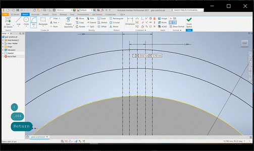

So now we are done with the paperwork, the next step is to design it in CAD. Well, this part is pretty easy, if you know how to use any CAD software. It is basically just drawing circles and extrude. The only tricky part which I can think of is to draw the tooth geometry, and for the tooth, geometry I have used 3 point arc as shown in the gif. However, I have attached the video in which I have shown all the steps and how to design it in CAD you can refer to it and now our gear is ready for the print.
