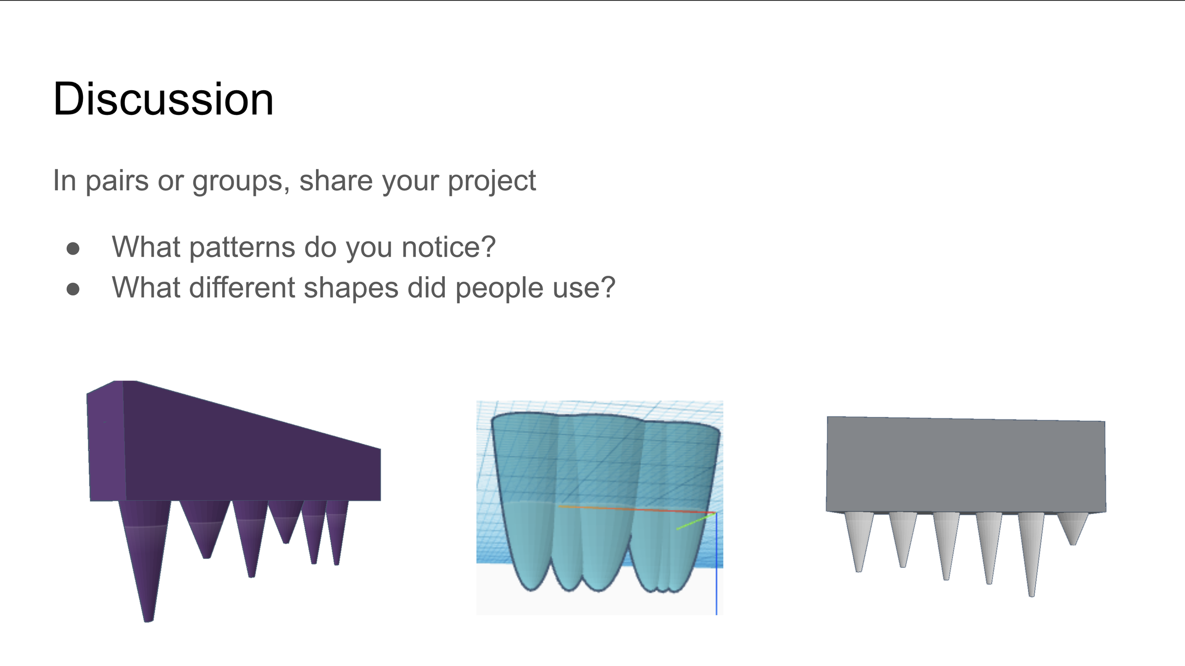

With this exercise, students use shapes and math to make icicle-like structures. Encourage students to read this article and think about how math shapes the formation of icicles.

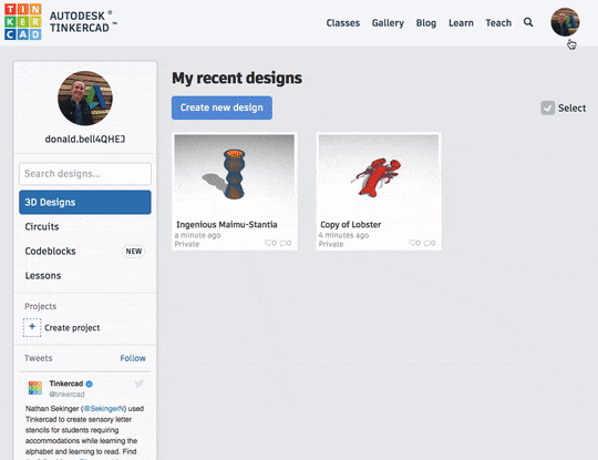

Step 5: Log Into Tinkercad and Introduce the Kind of Design That Will Be Created
Once students are logged in, they can choose Codeblocks from below their profile image on their main homepage. On the next screen, they should choose "New Design."
Log in to Codeblocks!

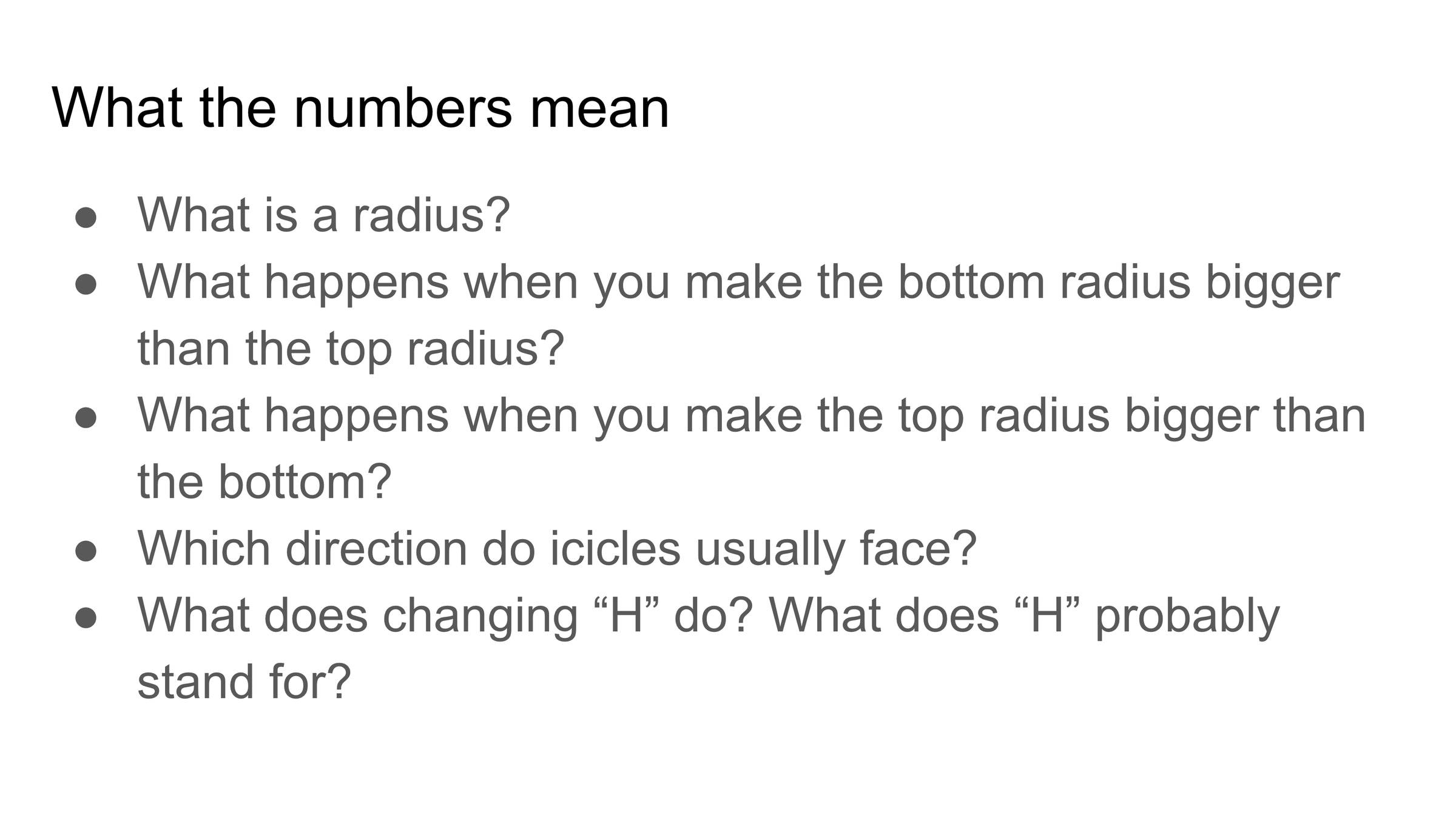

Note the names of the parameters on the paraboloid. “Radius” means the length from the outside of a circle to its center. What happens when you increase the radius? Decrease it? Have students play with each of the available parameters.
As you're walking around the classroom, consider asking students some of the following questions.
Note the names of the parameters on the cone.
- What is a radius? A: The distance from the center of the circle to its edge.
- What happens when you make the bottom radius bigger than the top radius? A: The cone points up.
- What happens when you make the top radius bigger than the bottom? A: The cones point down.
- Which direction do icicles usually face? A: Down.
- What does changing “H” do? A: Changes the height of the cone.

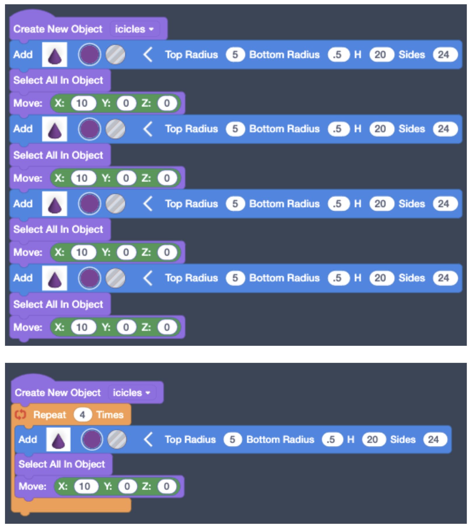

Step 10: Adding a Loop
There are a lot of constructs in Computer Science that make it easier to write code in a shorter amount of time, to use patterns to the programmers advantage. One of these constructs is known as a loop. In Tinkercad Codeblocks, we’ll use the repeat block as our loop.
Show the students the long, 12 block code. In this 12 blocks of code, the same 3 blocks the students have already learned repeat 4 times. Help them find that pattern.
Patterns
Do you see a pattern in this code?
Show the students what code looks like without a loop (12 blocks long) and what it looks like with a loop (4 blocks long). This is the power of repeat loops. The code is easier to read and shorter to create, yet it does the exact same thing.
Loops
Look at these two versions of code. They do the same thing!
Which one would you rather write?
Loops

Have a conversation with students about useful feedback. Ask them what kinds of comments they think are kind, what kinds of comments they would like to receive on their own work, etc. From there, build guidelines around what they should say to each other.
After the students have done their gallery walk, give them some time to read their feedback, and then reflect as a class on how feedback felt.
