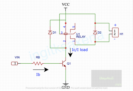

Step 1: Understanding Schematic
I decided to use a NPN BJT so as to be able to perform low side switching. In this case, the input or the driving signal to the BJT will be fed from pin labelled as Vin. We would strive to drive the BJT in the saturation region which is achieved by driving the Base-Emitter region into a forward biased state. When forward biased, the Vbe will be 0.7V.
Under saturation state, all the charge carrier available in the BJT will be contributing in conducting the current through the Collector-Emitter path.
In the schematic, we will select a suitable base resistor which will drive the BJT into saturation region when a signal is applied to Vin. This will cause the BJT to work as a closed path between Collector and Emitter terminals with Vce equal to 0V (almost). Hence, the relay coil will find itself connected directly between supply voltage and ground causing it to turn on.

Step 6: Full Video Link
The link to my channel where I have shared detailed steps on creating this circuit
Step 7: Additional Items
In my case, I am planning to use the relay to drive another inductive DC load. For this reason, I will attach another freewheeling diode to the relay output (driven) terminals (N.O. terminal in my case). Updated schematic will look like this.
