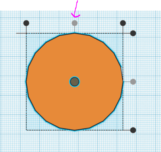

Step 3: Adding a Hole in the Middle

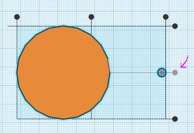

Step A: Drag-and-drop a cylinder hole onto your Workplane.
Step B: Set the hole's diameter.
If you are using Robocamp kit, it is designed to use M4 bolts. This means that hole must be big enough for a bolt 4mm in diameter.
Your hole needs to be larger than 4mm, to allow the bolt to pass through it, but not too large, or the bolt will move around too much!
We suggest a hole of 4.2mm in diameter, but depending on the material you use you may need to change it after your first prototype.
If you are glueing directly onto your motors, measure the diameter of the motor shaft as accurately as you can, and make your hole slightly larger than this.
Some motors have a D-shaped shaft instead of a circular one. You can design a D-shaped hole if you like, to help with the fit, but you will need to test and adjust the fit with a few prototype wheels to get this right.
Step C: Change the number of sides to the maximum amount.

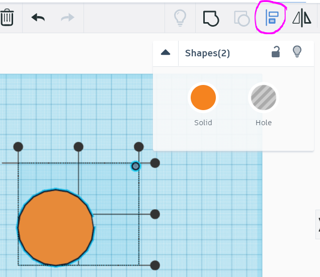

Step D: Select both shapes, and use the align tool to add the hole to the exact centre of your wheel (see below). To make this easier, switch to both Top and Orthographic (flat) view!

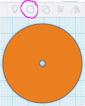

Step E: Group the two shapes together to cut the hole out of your wheel shape.
Well done, you have a basic wheel design!
