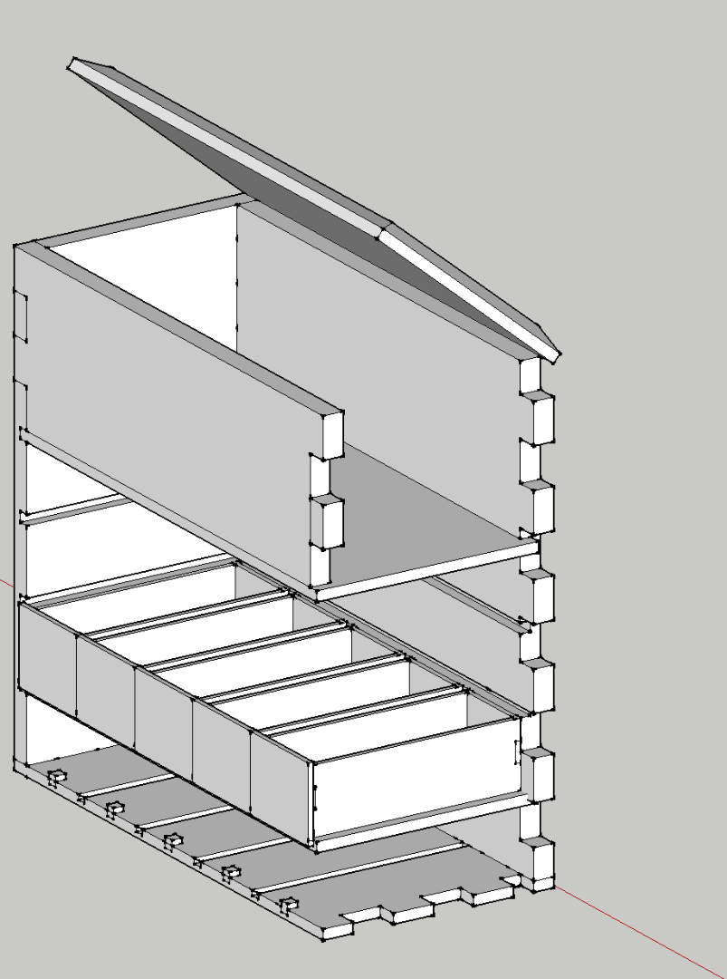

Step 2: Designing the Box

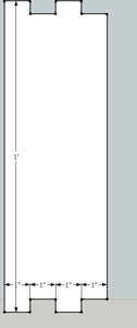

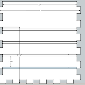

I used sketchup to design the box. I used finger joints because they are pretty.
Step 3: Cutting All the Parts for the Main Box
This was the easy part. Being off by 1/16th on a large piece is nowhere nearly as bad as on those little drawers....

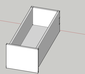

Step 4: Making the Drawers
For the face of the drawers I actually used a single piece and cut it pre-numbered, so that the cuts would line up. The single piece that made the face then had matching grain and the pieces lined up nicely! My issue though was getting it thinner, and without a planer, I used my router and a 2-1/2 inch bottom cutter on many many passes.... without a router table. I in no way suggest this, it was stupidly dangerous.
