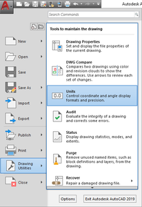

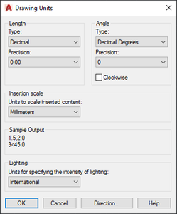

Step 1: Setting Up the Units of Measurement
Please note that all our drawings are in millimeters and the very first activity remains to set up the units of measurement using the "Drawing Utilities & Units" menu.

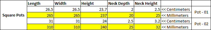

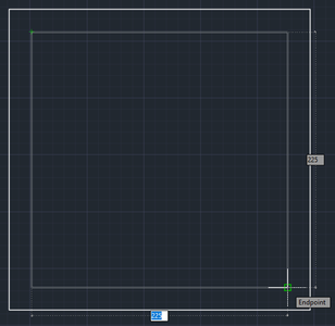

Step 2: Get a Clear Understanding of the Dimensions
  1. Length: 225 mm
  2. Width: 225 mm
  3. Height: 212 mm
  4. Material Thickness 1 mm

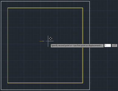

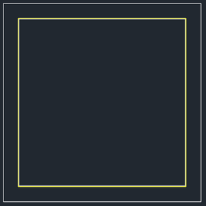

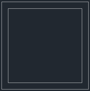

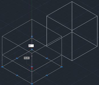

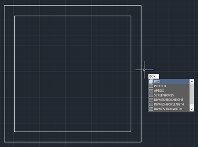

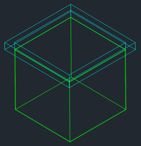

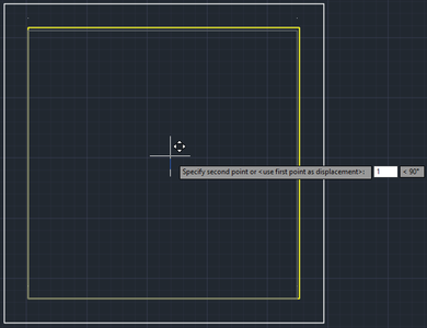

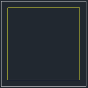

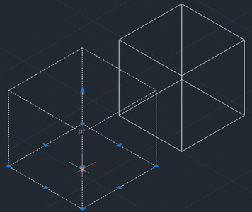

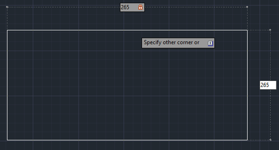

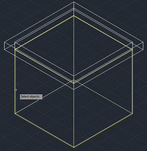

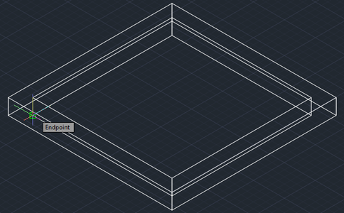

Step 3: Designing Plant Pot Neck Portion

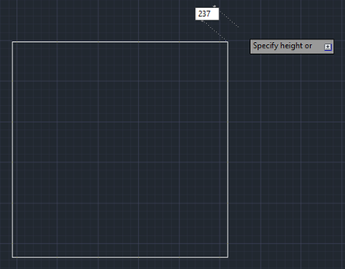

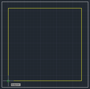

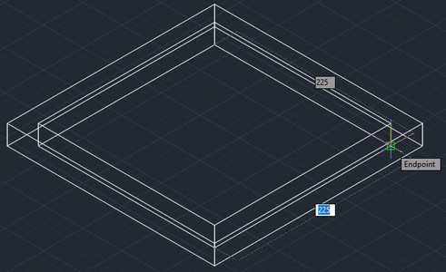

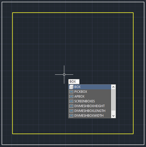

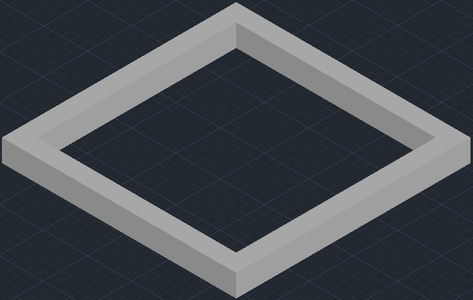

In this step, we will draw two boxes with dimensions:
  1. First Box: 265 mm (Length) x 265 mm (Width) x 25 mm (Height)
  2. Second Box: 225 mm (Length) x 225 mm (Width) x 25 mm (Height)

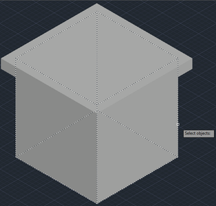

***Note: In the images, the heights of the first and second boxes are mentioned as 237 & 236mm. The reader of this article may please correct this during his/her drawings.

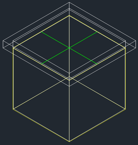

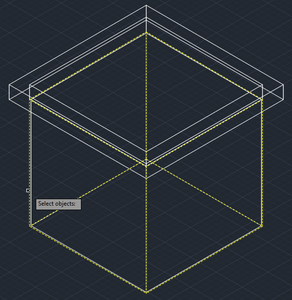

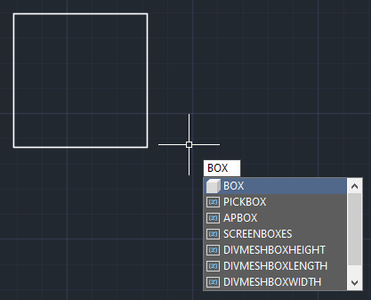

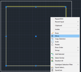

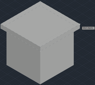

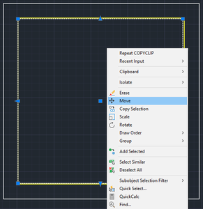

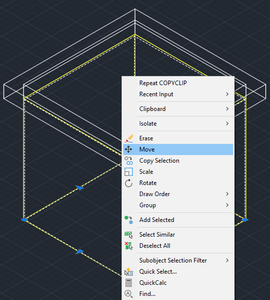

The process used is simple. In designing the neck portion, we will use the following commands:
  1. BOX
  2. VIEW (Preset Views - SW Isometric)

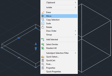

  3. MOVE (To Center Align both the boxes)

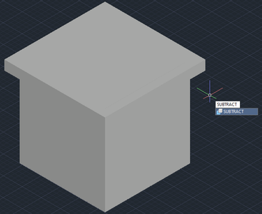

  4. SUBTRACT
The reader of this article is suggested to follow the images shared and complete the step before proceeding any further.

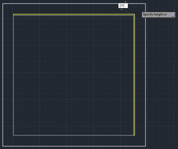

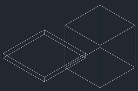

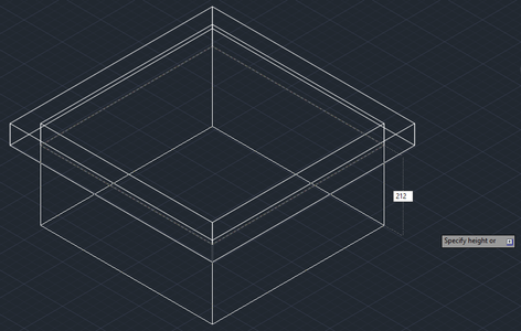

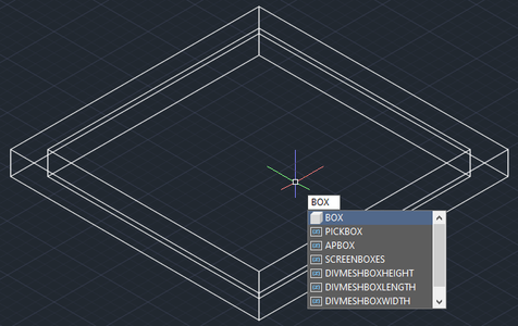

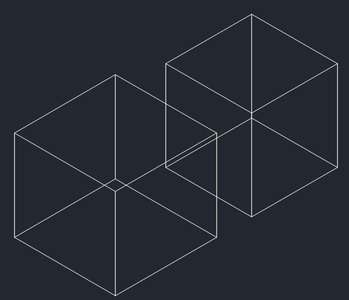

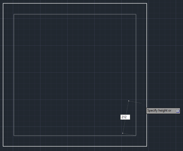

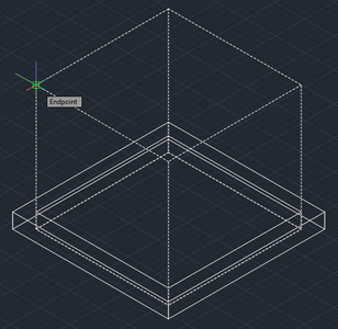

Step 4: Designing Bottom Portion Plant Pot
There are two methods in creating a box and both the methods are described in this section.
  1. Directly in 3D using VIEW (Preset Views - SW Isometric) & BOX commands
  2. From the "2D Wiremesh" view using BOX command directly.
The dimensions of the box that will be created will be: 225 mm (Length) x 225 mm (Width) x 212 mm (Height)
The only difference between both these options is via 3D view one can build the bottom portion in the right direction. Via "2D Wiremesh", the bottom portion built will be aligned towards the top, making the Square pot appear to reverse.

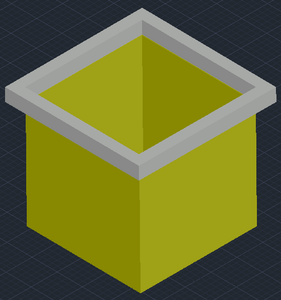

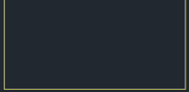

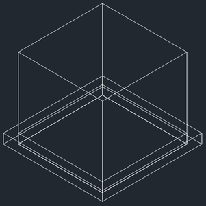

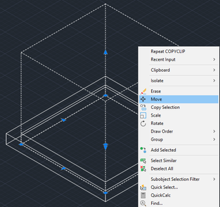

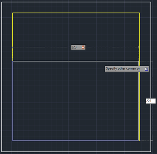

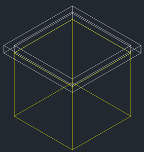

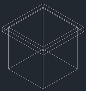

Step 5: Designing Wall Thickness for the Bottom Portion

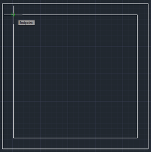

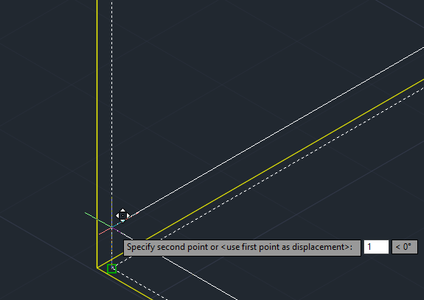

To create a 1 mm thickness wall following are the steps to be considered:
  1. Draw a box that is 2 mm less in length and width and 1 mm less in height.
  2. Dimensions of outer box: 225 mm (Length) x 225 mm (Width) x 212 mm (Height)
  3. DImensions of the inner box: 223 mm (Length) x 223 mm (Width) x 211 mm (Height)
  4. Center the box to the one created in the earlier step.
  5. In regular 2D Wiremesh View
  6. Using 3D Isometric View (In case the alignment seems to be tough, one can make use of the guidelines to

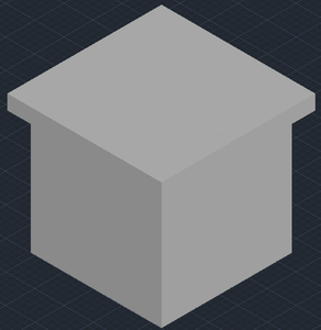

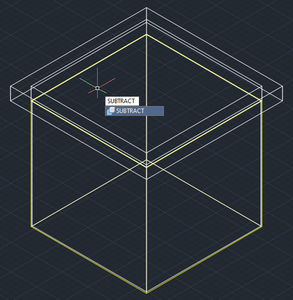

  7. SUBTRACT the inner box from the outer box, to create the space for the plants to grow.
The moment all the steps mentioned above are successfully completed, change the view to "Realistic View" to observe the changes and final pot design.
