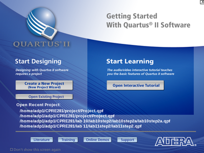

2) Open Quartus from your main window.
3) The project wizard should appear. Click on create a new project.
See Picture
4) The first page tells you about the project wizard. Click next to go to the next page.
5) Select a directory to work from.
Note: Any directory is fine. It is simply where you will save your files. It is best to create a folder specifically for any project you do.
6) Name the project 4BitAdder. This will also appear as the top level design entity.
7) Click to the next page.

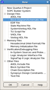

11) The project will load with a blank screen saying Altera Quartus II. In the upper left corner, click on file, and then click on new from the drop down menu that appears.
12) Select Block Diagram/Schematic File (BDF) from the window that appears. The screen will be white with small dots.
See Picture
13) Save the file right away under the name 4BitAdder. The file should default to this name when the save screen appears.
Note: To save, click file, then save as. You can also click on the floppy disk in the tool bar to save after parts are added.
Caution: Save often. Computers and software are known to crash. To keep from losing information and redoing steps, save your files whenever you think of it.

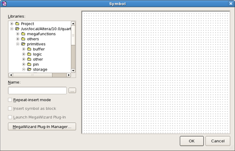

2) Place 10 T flip flops within the space.
a) 1) To add components, click on the symbol tool in the tool bar. (It looks like a D with two wires on the left and one on the right.)
See Picture
a) 2) You can also double click in the white space to bring up the symbols window.

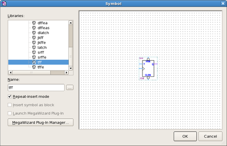

b) The symbols window loads with two libraries. One has all the files in the project that are made into the simpler blocks. The other is the default library that comes with Quartus. Click on the + beside the default library to expand.
See Picture
c) Our components are under the primitive folder. Click on the + to expand it.
d) The flip flops are under the storage file. Click the + to expand it.
e) Select tff.
f) Since we want multiples, click on the option “repeat-insert mode”.
g) Press OK and click in the white space to add T flip flops. (one per click)
Note: To stop any command or leave a new window, press the escape key.
See Picture

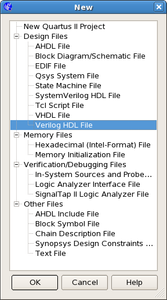

2) Create a Verilog HDL file.
See Picture
This file will be different than the others. The output of each segment will be specifically spelled out in terms of binary. This file will be coded.
3) Save it as 7_segment_display.
4) In the first line, enter “module 7_segment_display(A, B, C, D, E, F, G, W, X, Y, Z);”.

Step 5: Full_adder
The full adder is the device that does the actual adding in our entire program. The component takes in two bits and performs bitwise addition. Addition goes through first the 0’s place, then the 1’s place, and so on. If there is a carry from the previous place, it must be added in as well. A half adder does not consider the carry from previous mathematical operations.
1) Create a new BDF.
2) Save it as Full_adder.
3) Add 2 XOR gates to the file, side by side.
4) Add 2 2-input AND gates below the right XOR gate. The AND gates should be in a line vertically.
5) Add a 2-input OR gate to the right of the 2 AND gates, roughly between the two vertically.
6) Connect the output of one XOR gate to one input of the other XOR gate.
7) Connect that same wire to one input of the top AND gate.
8) Connect the other input of that AND gate to the other input of the right XOR gate.
9) Connect the outputs of the AND gates to the inputs of the OR gate.
See Picture
10) Add 3 input pins to the left of what we have, in a vertical line.
11) Label the top pin A.
12) Connect A to one input of the left XOR gate and to one input of the bottom AND gate.
13) Label the second pin B.
14) Connect B to the other input of the left XOR gate and to the other input of the bottom AND gate.
15) Label the third pin Ci (carry in).
16) Connect Ci to the wire connecting the input of the right XOR gate to the input of the top AND gate.
17) Add 2 output pins.
18) Label one Sum.
19) Connect Sum to the output of the right XOR gate.
20) Label the second Co(carry out).
21) Connect Co to the output of the OR gate.
See Picture
22) Save the file.
23) Analyze the file.
24) Create a symbol for full_adder.

1) Add 8 16-input MUX (161MUX).
a) Expand the others folder under our default library.
b) Expand maxplus2.
c) Add the 16-input multiplexer.

5) Add 8 D flip flops.
a) One flip flops should go below each MUX.
The D flip flops help to put the MUX onto the clock. Whatever signal is chosen by the MUX would be sent on its way, but by adding the flip flop, it will only be sent when the clock signal comes.

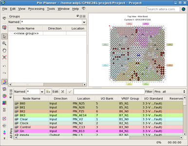

Step 7: Pin Assignments
Since we have finished the circuit of our project, we need to assign the input and output pins to switches and LEDs on the FPGA board. This will be the true test to see if the circuit works.
1) Click on Assignments.
2) Go down to Pin Planner.
A new window will appear with all the input and output pins you’ve placed in the circuit.
See Picture
3) Grab your FPGA manual or google your device’s pin assignment.
The pin assignment should go through all of your switches, LEDs, buttons, and 7 segment displays. The location of each will be given in the same row as it. (ex: PIN_N25)
4) Locate Bit0-Bit3 on the pin planner (should be alphabetical).
5) Select which switches you’d like to use for each pin (I used switch0-switch3 for Bit0-Bit3, respectively)
6) In your manual locate the switch you want to use and find its location ID.
7) In the pin planner, click in the location box and use the drop-down menu to select the correct location for that pin.
8) For your outputs, make sure the pin corresponds to the correct segment of the 7 segment display.
9) The input Clock should connect to an internal clock source. Make sure to use the one that has will scale correctly with your clock_generator.
Note: Make sure input pins are only switches and buttons. All of our outputs should be 7 segment displays.
Here is an example of what you could do.
• Switch0-3 for Bit0-Bit3.
• Switch 4 for LoadA
• Switch 5 for LoadB
• Switch 6 for LoadC
• Switch 7 for Control
• Switch 8 for Gn
• Switch 17 for Clear (since it resets the entire circuit, we try to keep it away from the switches we’d move more regularly)
• HEX7 for InputA-InputG
• HEX5 for StateMachineA-StateMachineG
• HEX3 for RegAA-RegAG
• HEX2 for RegBA-RegBG
• HEX0 for SumA-SumG
10) After your pins are assigned, exit out of the pin planner.
11) Re-compile the circuit.
a) Processing->Start compilation
