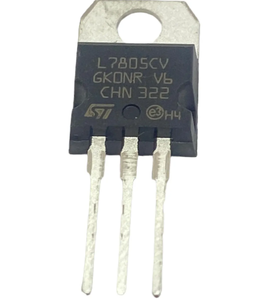

  1. L7805CV Voltage Regulator IC

Step 1: Connect Input Voltage
Connect the input voltage source to the input pin (Vin) of the L7805CV IC.
Step 2: Connect Output Voltage
Connect the output pin (Vout) of the L7805CV IC to the positive rail of the breadboard.
Step 3: Add Input and Output Capacitors
  • Connect a 0.33µF capacitor between the input pin (Vin) and ground (GND) of the L7805CV IC for input voltage stabilization.
  • Connect a 0.1µF capacitor between the output pin (Vout) and ground (GND) of the L7805CV IC for output voltage stabilization.
