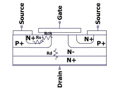

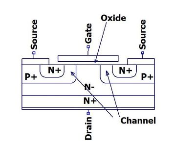

Step 4: Basic Structure of Power MOS

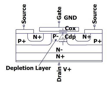

In my previous article, I didn’t understand why Vgs had a 20V breakdown limit and the Vds had a 60V limit since drain and source were interchangeable in the microelectronic circuit. Nobody responded to my question.
Finally, I found the answer by studying the power MOS structure. Power MOS differs from microelectronic MOS. Power MOS is a vertical structure. Its drain and source are not symmetrical. Its oxide has a breakdown voltage above 20V. So there is a limit of Vgs = +/-20V.
When drain voltage is higher than the gate, The electrical field under the gate converts the silicon layer from N- to P-. That forms a reverse bias PN junction diode with a depletion region and a depletion layer capacitor Cdp. The gate oxide capacitor Cox in-series with Cdp acts as a voltage divider that reduces the voltage across the oxide, so that drain and gate can withstand much higher voltage without breaking down.
In the oxide region between gate and source, there is no depletion layer formed due to P+ and N+ are highly doped. and shorted together.
The ON resistance is the sum of drain resistance Rd, channel resistance Rch, and source resistance Rs.
Ron = Rd + Rch + Rs. Only the Rch is changed by the gate voltage.
There is no point to have gate voltage higher than 10V since Ron = Rd + Rs even with Rch=0.
By the way, the MOS body diode is not exactly a diode. It is an NPN with a base and emitter shorted together. Some people said the P and N shorted together is for preventing latch-up.
I had a different opinion. There are only 3 layers. For an SCR to exist, it needs 4 layers.
I believe a short PN junction is to improve breakdown voltage.
If you look at an NPN datasheet, Vces is always higher than Vceo.

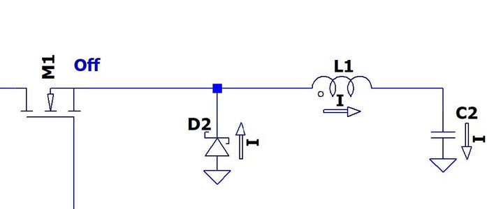

In a normal buck converter, when M1 is off, the current I flows through D2.
Most of the energy stored by L1 will transfer to C2. A small amount of power is dissipated by D2.
The power loss = I * Vd,

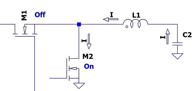

To minimize this power loss, a MOS switch M2 is added.
Once M1 is off, M2 is on. M2 ON resistance is very small, so the power loss is significantly reduced.
M1 and M2 can't be on at the same time. Otherwise, a lot of currents will flow straight through both of them and blow them up.
That means the clocking to both gates needs to have a non-overlap dead time so that both of them never turn on at the same time. During this dead period, the current flows through the M2 body diode.

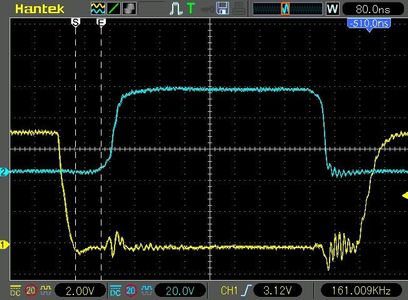

The plot on the right was measured at the LM25116. The blue trace was the gate of M1, and the yellow trace was the gate of M2. It had a non-crossover dead time > 100nS.
I was puzzled by the fact why the blue trace pulse width did not change much from no loading to 2A loading Also without loading, the buck converter consumed more than 1 Watt of power.
Finally, it dawns on me. M2 does not turn off when all the stored energy in L1 is transferred to C2.
All the articles I read and videos I watched, none of them mention turning off M2 when energy transfer was completed. Nor did they mention current flow is reversed.
When M1 is off, and L1 current drops to 0. One side of L1 is connected to C2, which is at a high voltage, while the other end of L1 is grounded by M2. So the current starts to flow backward.
If M2 is a Schottky diode, this won’t happen. But M2 is a switch. Nothing will stop the current flows back. So the energy from C2 charges up the L1 magnetic field.
Once M2 is off, all the stored magnetic field energy becomes current and flows through the body diode of M1 back to the input capacitors.
In other words, at no load, energy from the input transfers to the output capacitor, then reverse energy transfers from the output capacitor back to the input.
The back and forth energy transfer waste a lot of power. Most of the power loss is in the M1 body diode.
To prove my theory, I added a Schottky diode across the M1 drain and source, The power dissipation drops by 10%.

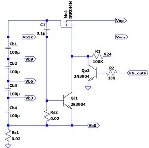

Step 12: Output Switch and Current Sensing.
When EN_outb=0, Qo2 is off, the Mo1 gate pulls up to 24V and turns Mo1 on.
Qo1 is for output short circuit protection.
If output current surge above 30A, Qo1 is on and pulls Mo1 gate down and turns off Mo1.
This is only for a short duration. The microcontroller should turn the output off if the output current exceeds 20A. In my previous version, the microcontroller checked the output current every 20mS.
The current sensing is referenced to the ground. Rs1 senses the charge current. Rs2 senses the output current.
To generate the average current output, add the RC low pass filter on the sensing voltages before feeding to the ADC.
