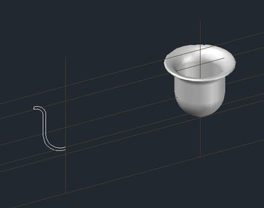

Set up your drawing: Most 3D printers use millimeters in their design guidelines. I found it easiest to set up my drawings with millimeters as the base. I also like to set up a few construction lines to make aligning objects easier. I tend to draw in 2d, then create a copy of whatever I created with an easily accessible reference point. This makes it easier to see what you're doing when you're drawing (since you're working on just one piece at a time), and also if you don't like what you just did, you can quickly go back to the previous version and change it.

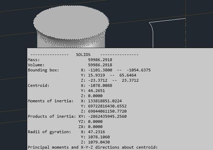

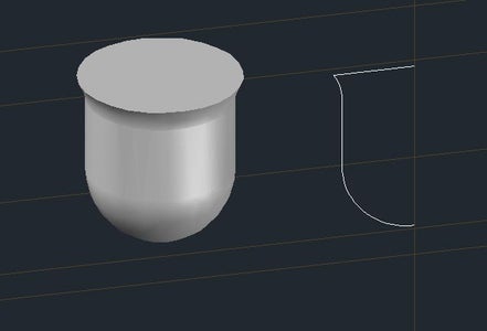

Draw and measure the interior volume: In AutoCAD, I drew a section cut through my desired volume, and revolved it to create a solid. Using the _massprop command, I found out what the volume of my solid was. I could then calculate the scale factor to scale my model up or down so that it equaled two ounces. (You can convert cubic millimeters to fluid ounces here.) I took the measurements of my new volume, rounded them up to the nearest millimeter. So, there is: the inside profile of my two ounce cup!

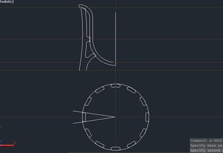

Once you have a concept and a scale nailed down, you can move on to making accurate 2D drawings with properly scaled wall thickness. If you set up your drawing well in 2D, it will be much easier to turn it into a 3D model. This is also the right place to take some measurements and be sure that your design has a size and shape that will work well in your hand.

1. Revolve the interior cup polyline along the center axis.

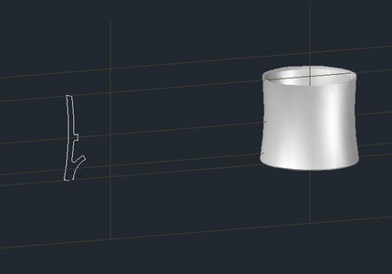

2. Revolve the exterior wall polyline along the center axis.

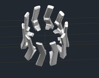

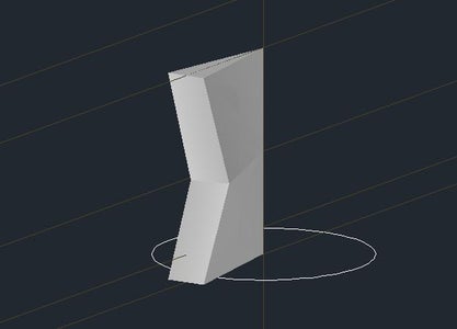

3. Draw a closed polyline of the wedge that will proscribe the width of the leg.

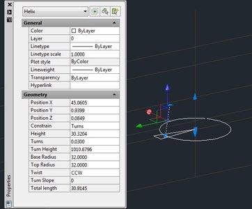

4. Use the _helix command to draw a spiral half the height of the cup.
5. Sweep the wedge shape along the spiral path.
6. Mirror the wedge spiral to create the bend in the chevron pattern. Merge the two spiraling wedge pieces using the _union command

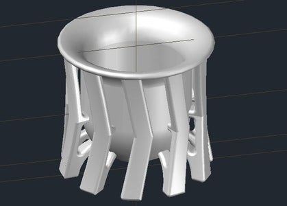

7. Copy the exterior wall profile and the spiraling wedge profile and line them up. Create a new solid where the two solids overlap using the _intersect command.
8. Use the _3Dfillet command to round the exposed edges of the leg.
9. Create a polar array of the legs around the center of the cup. (I used 10 legs)
10. Explode the array and align the finished legs with the interior cup.

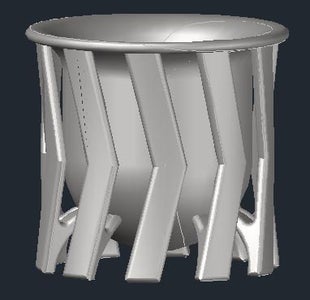

11. Use the _union command to consolidate all the pieces into one solid.
12. Copy the completed solid into a new file. Prepare the file for export to a CTL file according to your printer's instructions.

I do love my little teacup, but there are a few things I will modify to make the next print even better. First of all: the lip. The angle of the lip sagged significantly (the finished height was diminished by almost 5mm.) This was enough to change the volume capacity of my cup to 1 3/4 oz. rather than my intended 2. So on the next go around, I'm going to change the profile of the lip, and probably add in some more support to help combat the sagging. I'll also up the clearance between the exterior and interior walls. With sagging and the added thickness of the glaze, there were several spots that the legs fused to the interior cup. Heat transfer is still fairly effectively minimized, but I think it might be a cleaner connection if I added another millimeter of clearance.
