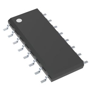

The ULN2003ADR is a high-voltage, high-current Darlington transistor array designed for driving inductive loads such as relays, stepper motors, and solenoids. It features seven open-collector Darlington pairs with common-emitter outputs, capable of driving currents up to 500 mA per channel. This makes it an ideal choice for controlling stepper motors in various applications, including robotics, automation, and CNC machines.
In this project, we will design a simple circuit to control a unipolar stepper motor using the ULN2003ADR. The circuit will interface with a microcontroller, such as an Arduino, to drive the motor through its step sequence, enabling precise control over position and speed.
Key Features of ULN2003ADR:
  1. Seven Darlington Transistor Pairs: Capable of driving up to 500mA per channel with low saturation voltage.
  2. High-voltage Output: Can handle up to 50V on the output pins.
  3. Built-in Flyback Diodes: For driving inductive loads like motors, relays, and solenoids, it includes internal protection against voltage spikes from inductive loads.
  4. Logic-level Inputs: Can directly interface with TTL or CMOS logic levels (e.g., microcontrollers like Arduino, Raspberry Pi).

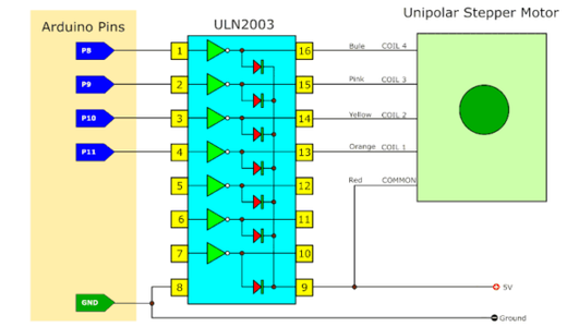

Step 1: Circuit Design
The stepper motor will be controlled by four output pins from the Arduino. These pins will interface with the inputs of the ULN2003ADR, which will drive the stepper motor's coils through its open-collector outputs. The ULN2003ADR allows you to control larger currents and voltages to the motor, which is not directly possible with the Arduino.
Here’s the basic schematic for this setup:
+5V
[Motor]
Coil A | Coil B
Arduino ULN2003ADR Stepper Motor
Pin 8 --> IN1 OUT1 --> Coil 1
Pin 9 --> IN2 OUT2 --> Coil 2
Pin 10 --> IN3 OUT3 --> Coil 3
Pin 11 --> IN4 OUT4 --> Coil 4
Pin Connections
  1. Stepper Motor Pins: The stepper motor has four wires (or leads). These connect to the output pins (OUT1–OUT4) of the ULN2003ADR.
  2. Arduino Connections: Four pins from the Arduino (e.g., Pins 8, 9, 10, 11) are connected to the input pins (IN1–IN4) of the ULN2003ADR.
  3. Power Supply: The stepper motor is powered by an external 5V supply, while the Arduino can be powered through its own USB or a separate 5V DC supply.
ULN2003ADR Pinout
  1. IN1, IN2, IN3, IN4: These pins receive logic-level control signals (from the Arduino).
  2. OUT1, OUT2, OUT3, OUT4: These are the output pins that connect to the stepper motor coils.
  3. COM: Connect this pin to the positive supply voltage to enable the internal flyback diodes (optional).
  4. GND: Connect to the ground of the system.
