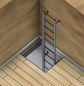

Step 5: Creating a Layout
After deciding that I wanted the structure to be two stories with one underground, I created upper and lower layout sketches.
The upstairs contains the rover service bay for easy access to the outdoors. It also has the bathroom and shower because I plan to add a passive water heating solution that uses solar energy. The kitchen fit well with the remaining space.
The downstairs contains the sleeping quarters and the computer lab because it is more important that these areas stay cool. Computers generate a lot of thermal energy, and putting them upstairs could cause overheating. Your body falls asleep quicker in a slightly cooler environment and it's easier to sleep in an area without light.

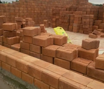

Compressed Earth Blocks (CEBs)
CEBs are similar to adobe bricks but are compressed using a mechanical press. The blocks are stacked with mortar to form walls.
Advantages:
- More uniform and stronger than traditional Adobe
- Good thermal properties
- Sustainable
Disadvantages:
- Consistent quality can be an issue between blocks
- CEBs can be susceptible to water damage

Step 15: Modeling a Basement Ladder
Hole In The Floor
To make a ladder that connects the lower and upper stories of the research station, I started by creating a large hole in the floor where I planned to do in Step 5: Creating A Layout.
The hole is 32x40in, a rectangle the same height as a doorway but slightly wider. It extends through the floor to make space for the ladder. The edges of the hole are bordered by trim boards that cover the exposed floor structure.
Ladder
The ladder itself is quite simple: a fixed, welded ladder that can be pre bought and bolted into the rammed earth wall. I found a commercial fixed ladder available on Grainger, manufactured with recycled metal by Cotterman. The ladder is 22in wide with 12in rung spacing.
I extended the ladder 4ft above the whole in order to make getting on and off easier.
