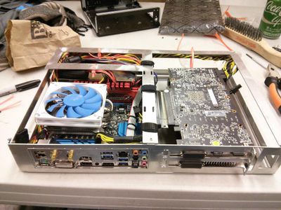

Step 2: The Pre-Prototype
Even though it was discouraging, I did learn a lot from the manufacturers. I decided to take advantage of a school event to make a super preliminary prototype of my design. I had divided the parts into 6 separate metal sheets, and I wanted to know if what I had in mind is even remotely possible and... well, it was ugly and the fit was poor, but it seems to work.

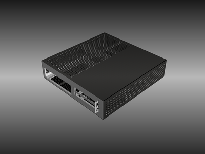

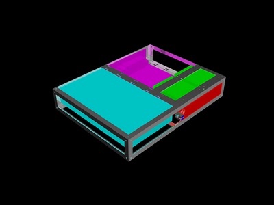

Step 3: Deep in Design
Armed with physical intuition from building the pre-prototype, I began round after round of design improvements. Aside from trying to have the case hold many combinations of components, my focus was making the case as quick (and thus cheap) to manufacture as possible. This includes making decisions like:
- Have as little bends as possible.
- Design the case to be assembled from bent metal sheets without any need for welding.
- Reduce the number of punched holes, instead increasing the hole size to maintain the same total hole area.
- Reduce the number of openings that cannot be created by punching holes (has to be laser cut).
- Use only one hole size, so the hole-punching tool does not have to be swapped out during the whole process.
Step 4: !nverse: Finalized
Many iterations later, the design is reaching maturity. Able to hold 4 different configurations, including a 240mm AIO water cooler, a full-size GPU, and large 3.5" hard drives, it emerged as one of the most versatile "flat" case designs ever conceived.

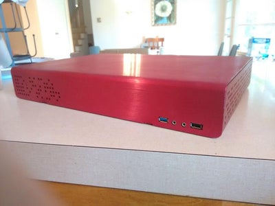

Step 5: The First Prototype
While I was deep in the design of things, my friend contacted nearly 200 manufacturers all over the world. We sent each of them CAD drawings after CAD drawings, begged for their advice, until the design finally became manufacturable. And then we selected one manufacturer to make a prototype for us.

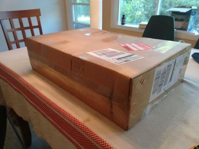

Step 6: The First Prototype (cont.)

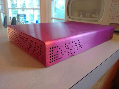

Giddy with excitement, we tore the nicely wrapped package apart to reveal our prize.
Step 7: The First Prototype (cont.)
We made this!!

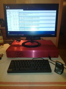

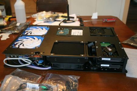

Step 8: The First Prototype (cont.)
Very nice, but will it run?

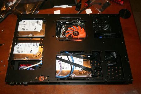

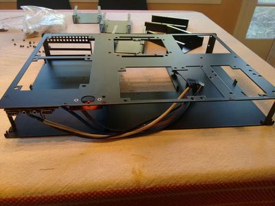

Step 9: The First Prototype (cont.)
The empty interior skeleton, ready for component installation.

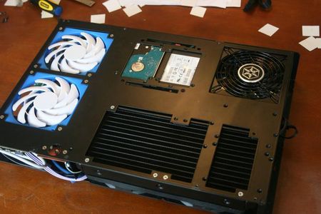

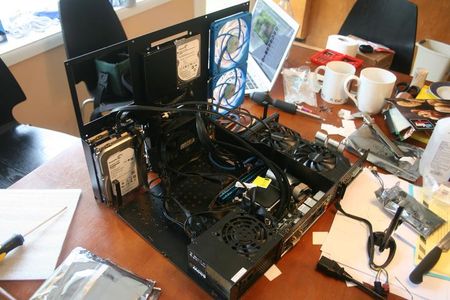

Step 10: The First Prototype (cont.)
IT LIVESSSSSS!!!!!!
So what components can it hold?

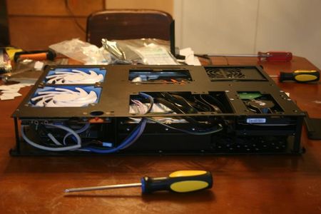

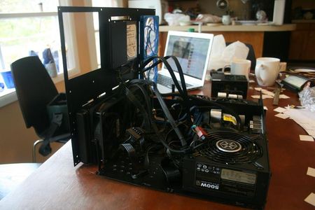

Step 11: Picture of Interior Configuration 1
mITX motherboard, full size GPU, 120mm AIO water cooler, SFX/SFX-L power supply, 2 x 3.5" HDD, 2 x 2.5" SSD, 2 x slim 120mm fan
Step 12: Picture of Interior Configuration 1 - Closed
Step 13: Picture of Interior Comfiguration 2
mITX motherboard, full size GPU, 240mm AIO water cooler, SFX power supply, 2 x 2.5" SSD, 2 x slim 120mm fan
Step 14: Picture of Interior Configuration 2 - Closed

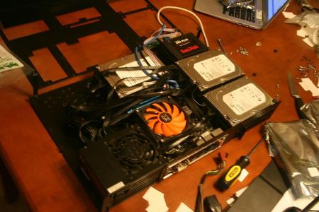

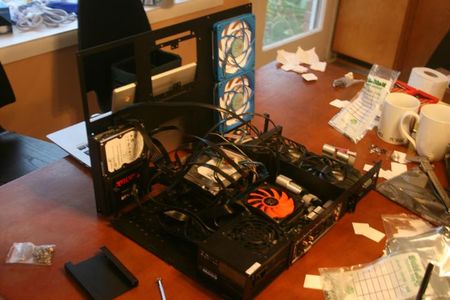

Step 15: Picture of Interior Configuration 3
mITX motherboard, full size GPU, low profile air cooler, SFX/SFX-L power supply, 3 x 3.5" HDD, 2 x 2.5" SSD, 2 x slim 120mm fan
Step 16: Picture of Interior Configuration 3 - Closed
Step 17: Picture of Interior Configuration 4
mITX motherboard, low profile air cooler, SFX/SFX-L power supply, 6 x 3.5" HDD, 4 x 2.5" SSD
Step 18: Picture of Interior Configuration 4 - Closed
