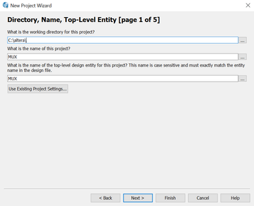

Step 1: Creating a Project Using Quartus II

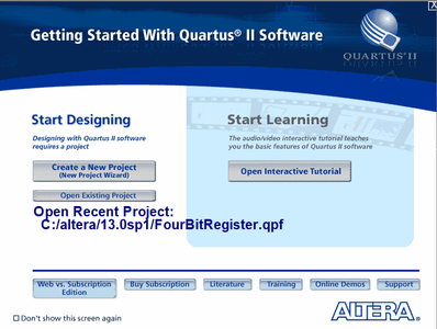

  1. First to start, open up the Quartus II Software and click "Create a New Project"
  2. From there you will be prompted to choose you desired working directory and name of the project, in this case I simply named my project MUX and left the Top Level Design the same

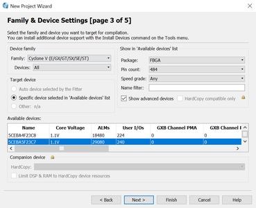

  3. Next you will be prompted to choose the "Family and Device Settings" which is not important for this specific tutorial since we will only be simulating the project instead of uploading it to a development board, but to insure your simulation works properly you can follow the same specifications of the Cyclone V (DE0 board) given above

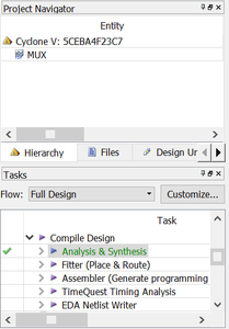

Now that the code needed for the 74HC151 multiplexer is done, we need to verify that there are no bugs within the code and compile it so that we can test it in a simulator. To do so, using the 'Project Navigator' find the "Compile Design" section and double click 'Analysis and Synthesis' to check for any errors in our project (if you are trying to upload the project to a development board you will need to compile the whole design but to save some time, it is only needed to run the 'Analysis and Synthesis' to use the simulator).

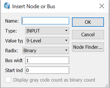

  3. To import the inputs and outputs, navigate to the edit tab on the top of the screen and click on 'Insert' and 'Insert Node or Bus..."

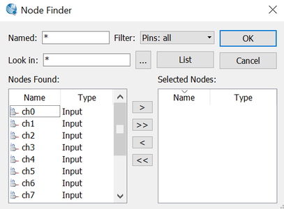

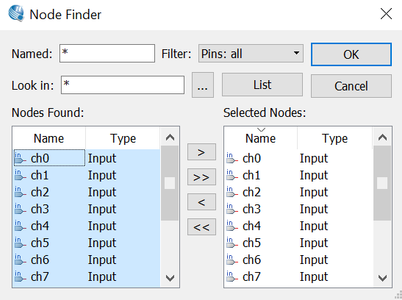

  4. This will open a new window were you will open up the 'Node Finder' and click 'List' to display all used nodes
  5. Lastly move all 'Nodes Found' to the right side table (or click '>>' for Quartus to do it for you and you are ready to begin modifying each input to verify the working of the 74HC151 multiplexer
