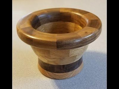

In this article, I will explain how to make a set of plans to create a segmented Vessel.

The first thing you need to do is decide what you want to make.
I suggest you start with something small.

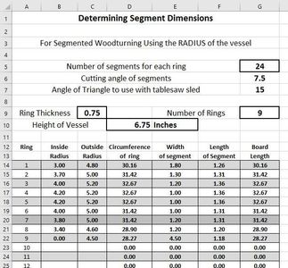

Step 15: Excel Spreadsheet
Updated link to Excel File to make Cut Sheet.
Not sure what I'm doing wrong.
To get a copy of the spreadsheet, you will need to copy and paste the Link below and it will take you to a page that will allow you to download the spreadsheet.
https://southplainswoodturners.weebly.com/uploads/5/3/2/3/53231531/segment_calculator.xlsx
Step 16: Cut Sheet
To make a cut Sheet, download the Excel file and open it.
Using the answers to the formulas from your sketch enter the inside radius (R_in) and the outside radius (R_out)
The spreadsheet will make all of the calculations for you.
Simply print it out and start building.
