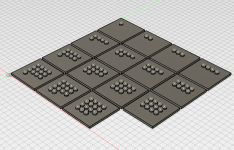

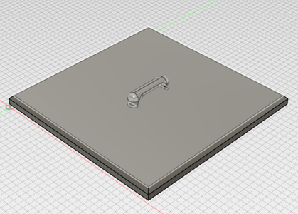

I also collected these ideas by creating a sketch. I simply drew and labeled all of the components of 1 puzzle set (one is necessary for each player, but they would be identical). One set consisted of 15 pieces, each labeled with a different number of bumps to denote numbers, a container for the numbers to slide around in, and a cover so that the pieces don't get lost when they are stored.
Step 3: Design Model
After this, I began designing the 3D models in Fusion Autodesk 30. I began with the container. I created this container in a 150 by 150 mm square because my 3D printer could only print 6 in x 6 in x 6 in objects (~152 mm). Then, by using the container, I made a fitting. I did this by imprinting the top of the container on the bottom of the cover Then, I created all 15 pieces. I did this by copying one piece and then modifying the copies, as creating them all from scratch would be tedious..
