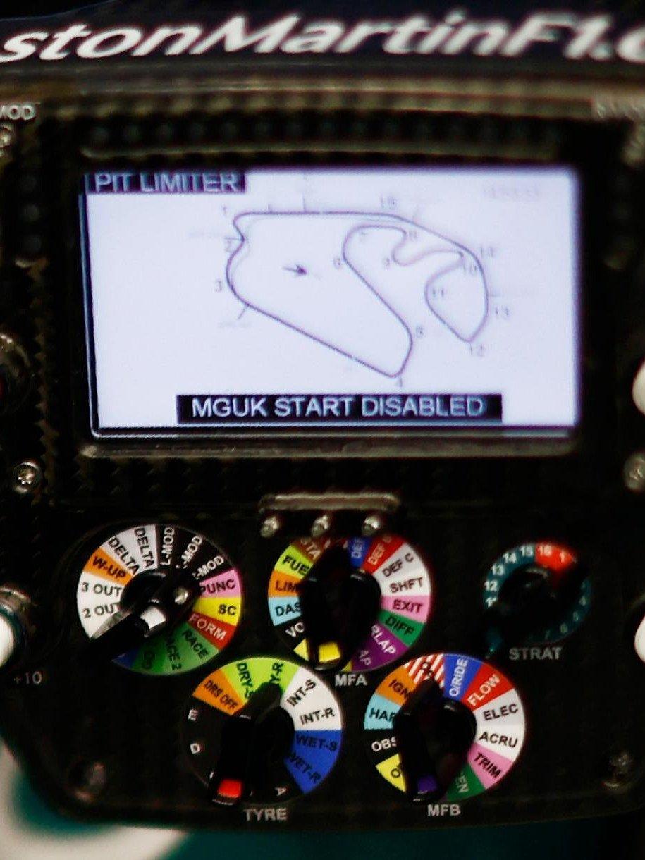

To model the AMR23 steering wheel accurately, I gathered a wide range of reference photos from across the internet. Without access to official dimensions, I relied on visual cues and image comparisons to guide the placement of buttons, contours, and proportions. This helped ensure the final design remained true to the original while being practical for 3D printing and easy to assemble.

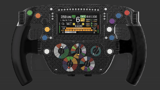

The following renders showcase the AMR23 steering wheel replica, modeled in Fusion 360. Designed for easy 3D printing and quick assembly, each component slots together cleanly, capturing the look and feel of Aston Martin’s 2023 design.
Materials Used (Render Workspace):
Carbon Fiber - Twill: Main Body, Shifters
Aluminum - Satin:Nuts, Bolt Heads
Plastic - Glossy: Buttons, Dials
Coating- Black Oxide: Bolt Heads, Clutch Base, Clutch Rod, Quick Release Base, Shifter Mount
Plastic - Matte (Black): Buttons, Clutch Paddles, Clutch Sensors
Rubber - Hard: Grips
Brass - Polished: Quick Release, Shifter Mount Rod
Polycarbonate - Clear: LED Lights
