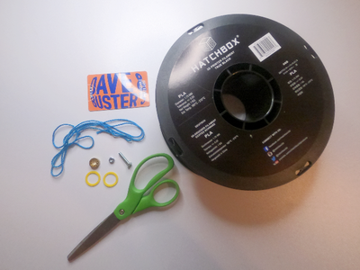

Tools
  • 3d Printing Filament (I used Hatchbox PLA, but any filament should work)
  • A 3d Printer (I used an Elegoo Neptune 3 Pro) (link)

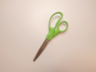

  • Scissors (link)
  • A Plastic Card (Credit card, gift card, etc.)
Parts
  • 1 4mm x 20mm Hex Bolt (link)
  • 1 4mm Hex Nut (link)
  • 1 C size concave unresponsive yo-yo bearing or a Half-SPEC C responsive yo-yo bearing (These can be bought on Amazon or any yo-yo retail store)
  • A pair of 19mm MagicYoYo response pads (These can be bought on Amazon)
  • Yo-yo String (These can be bought on Amazon or any yo-yo retail store)
  • Yo-Yo Parts- This link contains all the yo-yo parts needed, including extra bearings, extra string, and extra response pads. It also includes extra things you won't need such as a bearing tool and axles.
