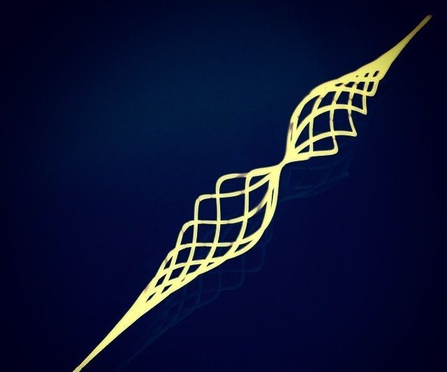

Step 3: Dreamcatcher Setup
With the data we created by 3D scanning, we rebuilt the 3D info and points of interest.
In the image, silver denotes objects that need to be connected, each with load cases (green lines). For example, the screws at the top and bottom need to withstand 40lbs of backdrawn force. The cyan indicates void objects where the software avoids drawing. Aluminum was chosen as the material for this object, and its properties are added to the calculations.
Step 4: Dreamcatcher Magic
(click
on image to play the gif file)
With the inputed values, Dreamcatcher pushes and pulls the material into a optimal solution.
