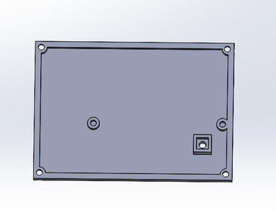

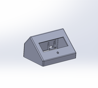

Step 3: Designjing the Enclouser
Coming to the next part, to create an enclosure for this, I came up with this design, as I prefer to keep things simple and practical. It's just a normal 3d printed enclosure with enough inside space to mount all the components required
But there is no end to imagination. I have provided you with the 3d model of this. You can modify and make it cooler looking

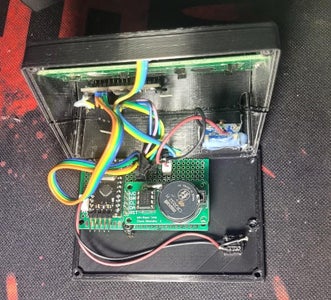

Step 4: Making of PCB
Now, everything works fine on the breadboard; it's time to move it to the PCB for mine. I have used a doted PCB/perf board to solder all the components directly.
And all connection areas, as per the Diagram shown in Figure in step 2
Step 5: And Done !!!
And it's a wrap, it is done, everything is working fine, and it is accurate. I have tested it for a couple of days, tried turning it on and off, but it still shows accurate time, and the temperature and humidity level are pretty accurate also
