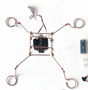

Step 1: Prepare Robot Chassis (Motor and Battery Compartment)
Bend two pieces of copper wire according to the plan. Insert the wires through the holes on the servo motor side. Begin by mounting both servos onto one frame, then proceed to attach the second frame. Insert the battery through the center to help stabilize and secure the structure. (Refer to Attached Plans).
Step 2: Create Legs and Frame for Robot
(Refer to previous attached document)
Legs
Cut the 2 mm copper, so that you have 4, 210 mm length pieces. Using the provided template, bend the leg into shape.
Main Frame
Start by preparing the beads for the main frame. For the four corner hinges, cut circular grooves around the center of each bead using a lathe or a power drill. For the compartment mount, drill a 2 mm diameter hole on each side of the bead, perpendicular to the axis of the existing holes. Then, using the plan as a guide, bend the wire to form the frame and loop it around the grooves in the beads using tweezers.
