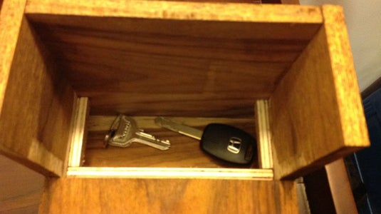

I just glued the pieces in proper places (a little drilling and nailing can be done depending on preferences!!). The piece 'A' was the base. 'C' was used as back of the stand. 'D' pieces were used in both sides. 'B' was the top layer of drawer area (pictures shows it clearly), leaving a gap between 'B' and 'C' which creates ample of space for a secret compartment (all glued!)! To get the idea you can keep the 'E' pieces on top of 'D's on both sides between 'B' and 'C' (better not glue them now for the convenience of making other parts!).
To make the pen stand, glued the 'G's using one as a base and the other as a partition ( and 'H' was glued in the middle to divide that portion for pens and bills) and was not glued to the main set because it will act as the lid concealing the secret space !
On the base ('A') ,the length of the 'B' was kept as a drawer area and the plywood piece 'd' was glued to separate the drawer n the secret space (so even removing the drawer will not reveal the secret!!). As shown in the pics on both 'D' walls ,the 'e' pieces were glued at the same level as 'd', to give the support to hold the lid of the compartment / the pen holder !!
Now it is the time to glue the 'E's in their places! By whole it will look as though all the parts were glued tightly... but by pulling up the middle of the pen holder alone will reveal the secret!

To make the drawer , 'F' was used as front! The plywood piece 'a' was the base, sides were 'c's and the back side was 'b'. before joining it to the 'F' , I nailed the other sides together! the nailed plywood piece was positioned appropriately on the inner side of the 'F' piece...the drawer was made!! This tiny drawer is ideal for wallets, card holders, keys, bracelets, etc. I stained the desk organizer with teak color.
