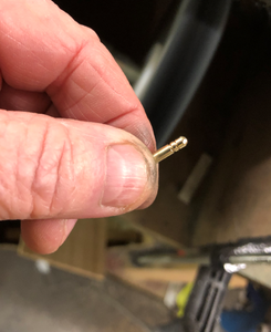

First operation is a metal lathe operation, the skittles don't have to be anything too fancy, I had 10mm brass bar and started by turning it down to around 8mm, I then cut a groove at the top end resembling a skittle(Very loosely)
I also turned the bottom of the skittle down slightly as they will fit into recessed holes in the base
9no Skittles in total needed, then onto a quick polish on the buffing wheel.

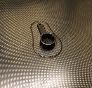

Step 4: Skittle Base 3D Print
The only thing we need to make sure we do is add support for the cavity under the base.
My 3D Printer is a Creality CR-10 with a Creality build plate, the only thing you need to do with these build plates is to check the level then wipe with Methylated spirit, then once the print is complete you let the whole thing cool down completely, after this the print is free just to remove off the bed, no scraper needed to remove the print etc.

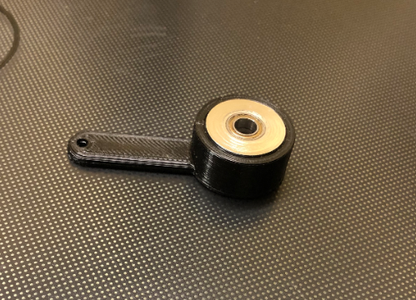

We need to make a part which will fit on top of the 5mm bar and needs to move freely, we will connect a chain or cord to this to connect to the Brass ball I made, I have a spare GT2 Belt pulley, this will do nicely as it has an internal bearing.
We will make the part in Fusion 360.
Starting out with a sketch, we select the top plane and create a centre circle @ 18.02mm which will give us a snug fit over the pulley, then using the offset tab create an offset of 2mm this is the wall thickness, we then sketch a handle which the chain will connect to, sketch 2 lines @ 25mm and then select the 3 Point arc tab, connect the 2no 25mm lines and create an arc.
Extrude the inner part of the circle to 2mm then the walls of the circle to 12mm then the handle to 3mm.
Then create a centre circle hole in the handle to accommodate the ball chain.
Use the fillet function to round the edges, and that part is now complete.
3D print the part and trial fit, make any adjustments to the sketch if needed and print again if necessary.

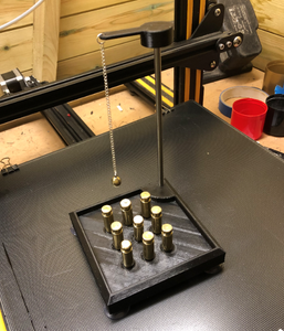

There we have it, a useable Desktop skittle set.

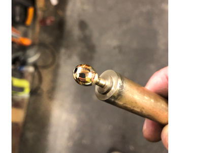

I made a small brass ball and connected it to a piece of chain.
I was going to connect pieces of cord to the bottom part of the skittles, the idea being that the cords would be connected together and a quick tug would re-seat the skittles, the idea never worked out, I think the circumference of the skittles was too small and the skittles need to fall freely anyway.

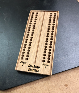

I made a little peg board using Vetric Cut2d created some holes using the Linear array Tab and then a rectangle and a separation line.
