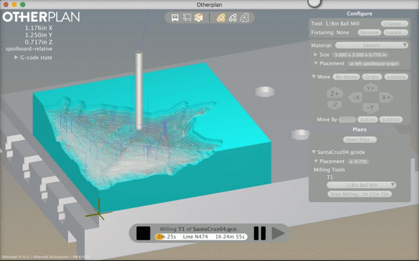

With the stock fixtured and the machine homed, you can run the gCode you created in Fusion 360. To run a file, just click Open Files in the Othermill dialog box and select the G-Code you exported from Fusion 360 in post processing.
Note that the Othermill control software lets you specify which corner the material is in ("at left of spoilboard origin"). My piece of wood is .76" thick, but I've changed it to .77" to account for the double-sided tape on the bottom of the wood.
For the Othermill and most other desktop CNC machines, a computer must remain plugged in to run the tool path via USB. You can pause the job, meaning it will resume where it left off if you click the Play button, or you can stop the job by clicking Stop. This will reset the spindle position and won't let you restart from where you left off. This toolpath takes about 1.5 hours as indicated in the progress bar.

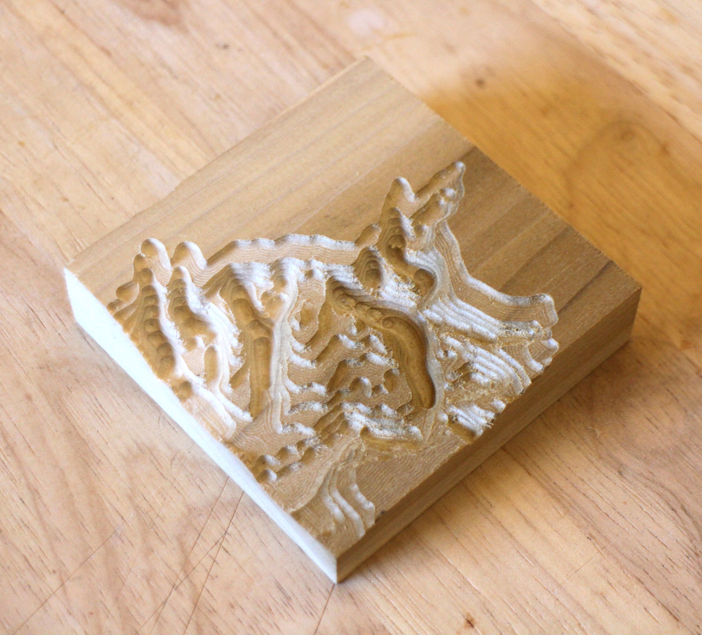

Step 4: Finished Product
With the toolpath settings we created, the piece comes out kind of like a topographical map. With a smaller stepdown value, the layers would be less pronounced.
