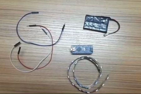

  • ARGB LED Strip (WS2812 LED Strip) x22(in my case)
  • Arduino Nano x1
  • 6v 600 mAh Lipo Battery x1
  • Jumper cables

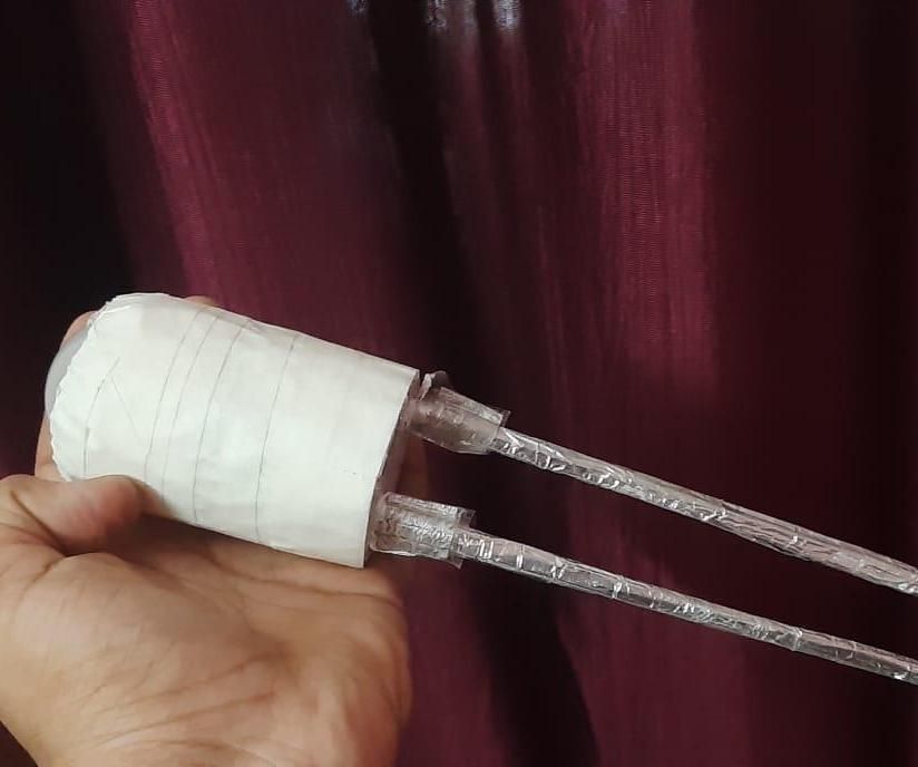

Step 1: Attach the WS2812 LED Strip to the White Container
I attached the WS2812 LED Strip to the white container using some masking tape.
The reason I am using this white container is that it will diffuse the light evenly in all directions.

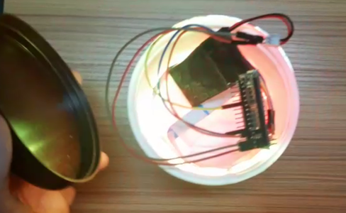

Step 2: Connect the WS2812 LED Strip With the Arduino
Then I connected the LED Strip to the Arduino Nano using jumper cables according to the connection diagram. I choose digital pin 7 (D7) as the signal input pin for the LED Strip.
The battery I am using is a 6v 600mAh lipo battery, which I collected from an old Bluetooth speaker.

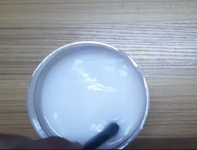

Step 4: We Need to Add Water to the Container
I poured some water in the transparent container. Because of transparency the light will not diffuse evenly. So I mix some white colour to the water.
This will work like a charm.
Step 5: Sealing the Container
Then I seal the container with some hot glue to prevent water leakage and cover the container plastic lid to cover all the electronics.
