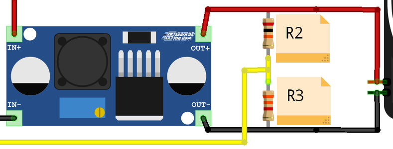

Speed Measurement (R2 / R3):
A voltage divider is connected across the output of the boost converter. The divided voltage is sent to one of the analog inputs of the ESP32S3, enabling the microcontroller to measure the voltage and thus estimate the fan speed in percent.

Step 3: Voltage Divider for Measuring Fan Speed
To measure the output voltage of the boost converter (which indicates the fan speed) using the ESP32S3's analog input, we need to scale down the voltage to a safe level. The maximum voltage the ESP32S3’s analog input can handle is 3.3V, while the boost converter output can go up to 20V.
We can achieve this using a voltage divider, which reduces the voltage proportionally to a safe level. The voltage divider consists of two resistors, R2 and R3, arranged in series.
The output voltage from the divider Vout is given by the formula:
Vout = Vin × (R3 / (R2+R3))
With:
Vin(max)​ = 25V (give some some overhead)
Vout(max) = 3.3V
Again, after some calculations I came up with:
R2 = 20k
R3 = 3.3k
This gives me a following voltage level at the MCU ADC Pin (measured with an multimeter):
Fan Voltage: 22V = MCU Voltage: 3.10V
Fan Voltage: 4.5V = MCU Voltage: 0.66V

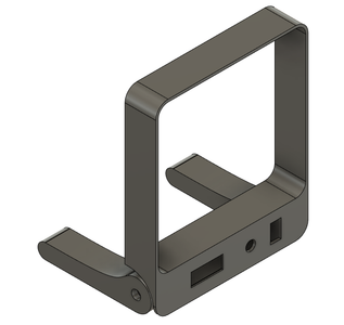

Step 4: Designing the Housing
Now that we have the electronics sorted out, it’s time to design a functional and cool enclosure to house everything.
If you have access to a 3D printer, you can create a custom-fit enclosure as I did, or try mine.
Optional:
Include a grill or guard on the front of the fan to protect it from dust and foreign objects.

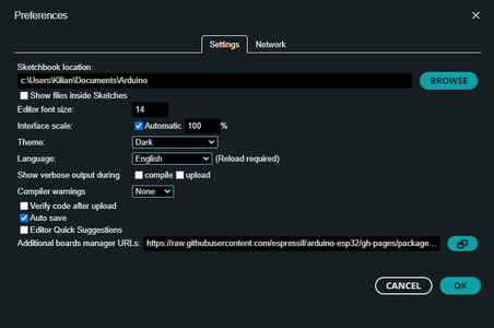

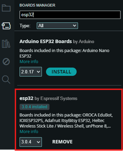

Installing ESP32 Arduino on Arduino IDE:
  1. Check Supported SoCs
  2. Copy the Development release link [https://raw.githubusercontent.com/espressif/arduino-esp32/gh-pages/package_esp32_dev_index.json]
  3. Go to Arduino IDE > Preferences > Additional Boards Manager URLs and paste the JSON link
  4. Go to Tools > Boards > Boards Manager > Search ESP32 > Install the latest version

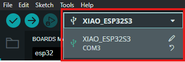

  5. Plug in the USB cable to USB port of the dev board
  6. Check the board can be detected on the computer with the dropdown menu of Select Board
  7. You are now ready to go
