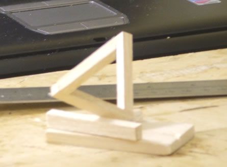

Step 2: The Upper Mechanism
The main difficulty that presented itself from the beginning was the issue of the smooth motion required to get the wing blades to move smoothly. This diagram shows a schematic overlay of the wing coupling on the ornithopter. The upper wing joints forming a triangle are fixed and the lower (in the current shot) is fixed to the cam. You will note that the distance between the couplings at the low stroke and high stroke is 36mm but at mid point the distance between the central coupling and each out joint is 30mm.
Due to this issue I saw fit to cut a slit in the wing blade (circled in blue on the left) with a length of 6mm, the difference between the maximum coupling distance and the the shortset coupling distance. The couplings were made by drilling a 2mm dowel into MDF and then feeding the blades onto them. The blades were kept in place my minute aluminium washers found in the video camera.
Step 3: Lower Mechanism
This is where a simple cam mechanism worked an absolute treat. This part required a bit of trial and error but it was finally worked our using some graph paper, a compass and my trusty metal ruler. The trick is to ensure that the three arms creating the cam are cut to specific lengths so that the upthrust and down thrust do not create a jam at the lowest and highest points. The measurements I used are:
- Arm A - 20mm
- Arm B - 52mm
- Arm C - 73mm
