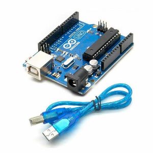

  • Arduino UNO
  • Arduino UNO Connector

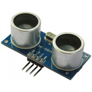

  • Ultra-sonic sensor

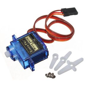

  • Tower pro SG90 micro servo

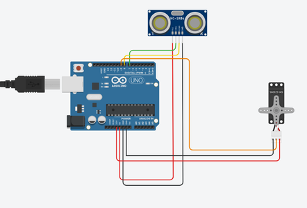

Step 1: Circuit Diagram
Connections :
Ultrasonic - UNO
GNG - GND
VCC - 5V
TRIG - PIN 7
ECHO - PIN 8
SERVO - UNO
RED(positive) - 3.3V
BROWN(Negative) - GND
ORANGE(SIGNAL) - PIN 9

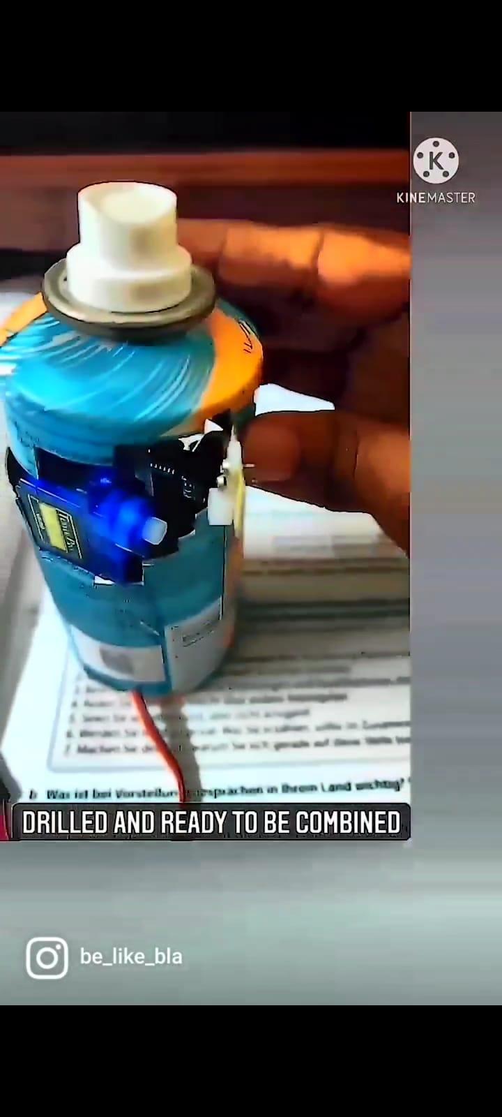

Step 2: Shaping Deodorant Can

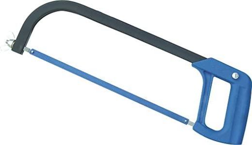

Make sure to use a properly depressurized deodorant can , denting or rupturing an new or non-empty deodorant can can result in accidents. Use a hacksaw blade or a mini drill to cut it horizontally. Along with it, make a hole for US sensor in front , and a slit to allow the wires to come out from can on lower back.
Step 3: Joining Two Parts With a Servo
Draw a bare outline of servo with horn , as per the orientation shown. Use the Hand drill to cut out the pieces. One segment of top piece is bent towards outside and used as a hinge for connecting to servo. the bottom of the servo is attached to a platform in bottom piece , which is created by bending a segment of bottom piece towards inside. Servo is glued , and the horn is attached to the hinge with screws. Be mindful to zero set servo before attaching the horn , its always safe to attach the upper jaw a bit open than completely closed.
