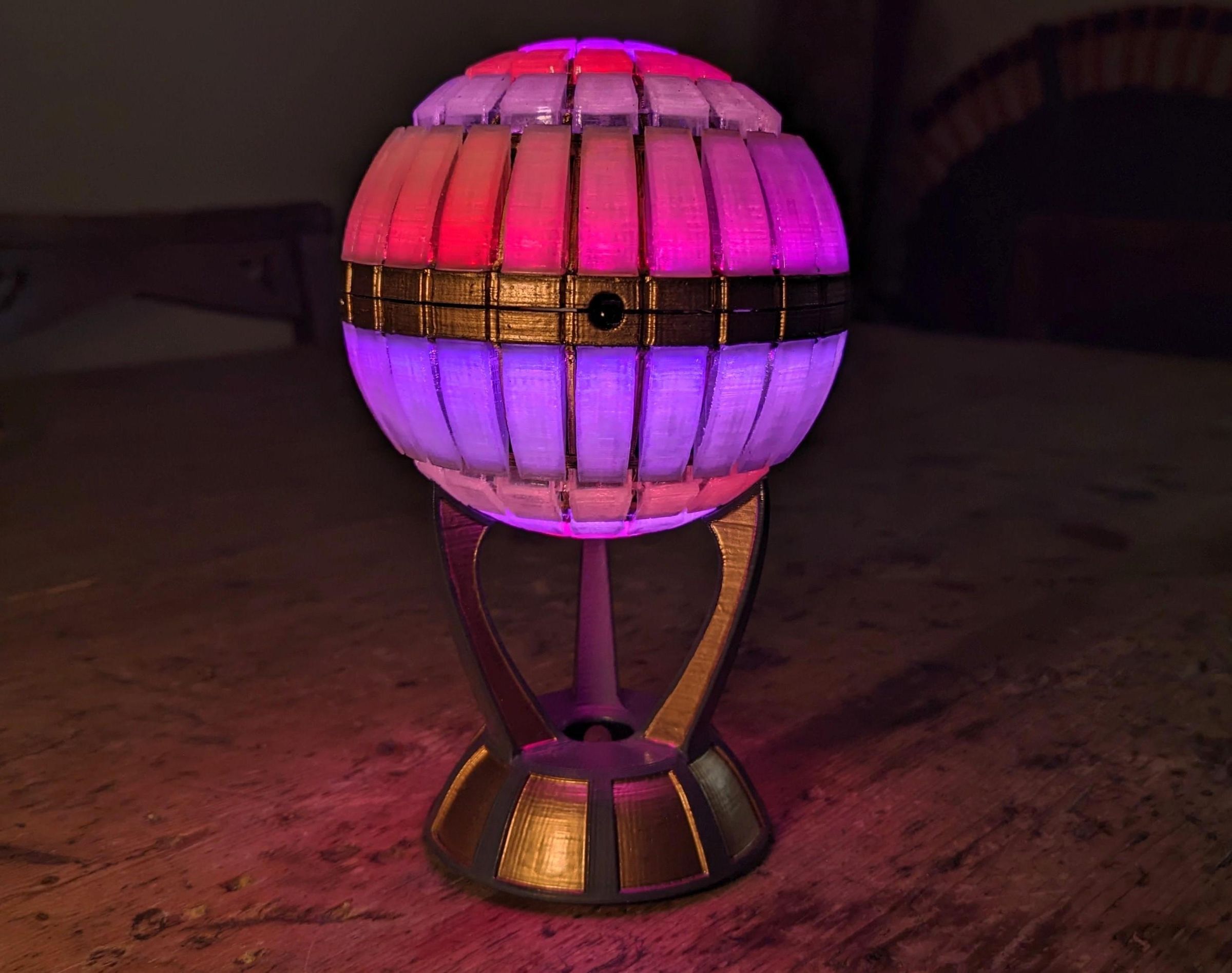

Introduction: Desktop-Sized Infinity Dodecahedron
(If you watch the video on Youtube it has timestamps for the different effects. They don't seem to show up on instructables)
You may have seen various "infinity dodecahedrons" or other polyhedra across internet, such as here, here, here, or here. They are all mesmerizing in their own way. However, each of them has, for me, one major problem. They are all waaay too big. All of them are about the size of a basketball, if not larger. This is fine if you're going to a festival, or are going to hang them from a ceiling, but if you'd like to put one on a desk or a shelf, it's probably not going to be very practical. I wanted a desktop friendly version, so I set about making one.
My end result is a dodecahedron that is a bit bigger than a softball. Without the stand, it measures about 150mm from corner to corner, or 124mm from face to face. With the stand, it is about 203mm tall. You can see it compared to a fresh pencil in the pictures. It is small enough to have on a desk, while still having plenty of LEDs, and being build-able by hand.
The dodecahedron uses strips of mini (3535 SMD size) SK6812 addressable LEDs. These are more or less the same as the more common WS2812B (aka Neopixel) LEDs, but are more compact. They are arranged into lengths of seven LEDs on each of the dodecahedron's 30 edges, for a total of 210 LEDs. To drive the LEDs I used a Wemos D1 Mini mounted on a custom PCB housed in the dodecahedron's base. Everything is powered from a common 5V, 2A wall power adapter.
I have written code to drive the LEDs, including 18 different animations/effects.
If you have never worked with WS2812B style LEDs before, taking a look at the Adafruit Guide may be helpful.
Both the dodecahedron and the base are assembled entirely from 3D printed parts. The faces of the dodecahedron are laser cut from 1/8" or 3mm acrylic and are coated in one way mirror film.
For pretty much all "infinity" polyhedra, the tricky part is connecting the LED strips at the polyhedron's corners. Most people connect the strips with wires, but this quickly gets tedious, especially at smaller sizes. To make the connections a bit easier, I designed special corner PCBs that solder directly onto the strip ends, connecting all of them at once. These were for the most part successful, but I did have some tolerance issues that required some extra soldering.
Overall, this is a bit of a tricky build, especially when it comes to soldering. I would not recommend this project to a beginner, but if you have experience soldering in tight places you shouldn't have too many problems. Likewise, there are a few steps where it will be very helpful to have an extra person around to lend a spare pair of hands. I encourage reading through the whole Instructable thoroughly to help plan your build.
You can find all the files for the project at my Github here, and here (last link is for the Wemos control PCB).
If you would like to view schematics of the PCBs you can find them here and here.
Finally, if you have any questions about anything in this instructable, please leave a comment, and I'll get back to you.

Step 10: Applying the Strips Step 1:
We'll begin by attaching strips and wires to the base PCB. This is the bottom corner of the dodecahedron, and is where both power and data inputs are connected to the strips. This is more easily done off of the dodecahedron because you'll need access to both sides of the PCB.
Start by cutting seven ~10cm long lengths of 22Ga stranded wire. It will be helpful if you have three separate colors: one for ground, positive, and data. In my pictures, black is ground, red is positive, and blue is data.
Strip, insert, and solder the wires into the through-holes in the base PCB as pictured. Refer to the guide to make sure you place the wires correctly. Depending on how many strands your wires have, you may need to trim a few away to get them through the holes. If you cannot easily get them through, switch to 26Ga stranded wire.
To connect data between strip 5 and strip 6, take a short length of 26Ga solid wire and strip it bare. Flip the PCB over so that you are on the side without the wires poking out. This makes it easier to work on. Take the length of wire and solder it so that it connects the two unused center data pads as pictured.
Now, cut three 7 LED long sections of the strip. Cut along the center of the solder pads between LEDs, make sure your cuts are straight, and divide the pad into roughly equal halves. It is important that you leave enough pad on each side to solder onto! If your strip has adhesive backing, remove it.
Next, solder the strips onto the PCB as pictured. Make sure you follow the guide to get the orientations and directions correct! The LEDs should be facing away from the side with the protruding wires. It is helpful to tin the strip's pads before attaching them. You can solder the strips to both the top and bottom side of the PCB, I found the bottom to be easiest because the wires are out of the way. The strips do not need to be angled as pictured; I took the picture after I test fit them onto the dodecahedron.
Step 11: Applying the Strips Step 2:
Using hot-glue, attach the base strip trio you just soldered to the dodecahedron. Make sure the LEDs line up with the bracket's holes. The base PCB may protrude a bit from the corner due to the wires. This is okay as long as the surrounding LEDs line up with the bracket holes. Note that where you put the base PCB will be the bottom of the dodecahedron. Also, you can ignore the tape in the photos, that was for testing purposes.
Now, cut out 27 more seven LED long strips; enough to cover all the dodecahedron's edges. As with the base PCB, make sure your cuts are straight and even across the pads. You should remove any adhesive backing, and tin the pads (I didn't do the tinning, which was a mistake).
Next, you have two options:
- Attach all the strips to each of the edges of the dodecahedron using hot-glue. Make sure you follow the guide exactlywhen placing the strips to get the directions correct! It maybe helpful to write down what strip you are on at each step. This is what I did, and it worked out well.
- Skip on to the next step and begin soldering the corner PCBs in place, adding strips to the dodecahedron one by one as you go, following the guide. This may be easier to keep track of, but due to tolerance issues, soldering all the connections to the PCBs may be more tricky.
Step 12: Applying the Strips Step 3:
Now it's time to solder all the corner PCBs in place and add the double back wires.
As pictured, press a common corner PCB into place at each corner of the dodecahedron. They should be a loose press fit. Make sure their orientation is correct by following the guide. That is, make sure the data is connected between the two correct strips, and that the positives and grounds are correct.
Once a PCB is in place, connect its pads to the surrounding strips by bridging them with solder. This is a bit fiddly, but if you use plenty of flux and a fine tipped iron, it should be more time consuming than difficult. Watch for shorts between the pads and the strips!
When I assembled my dodecahedron I didn't do a great job of pressing it together. This was mainly because I tried to do it alone, and my epoxy set too quickly. This meant that on some of the corners, I had gaps that were too large to bridge with solder. For these cases I used small lengths of 26Ga solid wire to connect the pads. You can see this in the pictures. Hopefully you did a better job than me, and won't have to do this too many times.
As you connect the PCBs you should also connect the "double back" wires for the data. These direct data backwards, connecting to a strip on a different corner. In my pictures I used red solid 26Ga wire for this. Each of the corner PCBs has a data pad with a through-hole specifically for the wire, which should help make the connections more solid. Remember to follow the guide to make sure that the data jumps to the correct strip section.
At this point the dodecahedron is all wired up, we will switch to building the controller before adding the finishing touches to the dodecahedron.
Step 13: Controller and Base Constuction Step 1:
Now we will assemble the controller and mount it on the base for the dodecahedron. Overall the controller is simple: 5V power is supplied through a DC jack, which also connected to a switch to turn it on/off. Power is fed from the switch to the control PCB, which distributes power to the Wemos and the LEDs. The Wemos feeds data to the LEDs via a logic level converter. Note that if you want deviate from my code and run at higher brightness's, you'll need to modify the controller for 10A. This shouldn't be necessary, as the LEDs are still plenty bright using my code. Only do this if you are comfortable with electronics/LEDs. I'll add notes where needed for this.
Grab the controller PCB, the Wemos D1 Mini, and the 74HCT125N (ignore the headers in the picture above, you do not need them).
Please note that the controller PCB is a general purpose PCB that I've designed for breaking out the Wemos pins and driving LEDs. This instructable does not use all the connections/components, this is intended.
If your Wemos doesn't have headers solder onto it, solder them on now. You should also test you Wemos to confirm it's functional. You can do this by uploading "blink" using the Arduino IDE. I will not go over how to setup the Wemos in the Arduino IDE here, but you can find instructions on step 11 of my Pixel Shades instructable.
Flip the controller PCB onto its back and bridge the VIN and upper two rightmost pads as pictured.
Next, under where the 74AHCT125N is inserted there are four pairs of pads. These bypass the 74AHCT125N for pins D5-D8. If you would like to add buttons later you can optionally bridge all but the D8 pad (which is used to drive the LEDs). Then solder the 74AHCT125N in place.
The 74AHCT125N is a high speed logic level converter (LLC). The Wemos outputs 3.3V level signals, while the SK6812's are spec'd for 5V level signals. So, to guarantee that data from the Wemos can be picked up by the LEDs you need a LLC. The 74AHCT125N is one of the only LLC's that's fast enough to convert the signals. Unfortunately, it's a one way conversion, so if you wanted to hook up any inputs (ie buttons) to pins D5-D8 you need to bypass the LLC. You could use the other Wemos pins, but the D5-D8 are easier to reach on the PCB.
Step 14: Controller and Base Constuction Step 2:
Take three 3-pin female JT-XH connectors and solder them to the D8, D2, and TX pin rows on the controller PCB. Be sure that their orientation matches that as pictured.
You should also attach the 1000uf electrolytic capacitor to the two PCB through-holes, as pictured. Bend it over to the side so that it lays flat. Make sure the polarity is correct; positive and ground are indicated on the PCB with +, - respectively. The capacitor helps protect the LEDs from large inrush currents.
Finally you should solder the Wemos in place. Trim away an excess header lengths.
Step 15: Controller and Base Constuction Step 3:
Print out one "Mount_base.stl"
At one corner there is a raised block with a circle hole. Next to it there should be a small slot.
As pictured, insert the DC Jack connector into the hole and one of the switch tabs into the slot. Bend the switch tab to hold the switch in place.
Next take several ~8cm lengths of 22Ga stranded wire and solder them to the switch and jack as pictured. The red wires are positive and black wire is ground.
We want the DC jack to be center positive, which means that the positive line is connected to the central pole inside the jack. This should connect to the shortest of the jack's left/right tabs, but you should double check. Likewise, the rest of the jack should connect to ground. The two remaining tabs should both work as ground, but check to make sure they're internally connected.
The center tab of the switch should be connected to the positive of the DC jack.
Don't forget to add heat-shrink to the connections once you're done!
If you want to drive the LEDs at 10A, you should use 18Ga wire in place
of 22Ga. You should also upgrade to a beefier switch (linked in supplies); there's room on the base for it, but you'll need to do some modification.
Step 16: Controller and Base Constuction Step 4:
Next we'll attach the controller to the mount base. (Please ignore the extra wires in the first picture)
First take three 5mm M2 standoffs and screws, and attach them to the three base holes as pictured. The threaded ends of the standoff should be pointed upwards.
Next, solder the ground and power leads from the switch/DC jack to the control PCB. The should be soldered to the + and - through-holes labeled VIN at the end of the PCB as pictured.
If you want to drive the LEDs at 10A, you should add 18Ga wire to the underside of the PCB directly connecting the VIN wires to the JST-XH + and - pins.
Finally, place the controller onto the standoffs. They should fit through the controller's three un-plated holes. You may have to trim a bit off the bottom of the middle JST connector to get the standoff through. Secure the controller using two M2 nuts on the two front standoffs (there isn't room for one on the rear standoff).
At this point the control setup is done.
Step 17: Testing
The SK6812 3535 led strips I used are rather fragile, much more so than normal WS2812b strips. I had a few LEDs fail on me, probably due to over-heating when soldering. This can be particularly annoying, because once you have to replace one LED, splicing in a new one might cause the one next to it to fail, and so you can get caught in a frustrating cycle. Likewise, joining the strips to the corner PCBs is fairly fiddly, and can cause problems.
Once dodecahedron is fully finished, the strips are covered up, leaving no way to access them. So you should test it now. Skip over to the Code step to get the controller working, then return here.
You can create a test probe using three male Dupont jumper cables. Cut off one end of the group of cables, and replace it with a male JST-XH connector, as pictured. You can then connect the cable to the controller. By pressing on the pads of the LED strip with the male ends, you should be able to get the LEDs to light up. Make sure the connections are in the correct order, as indicated on the layout guide!
Step 18: Final Dodecahedron Assembly Step 1:
With the controller finished, and the dodecahedron tested, we can do the final steps of the construction.
Print out 30 of "Bracket_Cover_Full.stl"
For three of them you'll need to trim one of the ends off. Use these three to cover up the base edges of the dodecahedron as pictured. The trimmed ends make room for the wires coming from the base PCB.
Use the remaining covers to cover up all the exposed edges of the dodecahedron. Note that once the covers are glued in place you will not be able to access the strips!
Glue the covers in place with the glue of your choice.
Step 19: Final Dodecahedron Assembly Step 2:
Please ignore the red connectors in the pictures. Do not add them to your dodecahedron!
Print out one copy of "Center_wire_guide.stl".
Slide the wires coming from the dodecahedron through the central hole in the wire guide. As pictured, the guide should be able to rest flush against the three bottom bracket covers.
Glue the guide in place us a strong glue of your choice.
There are three hexagonal holes in the bottom of the guide for M3 nuts. Sand the sides of the nuts before inserting them, this helps glue grip them. When you insert them, you may want to keep screws in them to stop glue gumming up the threads. Remove the screws after the glue has partially set.
Step 20: Final Dodecahedron Assembly Step 3:
Next, we'll add the JST-XH male connectors to the wires coming from the dodecahedron.
Strip and crimp the wire ends with JST crimp terminals, then insert the terminals into the JST-XH connectors, matching the orders as pictured. All the connectors are essentially identical, except for the one that has the extra data line.
Step 21: Final Dodecahedron Assembly Step 4:
Print out one "Mount_main.stl". You might want to add a brim to keep the corners from peeling up.
The mount has a triangular hole in the center surrounded by six M3 holes. As pictured, you should be able to squeeze the JST connectors through the center hole. You'll need to do them one at a time.
Once inserted you can secure the mount by to the dodecahedron using three 5mm M3 screws. These screw into the nuts in the center wire guide. The rotation of the mount is up to you.
Next, take the control board and connect the JST connectors to it as pictured. Make sure that the connector with the data wire is connected to the D8 pin position. The other two connector just provide power, so their order doesn't matter.
Step 22: Final Dodecahedron Assembly Step 5:
For this final step, print out three "Mount_foot.stl" and one "programming plug.stl"
The feet are used to hold the mount parts together. Since the feet are not symmetrical, I added a small hole for a wire. The wire fits into a corresponding hole in the base and stops the feet from rotating. You can see the wires inserted in the first picture. 26Ga solid wire should work.
That being said, you don't really need the wire; you could just glue the feet directly on to to the mount_base. Likewise, if they are tight enough, they probably won't move anyway.
To secure the mount_base and mount_main together, use three 8mm M3 screws, inserted through the holes in the feet. These should feed into holes in the mount_main, locking the parts together. There are spaces for M3 nuts in the mount_main (like with the center_wire_guide) but you don't need to use them, as it's unlikely to be pulled on with much force.
Finally, you can use the programming plug to cover up the hole for the programming USB port. It should be glued in place. (I originally thought that I might use a different controller for the dodecahedron, so I made the hole for the USB port large enough to accommodate different controllers. I the end this didn't end up happening, so I added the programming plug as a partial cover)
Finally, your dodecahedron's faces are probably quite smudged with finger prints by now. Since we're done manipulating it, you are safe to clean them now. I recommend using a light spray of Windex on each face. Don't use too much because you don't want it leaking onto the LEDs or the interior! You can spread the spray across each face with your finger. Let it sit for 20-30sec and then wipe it away with a dry cloth. You might need to repeat this a few times depending on how dirty the face is.
At this point the dodecahedron is compete and ready to go! All that's left is to upload the code.
