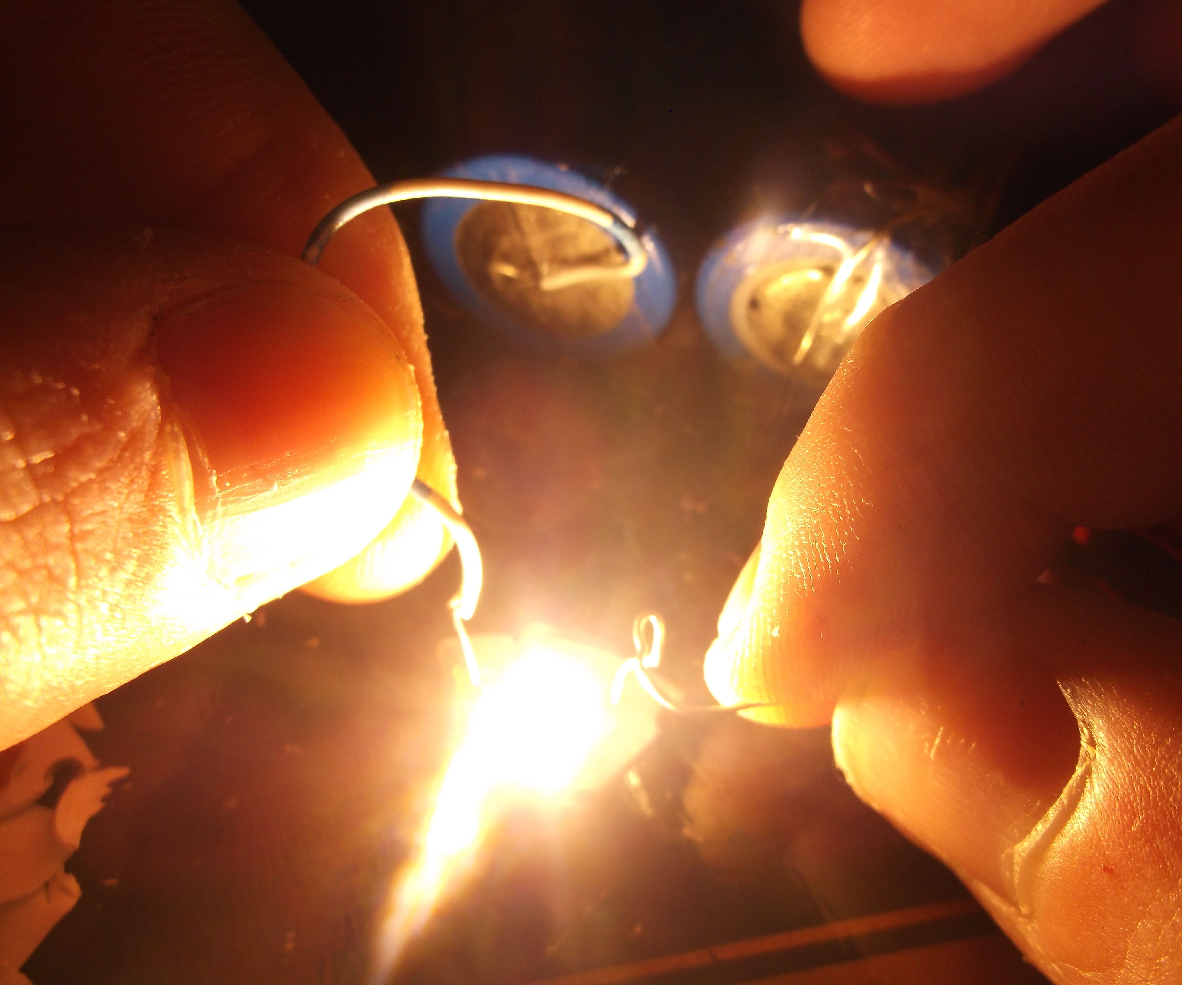

Step 3: Start Meltin'
Just before you start burning things, Practice Makes Perfect, so if you can, practice this technique before removing your components on something less important, that you don't intend to keep, for example a capacitor (this is also easier as it only has two wires.)
-- BEFORE --
1). Setting - Make sure the air intake on your blowtorch is set to fully open or, if there isn't one, make sure you don't cover it with your fingers.
2). Distance - The distance between the end of the blow torch and the opposite side of the board to the component should be about 3cm or 1" away from the surface.
3). Position - You need to be able to have the board held, hold the blowtorch and be able to pull with enough force to remove the component from the molten solder. Also make sure your holding the pliers with the gloved hand, not the blowtorch.
-- START --
1). Fire up the torch and set it to about half gas output.
2). Start heating the solder blobs holding the contacts/metal of the needed component slowly, making sure to spread heat across all the solder points by moving the flame in a circular motion.
3). You'll be noticing that the solder blobs are melting and you may get some stray sparks. this is any air or rosin that is in the solder, reaching the surface of the solder and igniting for a less than a second.
4). At this stage you're going to want to start trying to grip the component with the pliers and what you need to do is gently pull on it on one side, and then on the other, wiggling it left and right while still keeping the heat on the solder.
Step 4: POP!
POP! After a bit of this the component should come away clean and mostly free of solder!
